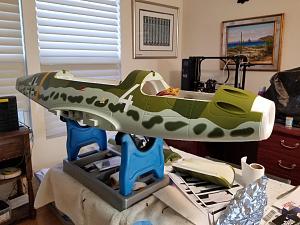

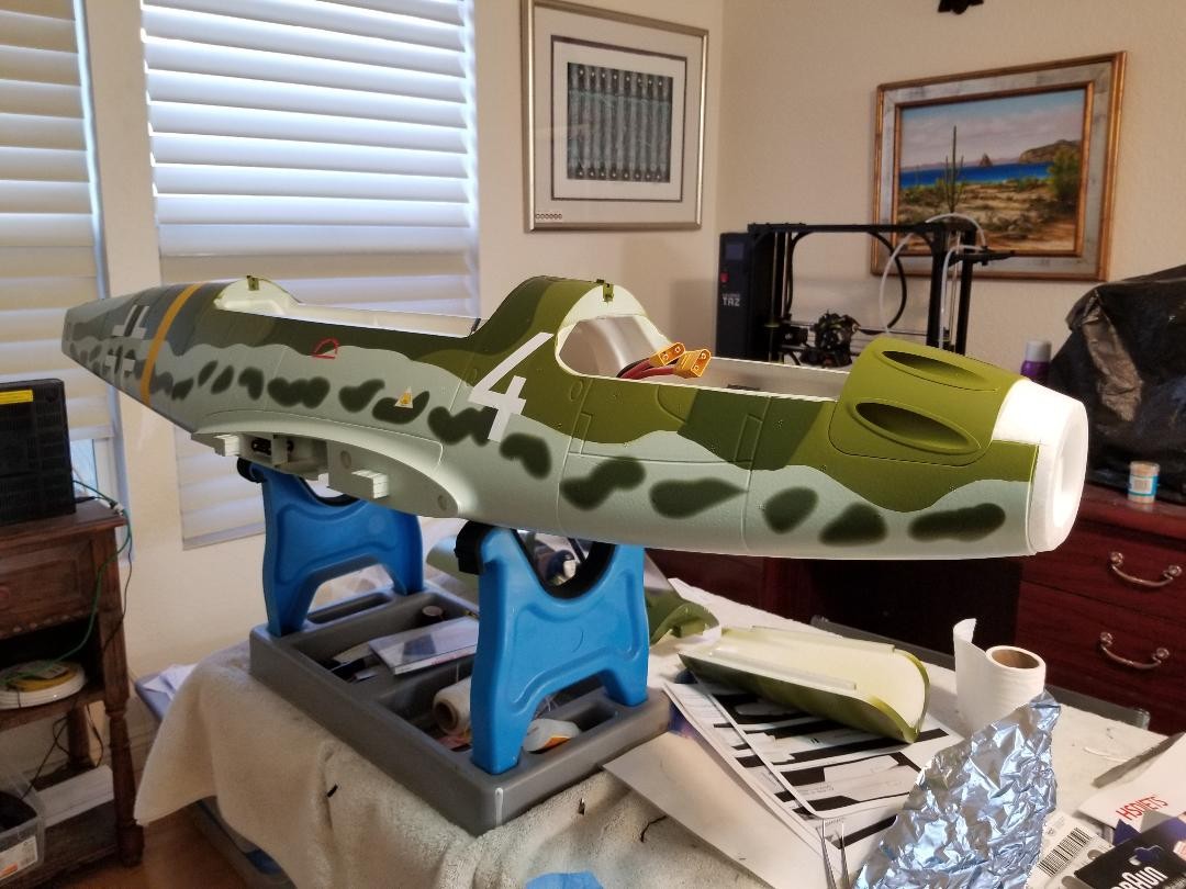

                          Thank you sir, glad to see you got ME262 anyway . I think it's a winner of a plane.

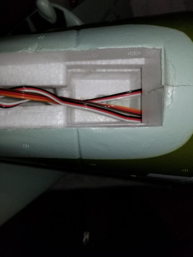

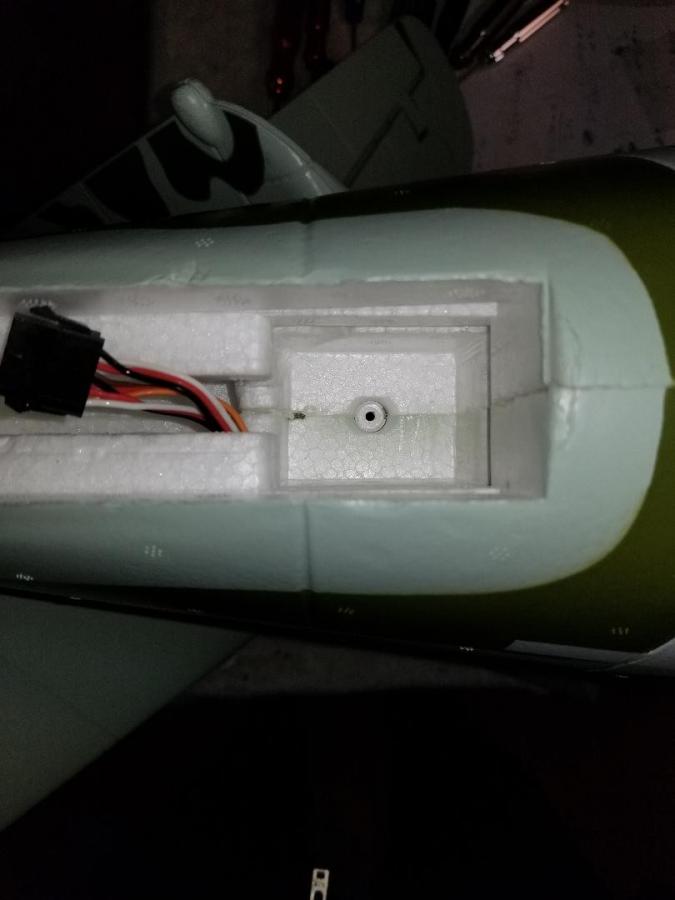

                                      OK, I put this together today. A few things worth noting
                                      0. Yes, it is ugly. It better have a heck of a personality.
                                      1. When you insert the tail, you have to be careful to move the wires into a channel around the side of the front block (see photos). There is NO room for the wires if you don’t do that, and you will stress and possibly break them. I used scotch tape to hold the wires in place while inserting the tail.
                                      2. When inserting the main spar, there is a similar issue – if you just jam it in, it will likely hang up on wires. I used a dowel to hold the wires out of the way.
                                      3. I had some problem and thought I would “factory reset” the MFC-2085 controller. DO NOT DO THAT! It comes with a lot of programming already set up for this model, and it took me half a day to get everything set up again.
                                      4. The throttle was backwards on my spectrum Rx. So I think 2ms is low throttle for these ESCs. That almost led to a runaway crash when I went outside to center the nosewheel, but fortunately I was able to catch it. It did blast the foam hatch about 30 yards down the street.
                                      5. As I mentioned, it comes with XT-90s. I replaced these rather that getting an adapter, so that I wouldn’t introduce an extra connector. But after I was all done replacing them, I noticed that the wire goes to another XT-90 in the belly of the plane. So it already has an extra connector, and it would have been much easier to disconnect it there and remove the entire extension, rather than to soldering two connectors on wires hanging out of the plane.
ID:	290938Click image for larger version
