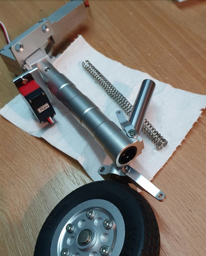

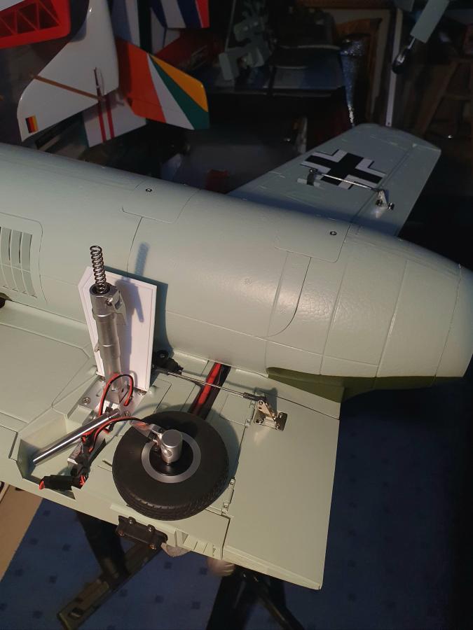

            easy disassembly of the front leg
            the sticky oil at the spring makes it stiff
            overall nice quality😀

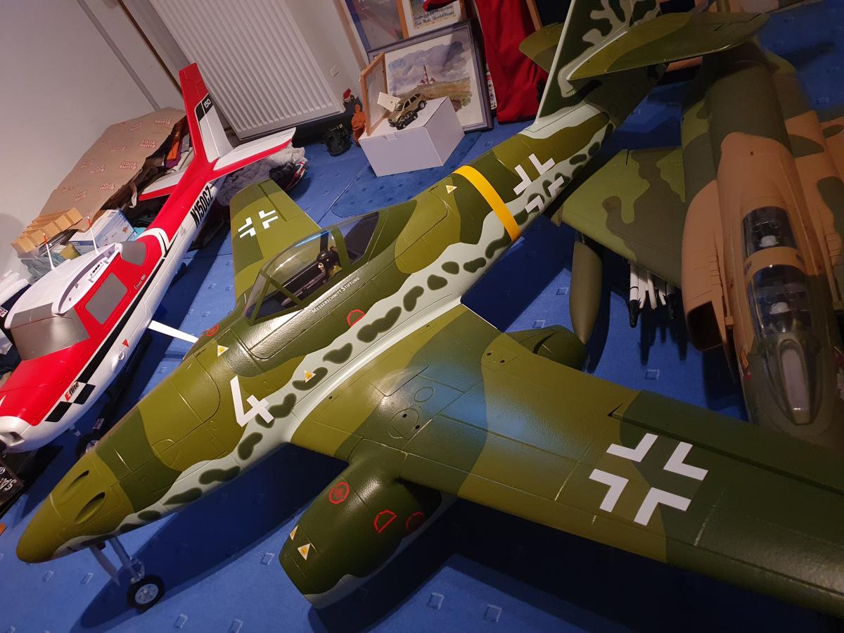

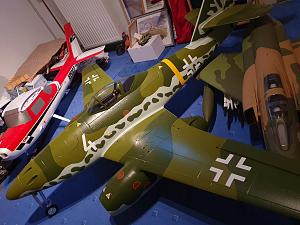

ID:	292770Click image for larger version
ID:	292769 here are some pics ​quite impressive seize🤩

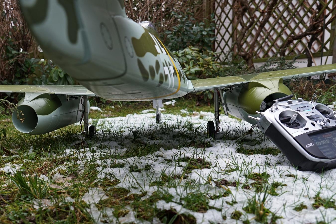

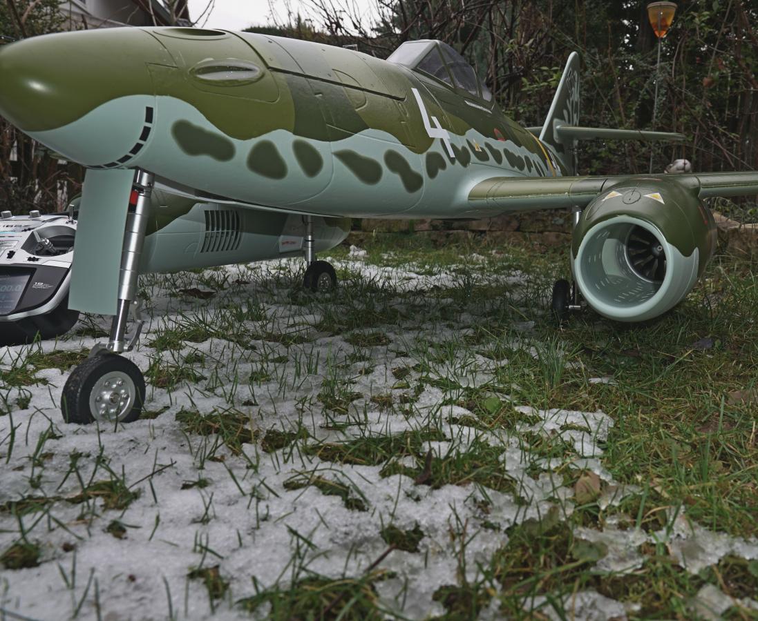

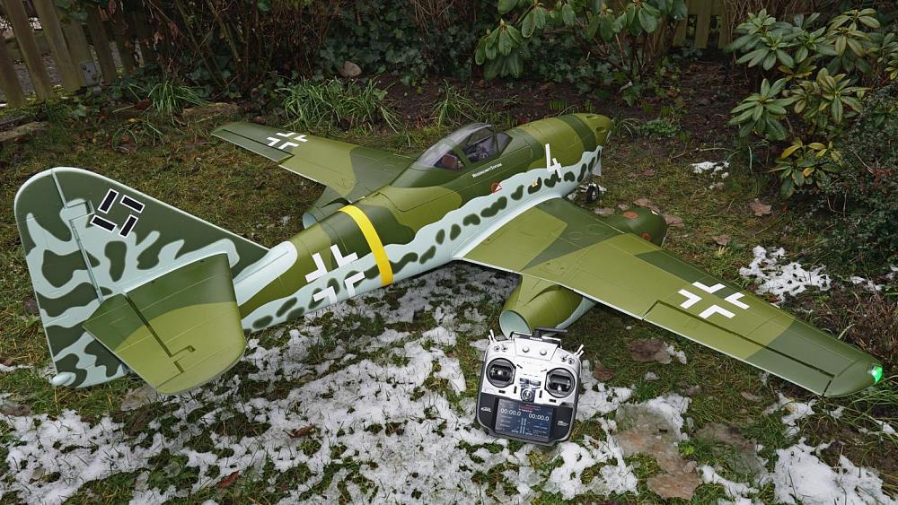

                    oh I am so glad that Sean had a good maiden

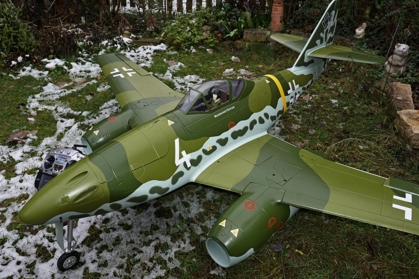

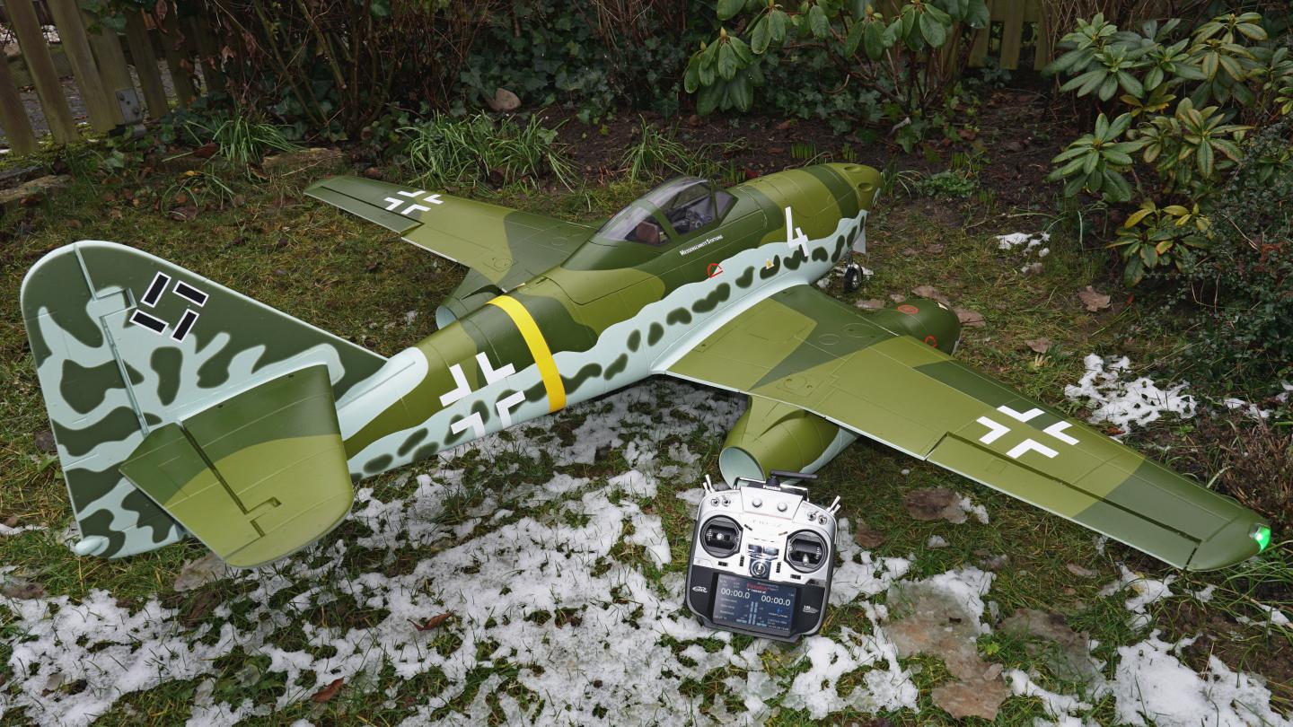

                    here are my roll-out pics of today
                    we got today some snow in Germany and I used used it for a beautiful background

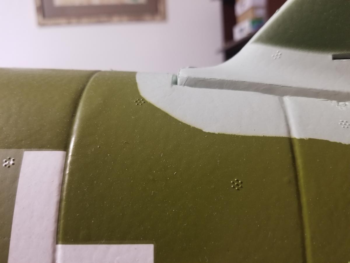

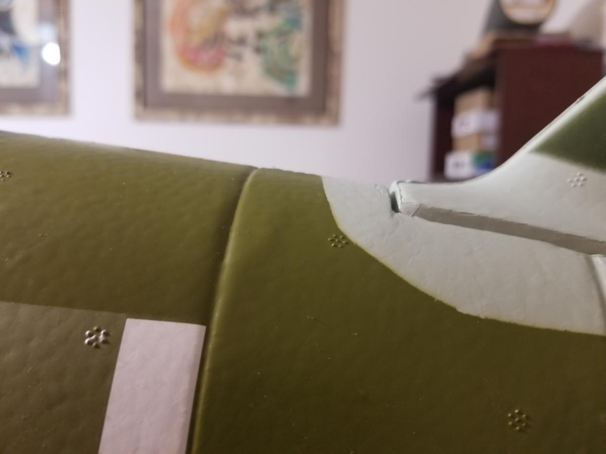

                              I finally re-maidened this after many changes. Two biggest changes:
                              1. I set up high rate throws by the manual, with low throws about 80% of the manual. The first time, I had the ailerons way too high. No reason, I just screwed up.
                              2. I noticed the front of the empennage seemed high, which would pitch the h-stab down, and require strong up elevator to overcome (my first maiden the thing wanted to dive like crazy…I almost plowed into the ground many times). So I removed the two screws, made sure there was nothing binding, and just carefully put it back in there. I think it sits more flush (see two photos). Maybe there is only a mm of difference or less, but that is a lot when it tilts the entire h-stab. So the lesson is – be careful to get this fully seated and flush, so you don’t have decalage problems.
                              With these changes it was awesome! It flew great, and landed very easily. It was like night and day vs. my first flight.
                              The only quasi-adventure was that with the decalage corrected, now I had too much up elevator, and the plane took off before it really had enough airspeed. But I kept it at a low angle of attack and at full throttle it quickly got up to safe speed. I guess the lesson there is – it might be good to keep some forward pressure on the stick during takeoff if you don’t yet know your trim, to prevent premature takeoff.
                              Below is a link to a video of the “first maiden.” It was all over the sky, completely crazy:
                              https://youtu.be/A57xjMTkHPM
                              I don’t have a video of today’s re-maiden, but it was quite boring. It flew like on rails, and landed softer than a butterfly with sore feet.
                              So it was a great day, but I also didn’t push it at all. I just flew in an oval at ½ throttle, fine-tuning the trim. I look forward to doing more with this in the future.
                              Two photos - before and after re-seating the empennage. I think it was not quite flush in the first photo, which would angle the h-stab down a tiny bit at the back. In the second photo I still wouldn't say it is flush with the fuse, but the key point is that both mounting posts are correctly seated on the attachment points inside the fuse, which should mean it is straight.

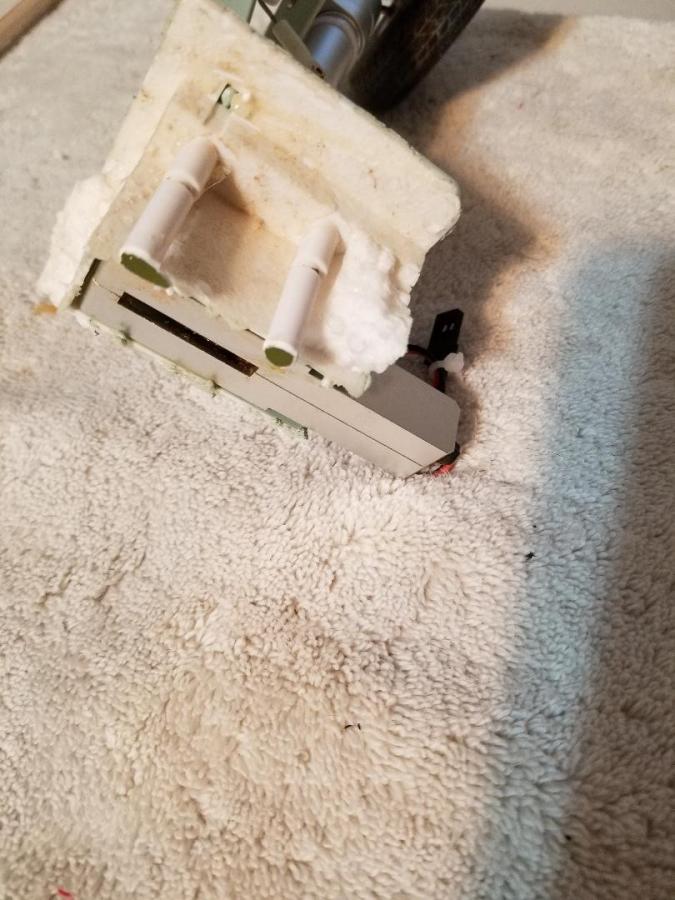

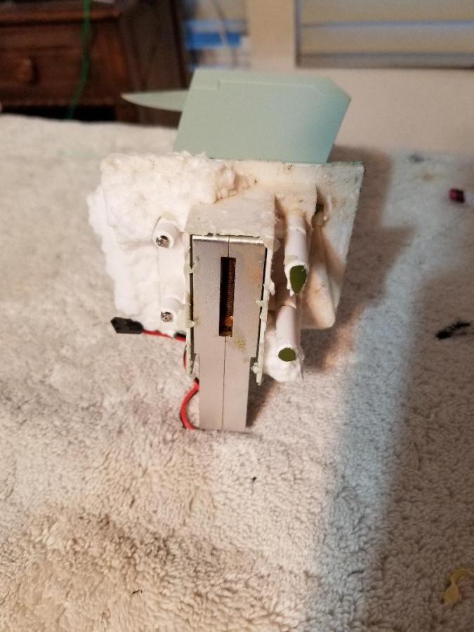

                                        OK, I finally figured out why this plane was so difficult to control. The empennage is secured by two plastic posts with metal inserts, and an M3x10 screw goes into the metal insert. My screw had pulled the insert right out of the post, so the post was free to move up and down. This meant the empennage was not really attached, and could rotate about 5 degrees up and down. That's why I always needed huge elevator trim changes, even in mid-flight.
                                        In retrospect, I’m lucky to still have the plane….the empennage could have just fallen off.
                                        Below are pictures of a normal post + insert, and then the empty post, and the fallen-out insert. I lined the inside of the vacant post with epoxy and pushed the insert back in.
                                        Anyway, I strongly suggest that everyone should be extra careful putting the empennage on. For example the empennage’s front post goes into a foam hole, and it is a pretty tight fit. I thought the screw would pull the post into the hole, but apparently what happened instead is that the screw pulled the insert out.
