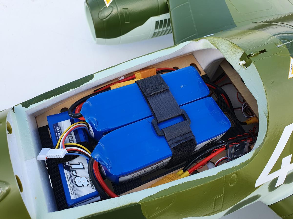

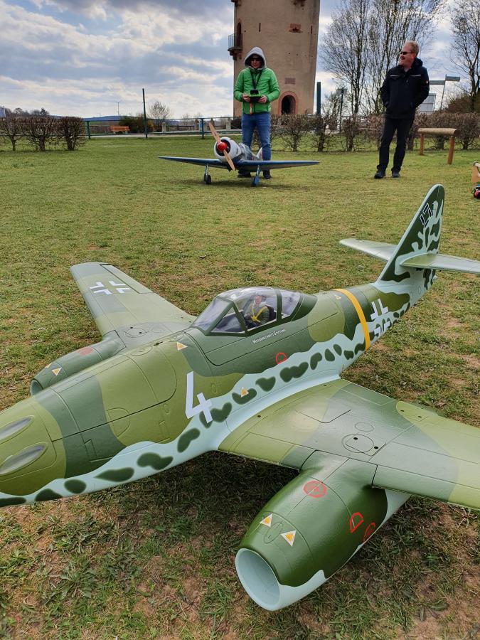

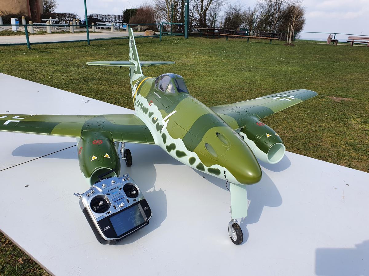

      maidened my ME-262 today....
      yes she behaved quite predictable and stable
      my impressions she flies more than FW Avanti than FW Phantom both 6s
      I set up as per factory and manual specifications
      For 1st flight of 3:30 min both Fans took only 2.6Ah
      uses 2x2s 1.8 in the front and 2x6s 5.0 25C w/700gr. each behind
      I am happy with it
      Harald
      will try upload videos but struggle with seize

              i use 2 nos. identical 2s 1.8 Ah for control
              there are stacked one on the other

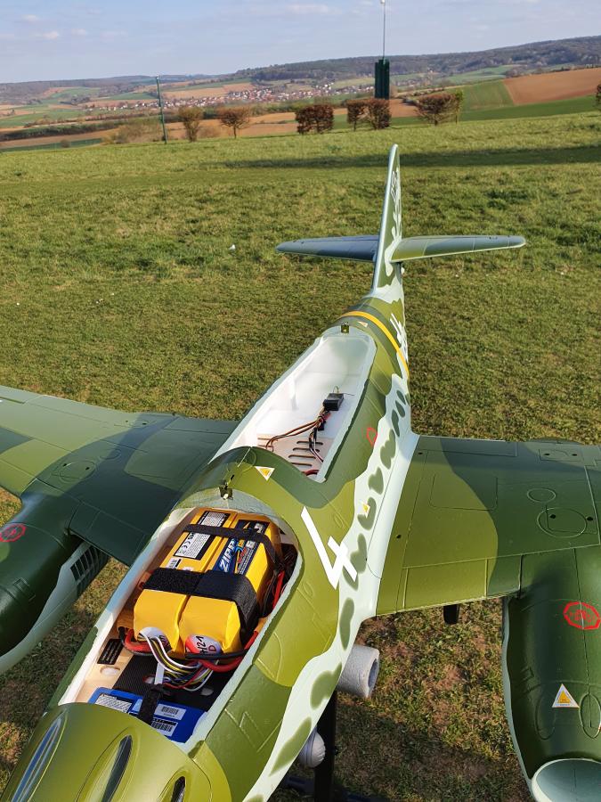

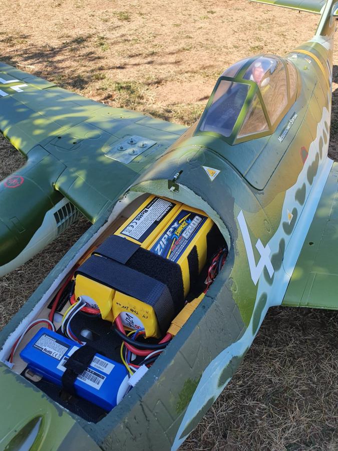

                I had today my flights 2, 3 and 4
                could improve flight time to 5 to 6 minutes with new zippys 6.2, weight of 890grams each, no issue
                rolls, Immelmann and loops are great, 1st try on edge knife
                landings with full flaps and brakes are fine
                will only empty the sticky oil in the legs
                as they harden far too much at temperatures of 10 degC
                btw I could not change the position lights from permanent to flashing or remote switchable, any advise?
                I replaced the pilot to a veteran of WW2 from cellar found

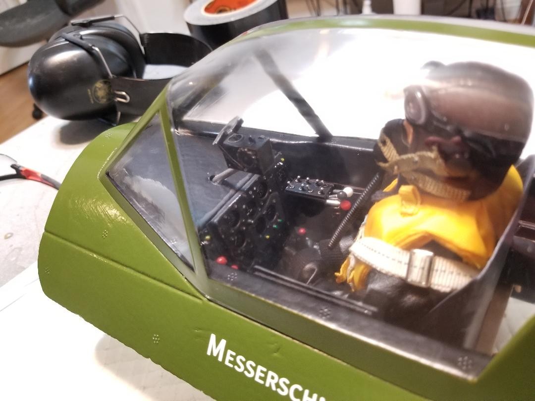

                  I added some scale parts and cockpit. The pilot is from Warbird Pilots and has the servo-actuated head. The gunsight and various other cockpit pieces are 3d printed in resin.

                    Looks cool, Where did you get the3d files for the cockpit and revi gunsight? I am remodeling mine to a JAAF Ki-201 with Camo scheme.

                      The main part of the cockpit is from an ESM SBD dauntless. A couple smaller subpanels, the gunsight, and the RDF antenna I made in Fusion 360. I posted STLs of the antenna and the gunsight:
                      https://www.thingiverse.com/thing:4853284
                      https://www.thingiverse.com/thing:4839402
                      The gunsight has a flaw that I might get around to fixing this weekend....I didn't leave room for the glass, so you can see on my plane the glass is on the outside of the frame (that was not my original plan, but I was too lazy to fix the design and re-print it).
                      Do you have a resin printer? I don't know if these would print well on FDM. Anyway, I see you are in San Diego, if you want any of these little pieces I could print them for you.

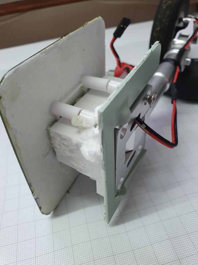

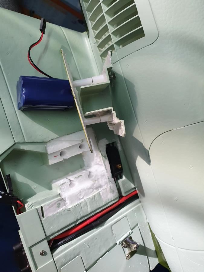

                          need for strengthening the landing gear
                          after 15 flights the plastic bolts cant withstand the landing forces
                          despite no hard landings on grass and shortening the springs the plastic design glued to the foam is not capable to guide the forces permanently to the upper wing

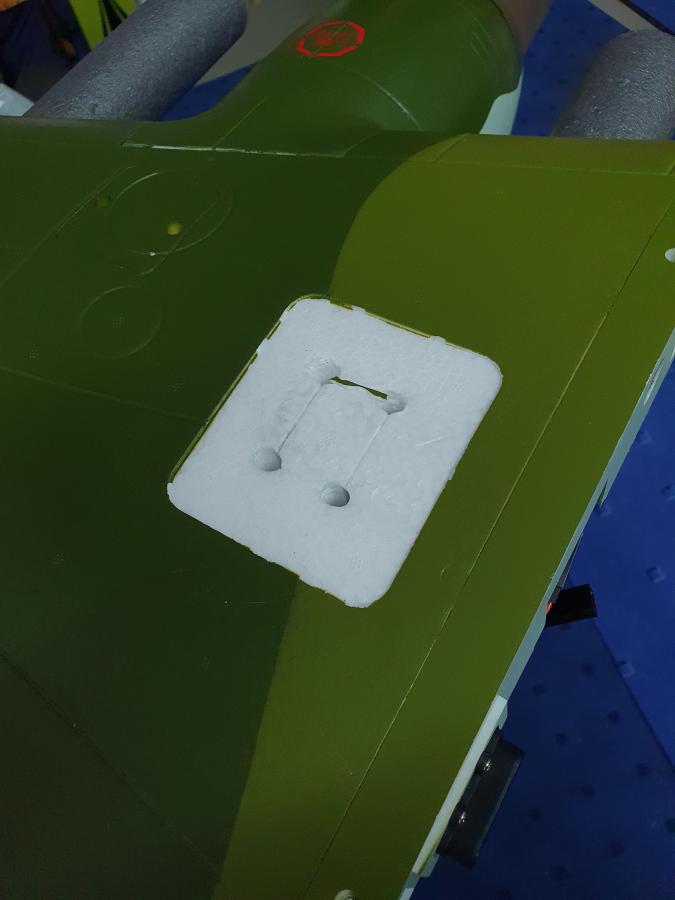

                            I notice the same weakness. My first one, I landed hard and the gear punched out the top of the wing, just like yours. The second one, I have had zero hard landings, but still I see a slight bulge there.
                            On my first one, it was an easy repair. I glued it back and put two small carbon rods in to reinforce. I don't have a picture and am out of town so I can't take one, but I indicate what I mean by drawing on your photo. The orange arrows indicate the direction I inserted the rods, and the blue lines are the approximate position of the rods. I drilled it with about 3/32 bit, then pushed in a carbon fiber rod covered with epoxy. Of course before that I had already epoxied all the pieces back together (the cover that goes on top of the wing, etc.). I thought these two rods should add a lot of strength if they touch the plastic posts and then continue horizontally into the wing.

                              thanks for good idea
                              I will consider carbon fibre rods:muscle:

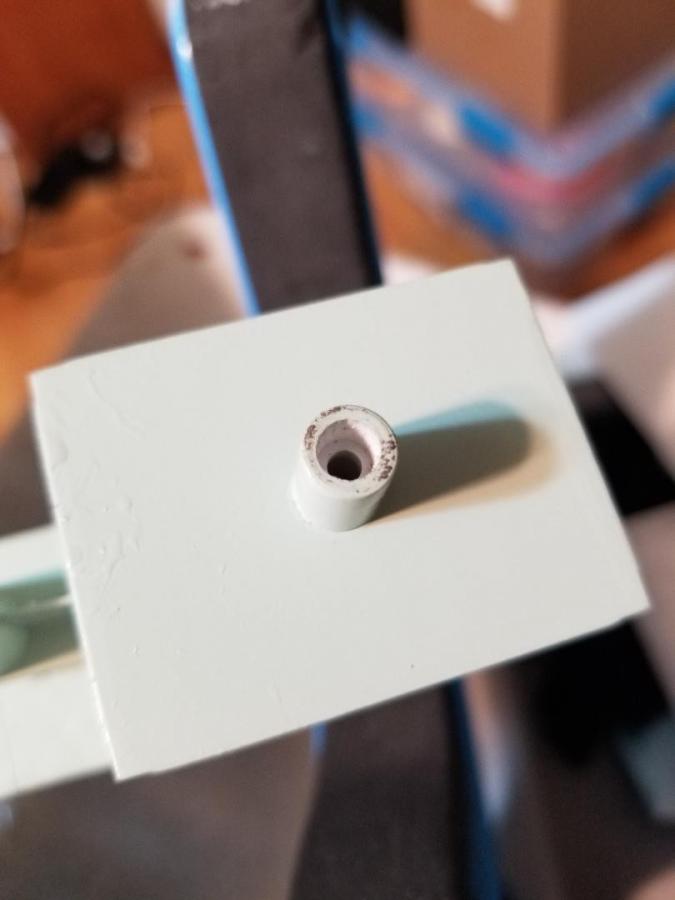

                                Originally posted by Gringotuerto

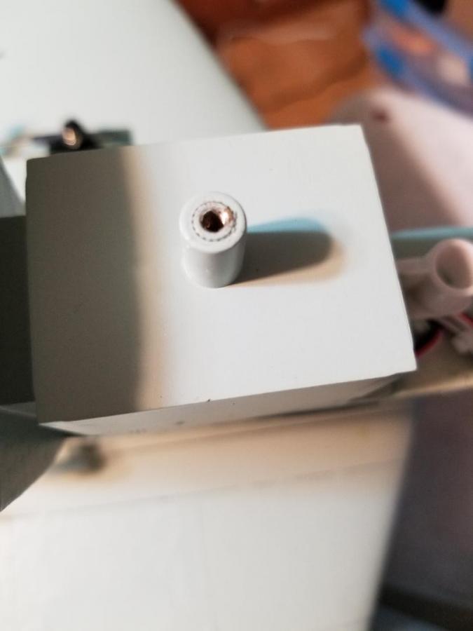

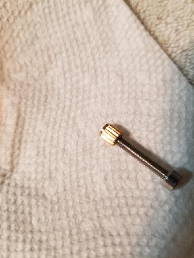

                                OK, I finally figured out why this plane was so difficult to control. The empennage is secured by two plastic posts with metal inserts, and an M3x10 screw goes into the metal insert. My screw had pulled the insert right out of the post, so the post was free to move up and down. This meant the empennage was not really attached, and could rotate about 5 degrees up and down. That's why I always needed huge elevator trim changes, even in mid-flight.
                                In retrospect, I’m lucky to still have the plane….the empennage could have just fallen off.
                                Below are pictures of a normal post + insert, and then the empty post, and the fallen-out insert. I lined the inside of the vacant post with epoxy and pushed the insert back in.
                                Anyway, I strongly suggest that everyone should be extra careful putting the empennage on. For example the empennage’s front post goes into a foam hole, and it is a pretty tight fit. I thought the screw would pull the post into the hole, but apparently what happened instead is that the screw pulled the insert out.

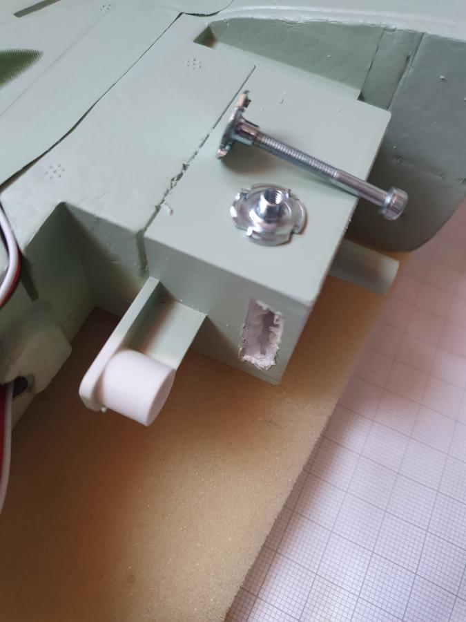

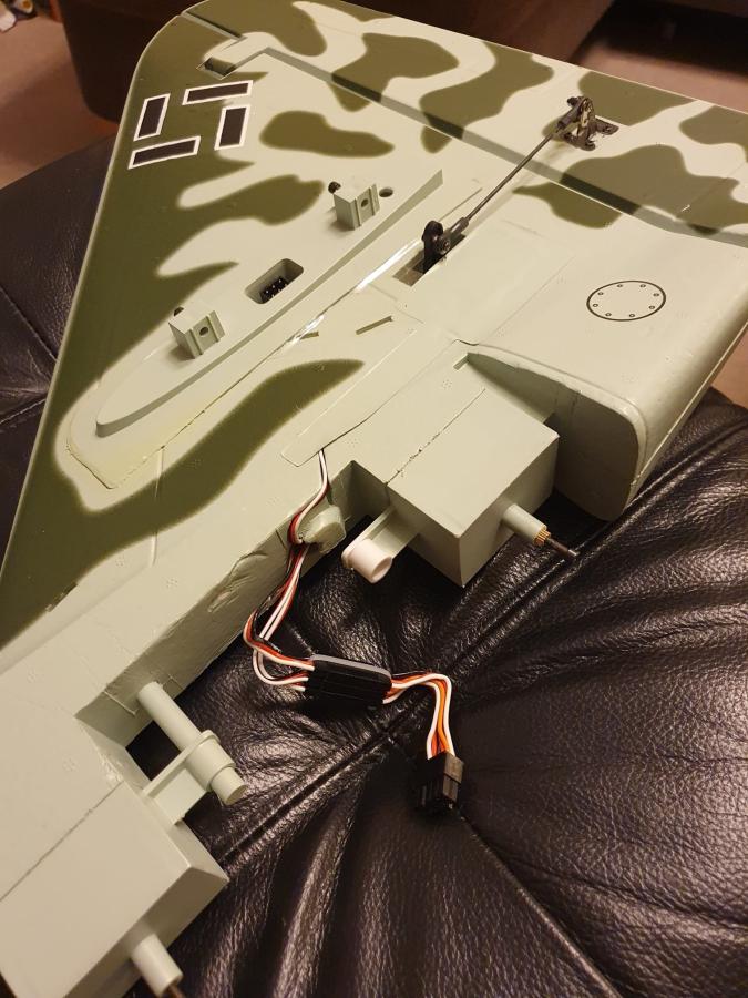

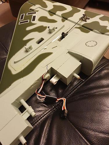

                                this is very important detail
                                and has probably resulted in my 1st. crash:triumph::triumph:
                                the rudder and the elevators are secured by 2 nos. M3 screws, but the little insert made of brass is just pressed inside the plastic tube, see pic :poop:
                                I will change this to a solid nut with big washer for pull relief on top of the plastic tube, same I did on the main gears

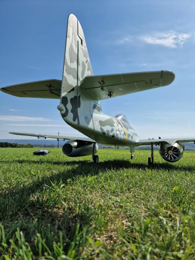

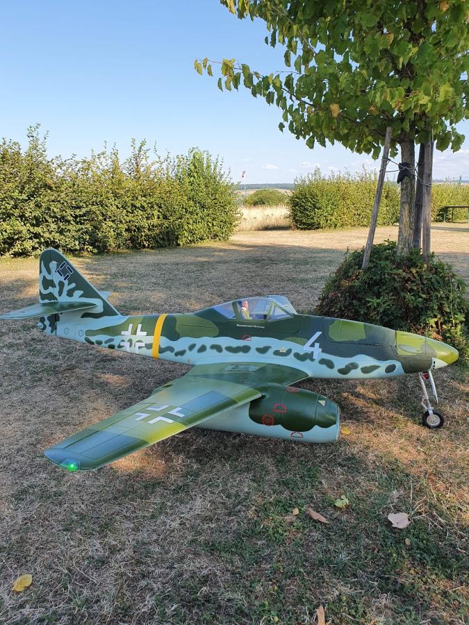

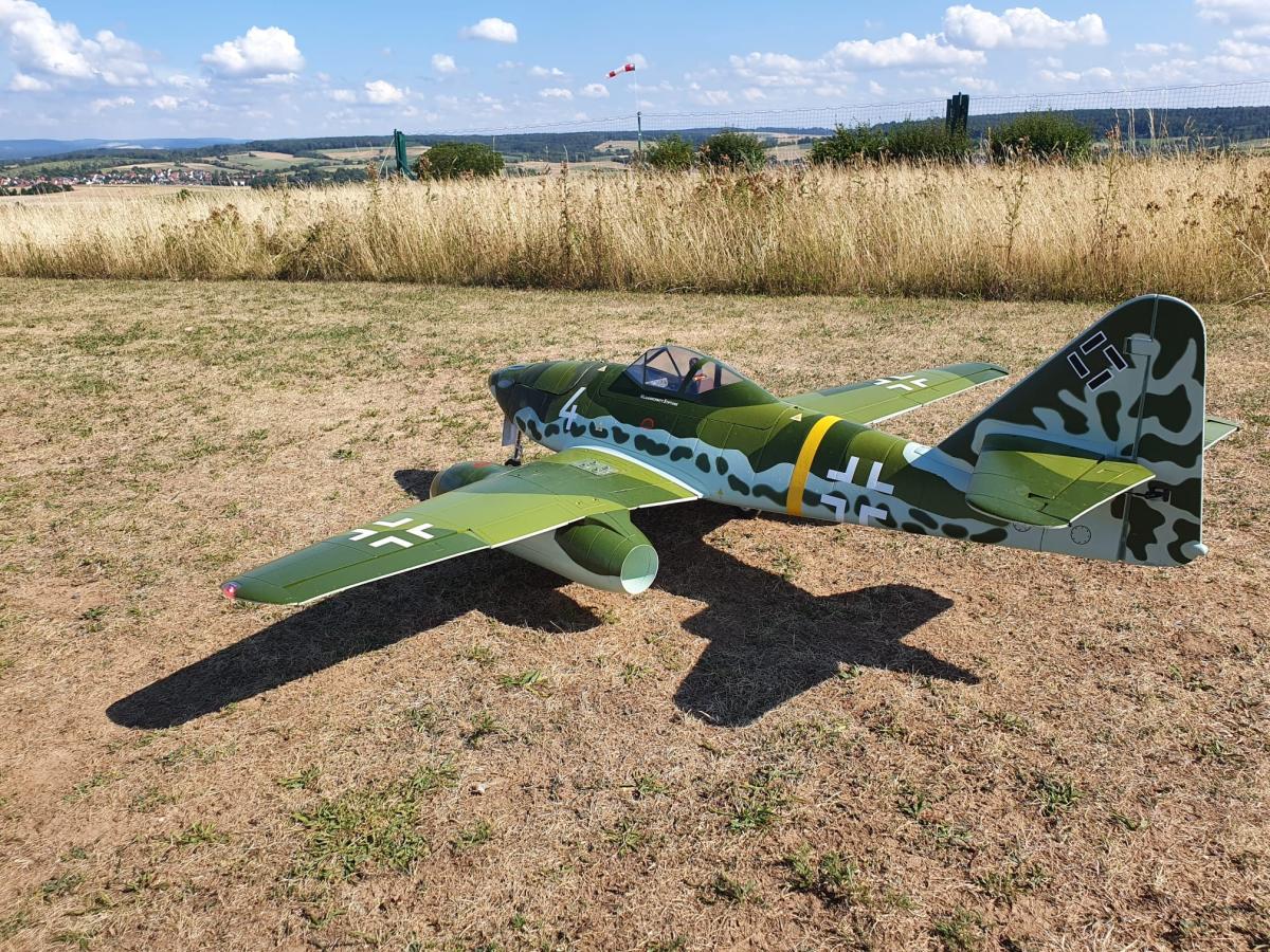

                                          had a 10 minutes flight, consumption 5Ah, only Click image for larger version
