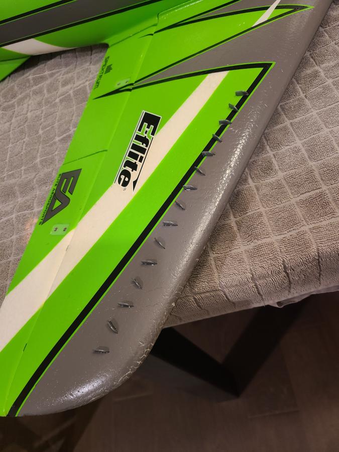

                                      #38
                                      Added vortex generators to wing to improve low speed handling
