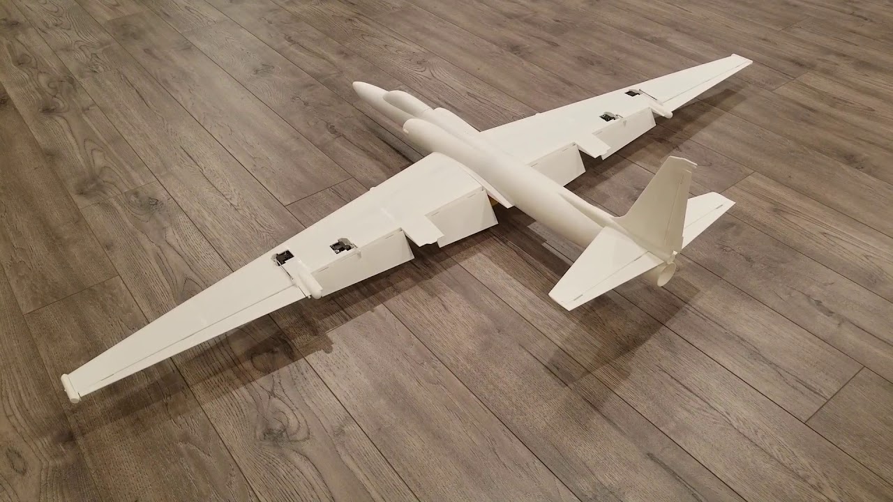

                          All rigged up and wired up. Just need to set low/mid/high rates and double check CG balance with the 1800mAH packs. I will be mounting a Mobius camera for some in-flight footage so I'll need to take that into account as well.
                          Final weights with everything now is 1147g AUW without the super pods. With the super pods added, it is 1228g (81g more)
                          Holding this is my hand to get a feel for a hand toss, I am very much considering a dolly for the maiden. 1.1kg doesnt sound like much, but it definitely has some heft when it is held in one hand.

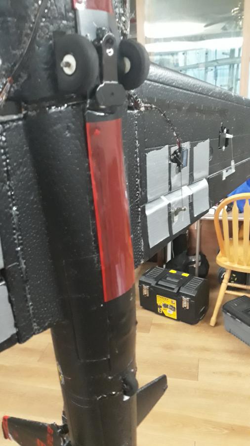

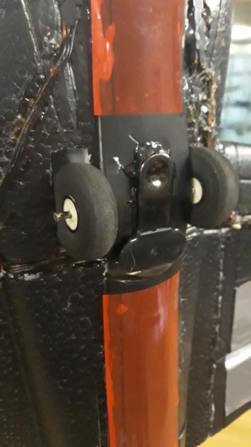

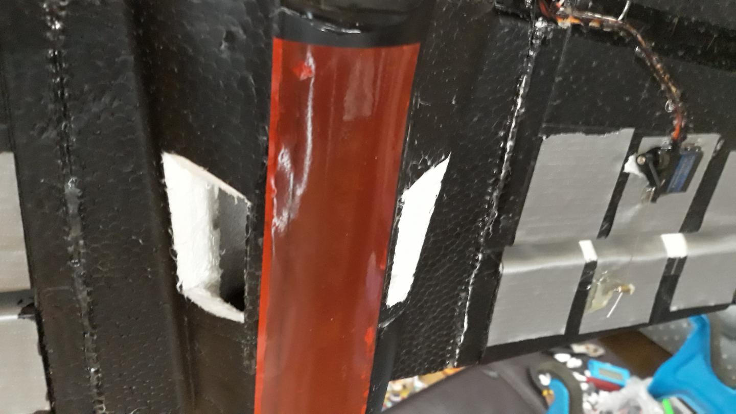

                                        Ok DD,
                                        Here's the specs, it has a 40amp ESC and a 480 sized 960kv motor with a 64mm 6 bladed fan, all stock setup.
                                        Freshly charge battery for both tests 12.6v CHNL 3S 2200MAH 40C 80C Burst
                                        No cheater holes=33.94amps, voltage sag under load 11.38v 387.5w, 0.024ah use. So the stock setup still makes more power than your setup.
                                        With cheater holes =39.52amps, voltage sag under load 11.37v 455.6w 0.032ah used
                                        So cheater holes? Heck yeah! I don't have any thrust numbers but 68 more watts!
                                        I don't remember how far back your fan is mounted in your fuselage, mine is mounted just behind my wings. So I actually don't have as far from the intakes and I thought, and still gained 68watts with the cheater holes.
                                        39.52 amps maxes out the ESC on 3s so 4s is out of the question without upgrading the power system.
                                        Hope this helps, attaching pictures of the wheel mod and the newly cut cheater holes.
