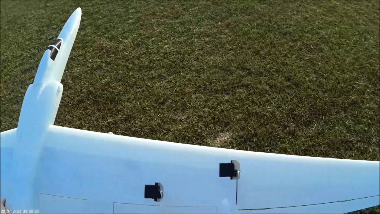

      Finally got around to another round of tests with 100% FSA exhaust and enlarged intake cheater. Overall, improvements were relatively minor, with 600g of thrust at 618W compared to 590g at 596W. 10 grams of increased thrust with the changes.
      Earlier this week I quickly went out to confirm ease to hand-toss. below is a short video from the first of the 2 flights. I forgot to write down notes from the maiden, so I was re-learning a bit with what rates I had set for ailerons, rudder, and elevator. The plane felt a bit snappier than before when banking using ailerons with a bit of rudder, so I brought it down pretty quickly in the video. Besides, this, the plane takes off from an underhand toss pretty easily.
