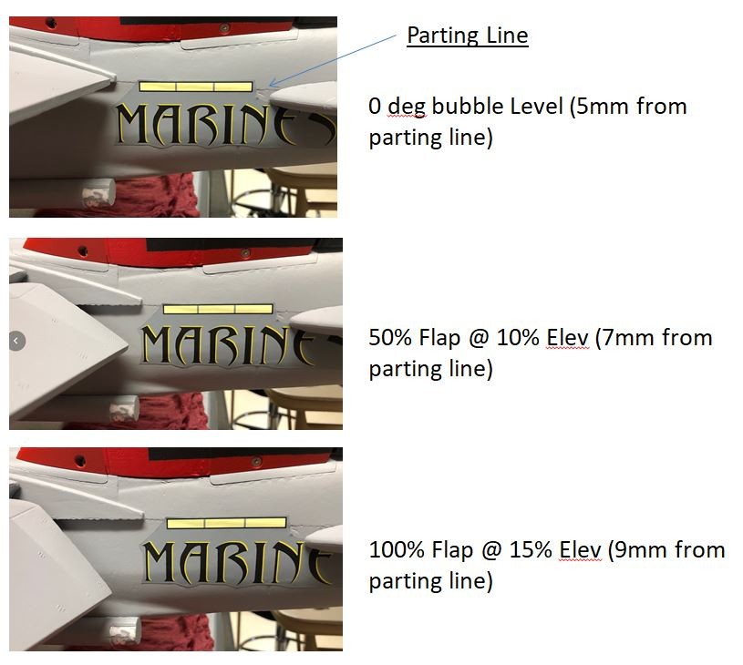

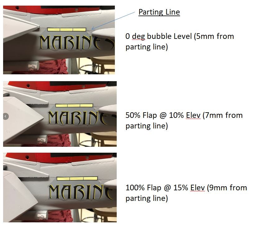

    Also wanted to verify Flap to Elevator travel. Many on RCG have stated they are setting Elev at 5mm from Neutral. Is the parting line the neutral point? I put a bubble level on my Elev and it is exactly 5mm from the parting line? Is everyone adding an additional 5mm or would my setup be correct?
    Click image for larger version  Name:	Flap.JPG Views:	0 Size:	95.1 KB ID:	260119
