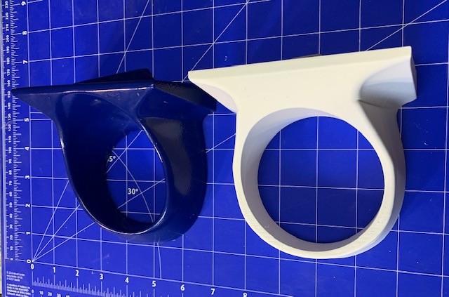

I've installed a 100mm Wemotec fan unit now, HET 700-75-1070 motor. 5,9kg AUW, 2x6s HRB 5000 Lipos, 6,5 min flight times. It required a new 3d printed tail part to achieve the necessary 85mm exhaust diameter.
