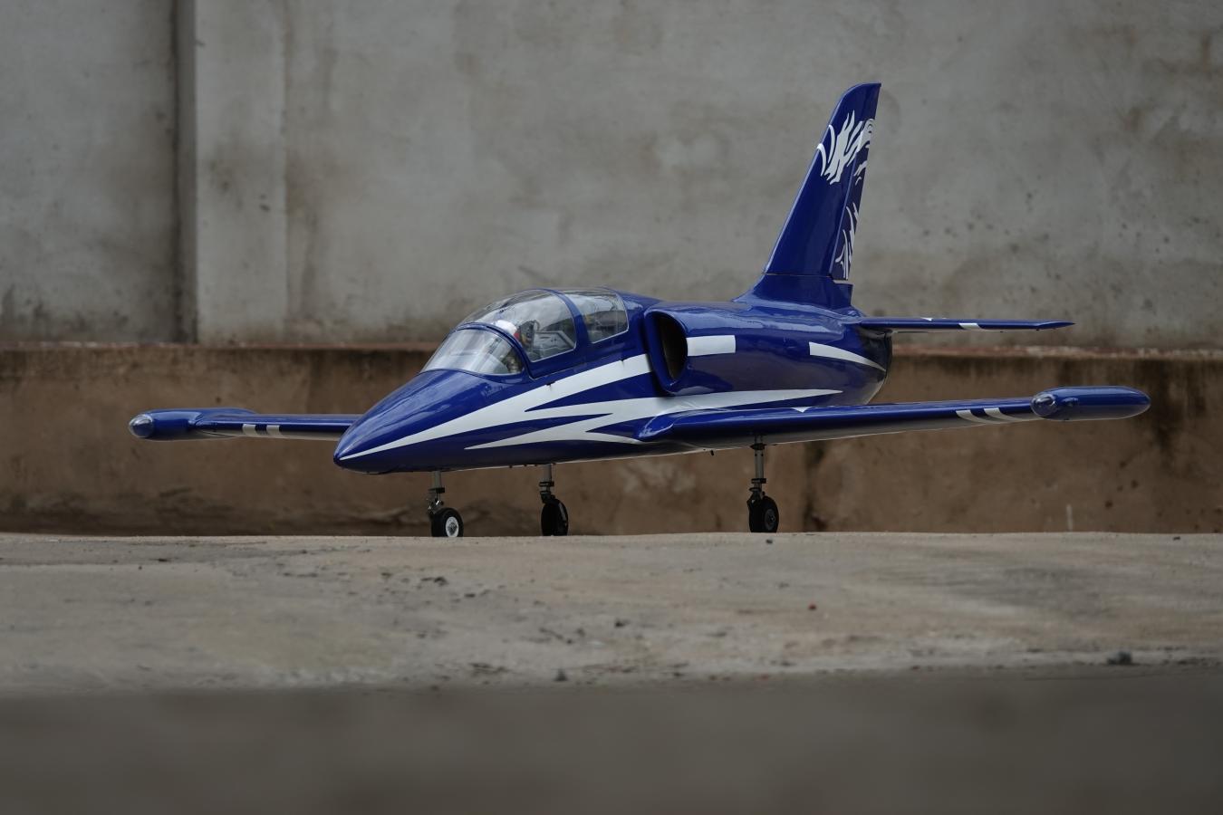

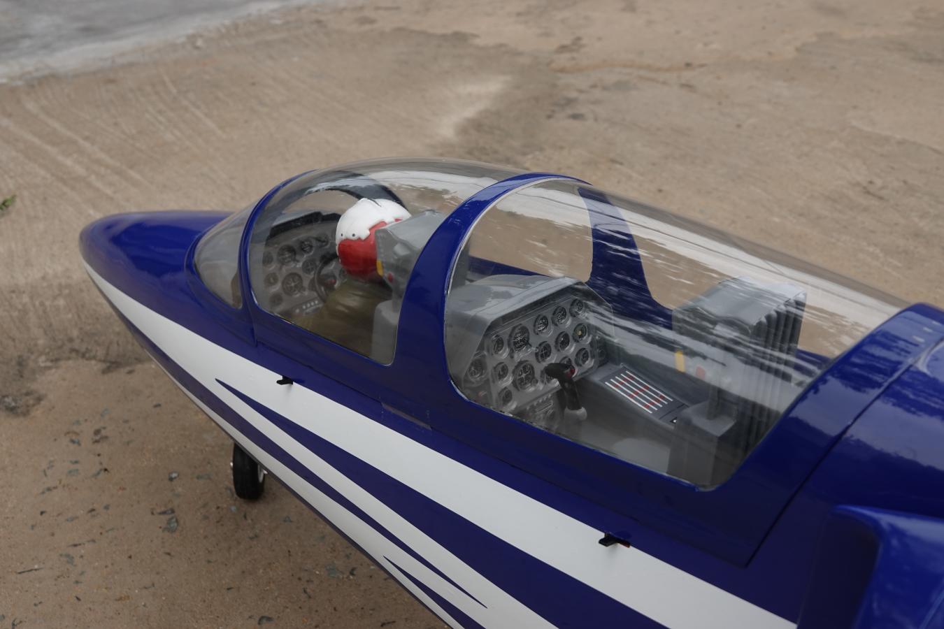

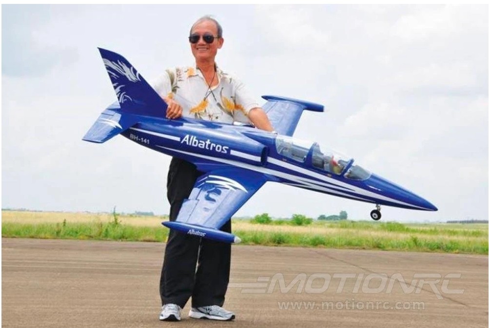

                Here are a few extra photos I took of Black Horse's L-39. Deceptively quick and some of you are right, it's a worthy candidate for turbine conversion. In fact subscribe to this thread for more news on that front.

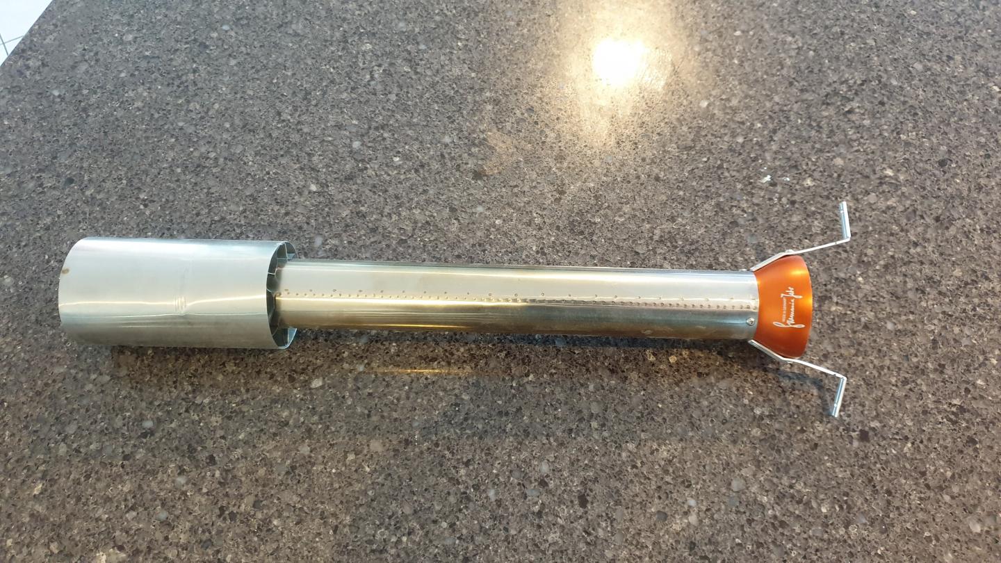

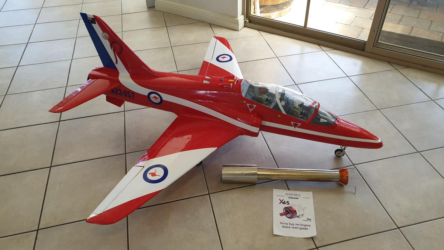

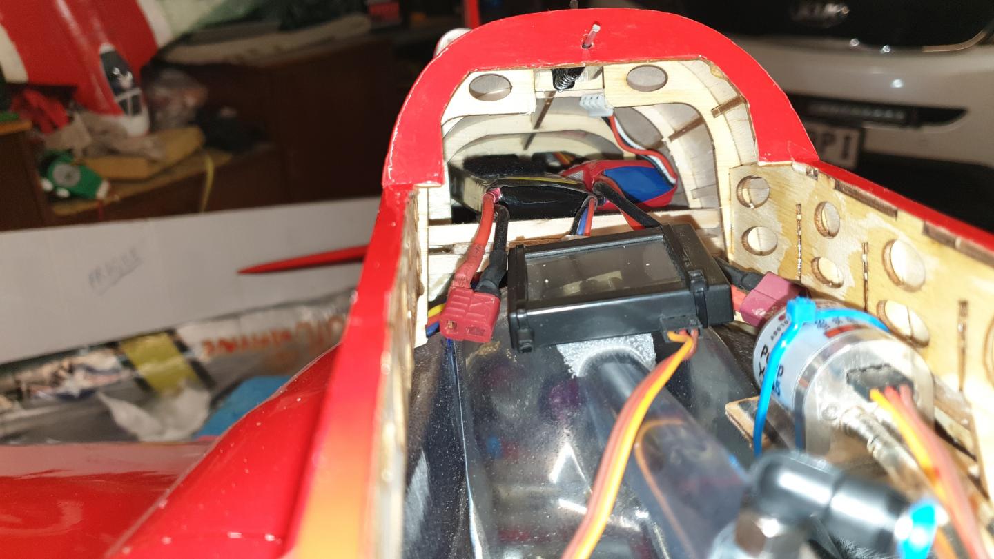

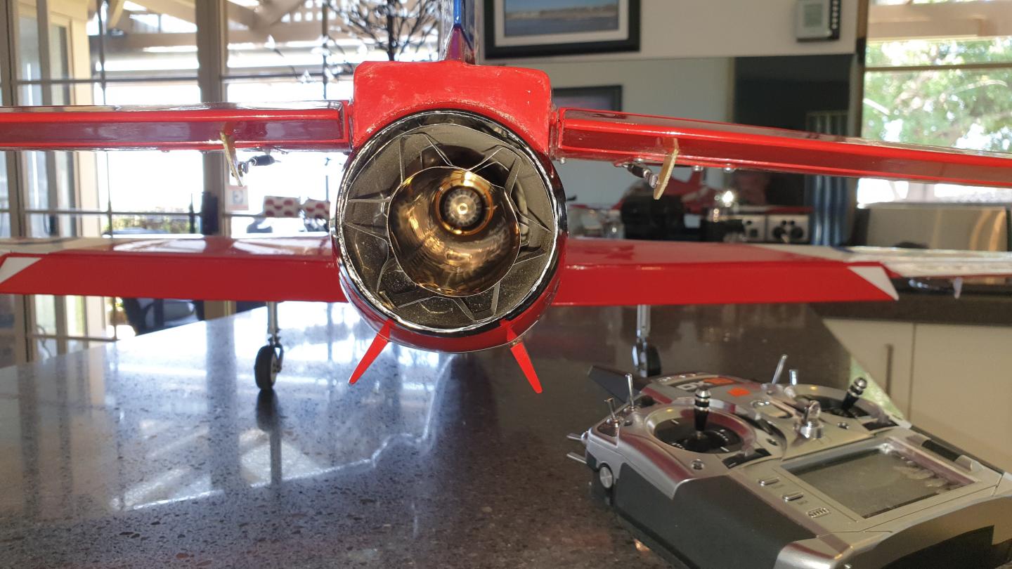

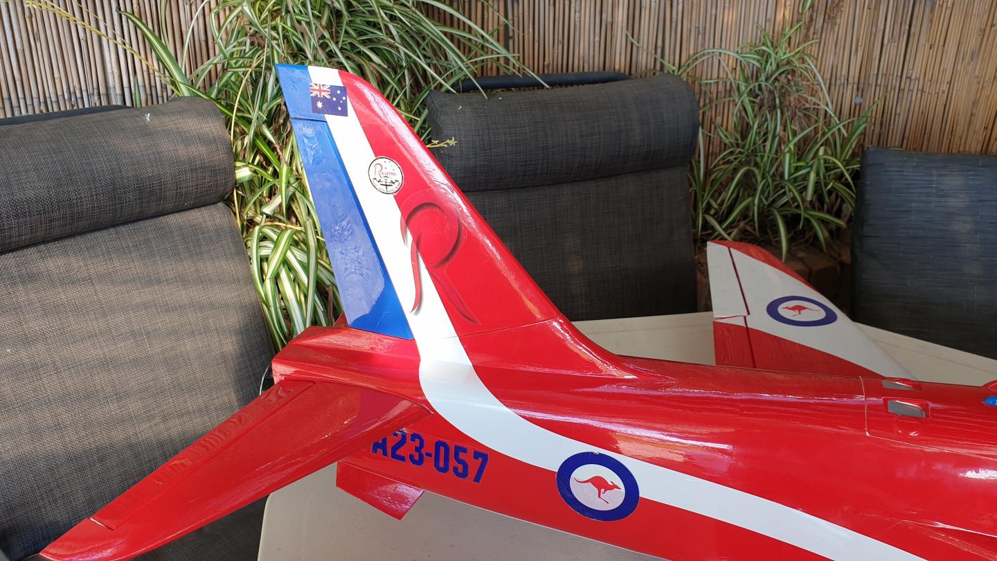

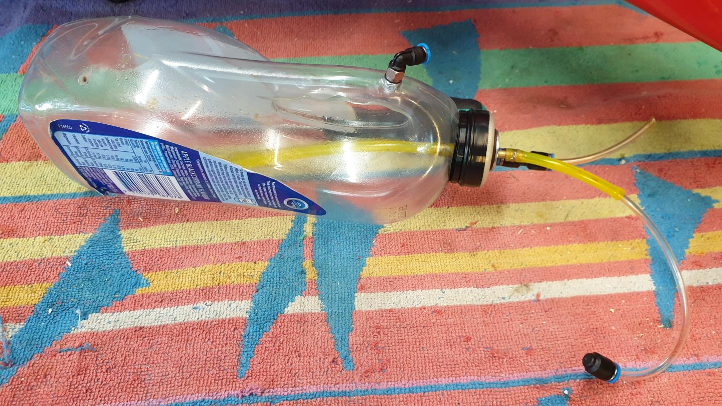

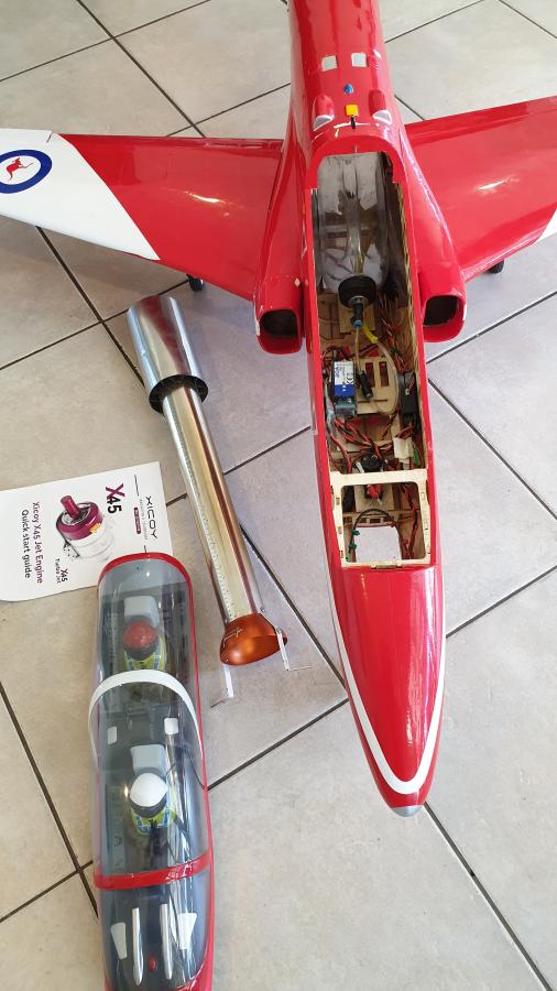

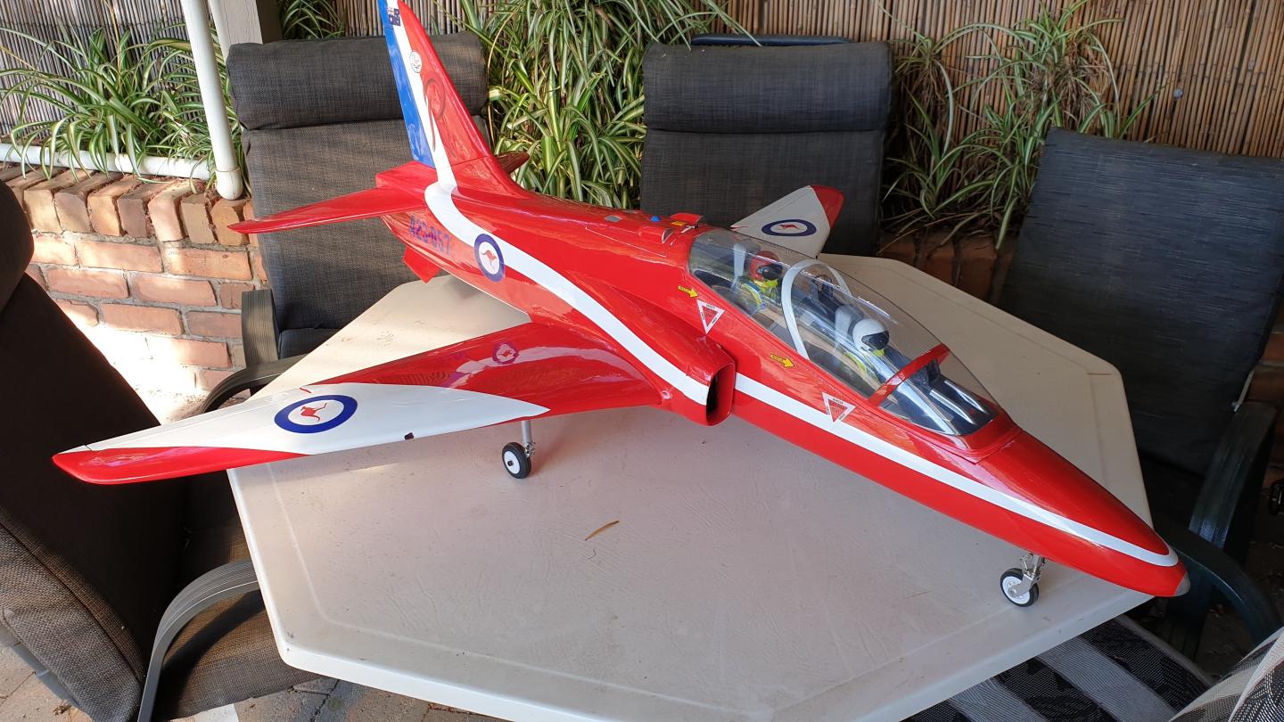

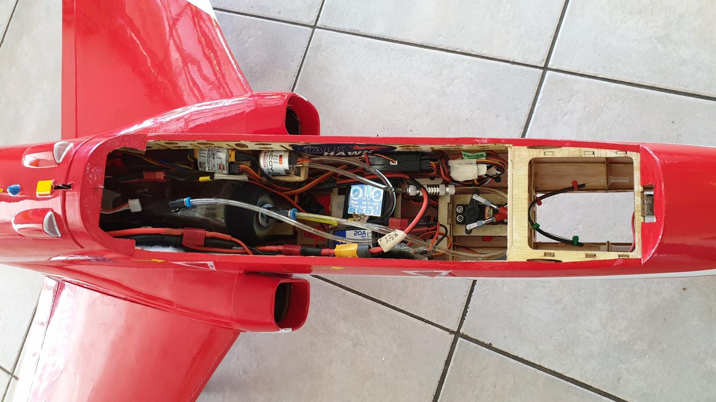

                              Alpha, this jet looks terrific! I have a Phoenix Models Hawk that is very similar in size and weight to the L39, and the construction method of laser cut ply and balsa sheeting appears to be similar too. Most of my jets with a turbine are either foam or composite and with my favourite engine, the tiny X45, this will power a jet from 3-6kgs, so this gives any potential small jet conversion a huge range of models to choose from. What really stood out for me about these ply/balsa jets is how strong and light they are! If I hadn't bought my Hawk, this would probably be on my Christmas list, plus it would be good if Motion made available a turbine conversion kit. These pics show my Hawk just to give a idea of how easy it is to convert a good quality 90mm EDF jet to turbine.
