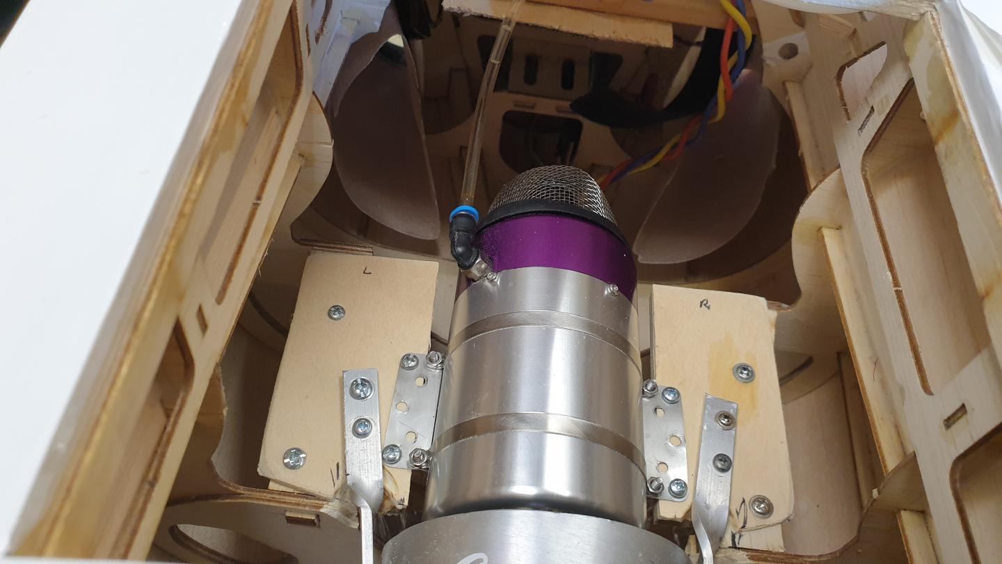

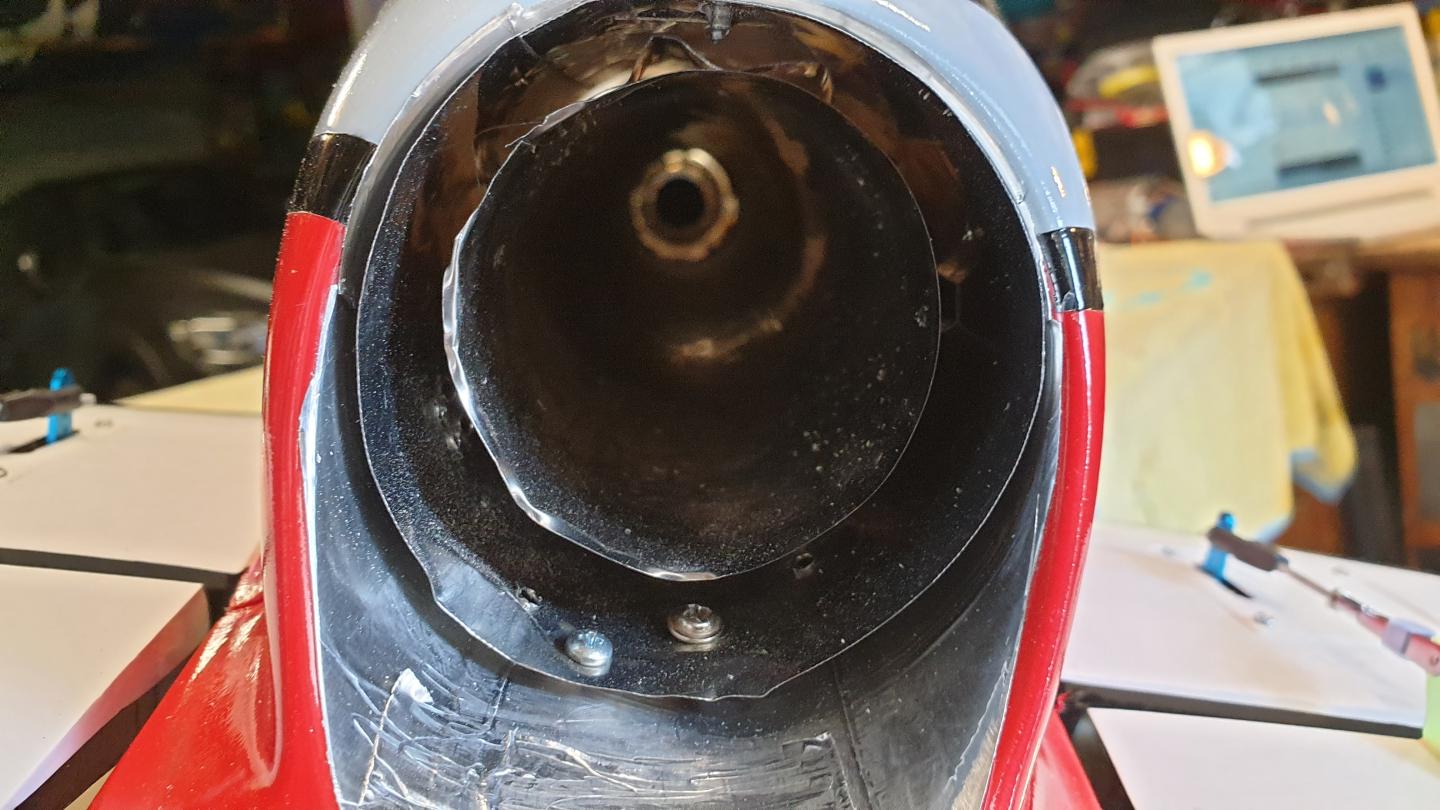

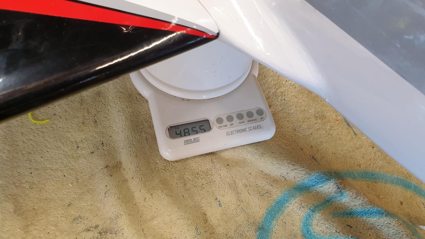

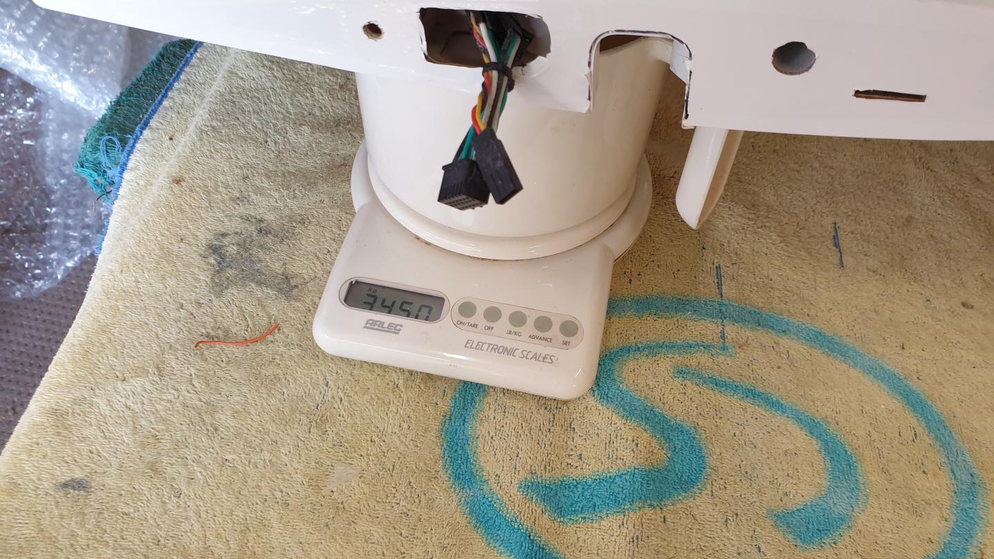

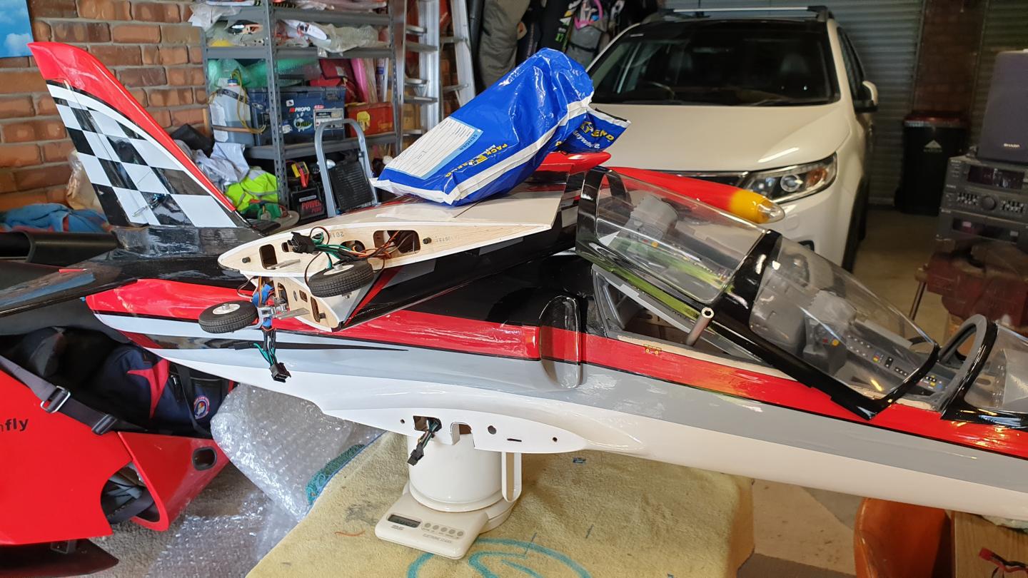

      I measured 10cms between the edges of the EDF Mount. I have already installed my radio gear, Unilights and landing gear and its showing about 3.6kgs. I'm installing a X45 turbine and a single walled pipe so about another 800 grams including pipe and tank to go in, plus 900 grams of fuel. The X45 is equal to a hot 12s setup, so I'm expecting reasonable performance, and this jet has flown with a Kolibri 35, and a 90mm EDF, so will be interesting to see how it goes with a 45!! Click image for larger version

        Thanks a TON! This is a huge help!!! Can you tell me what altitude you are at?
        Again this was a big help and it's really appreciated.

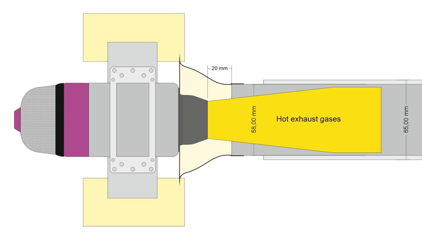

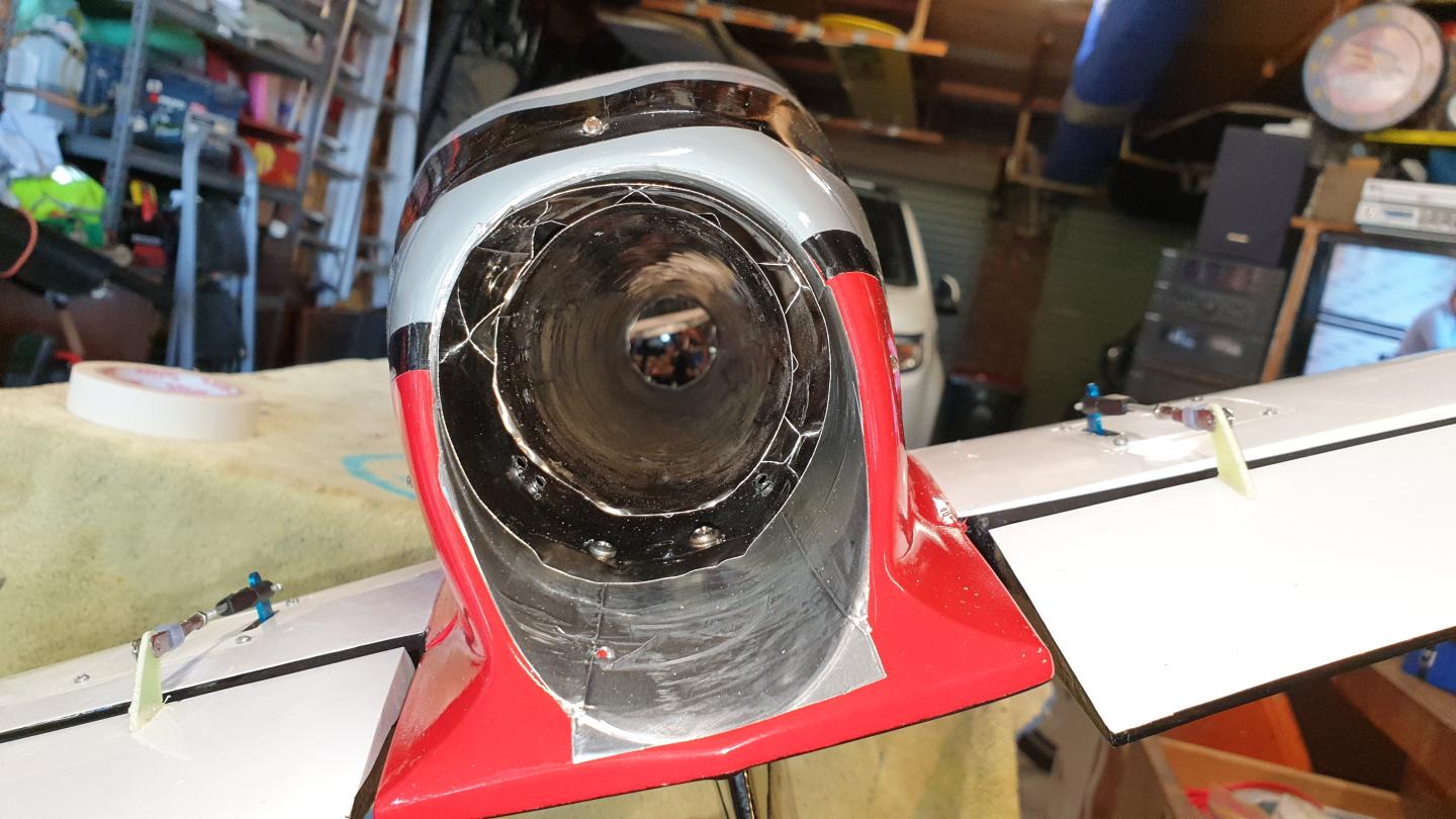

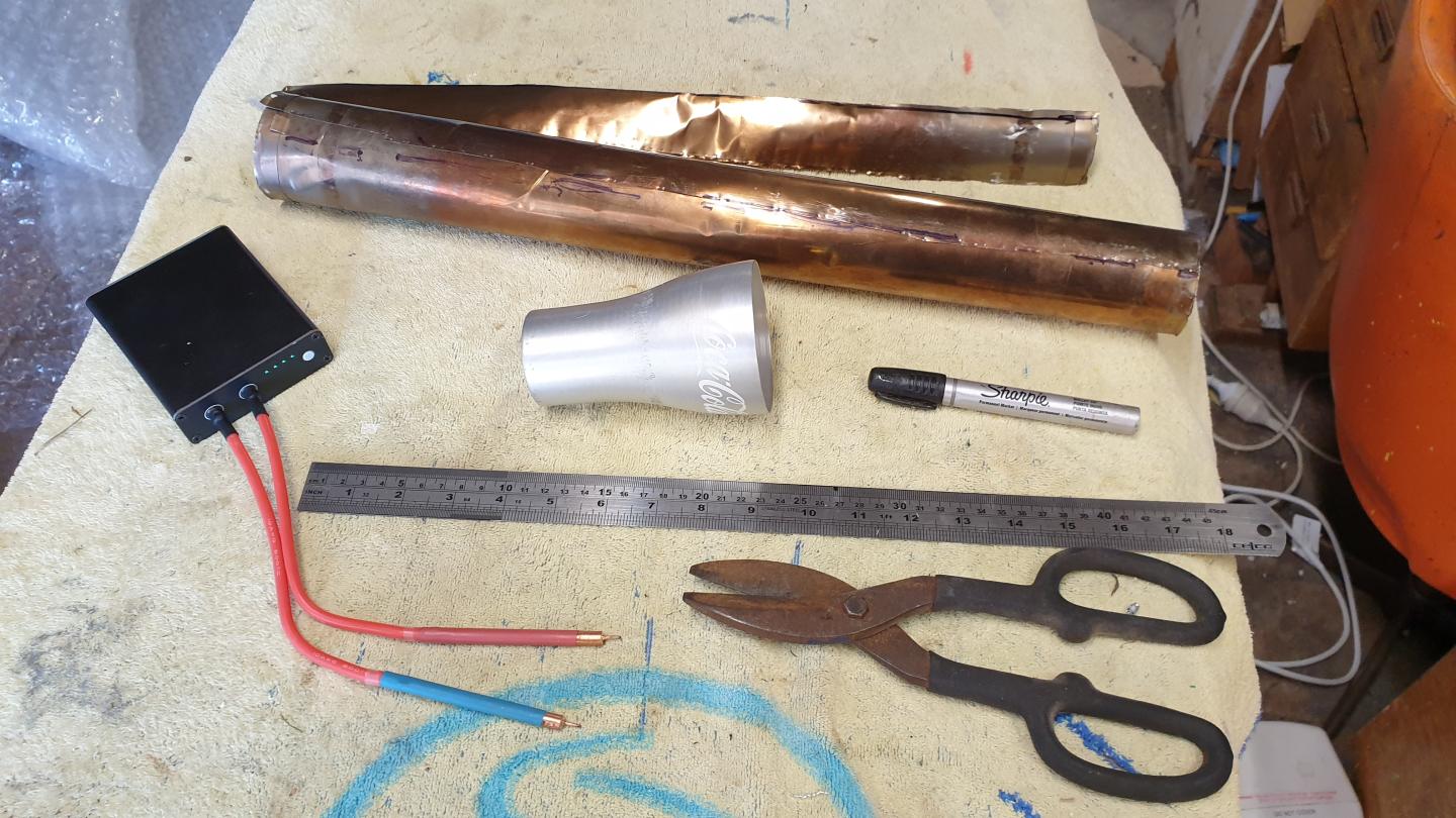

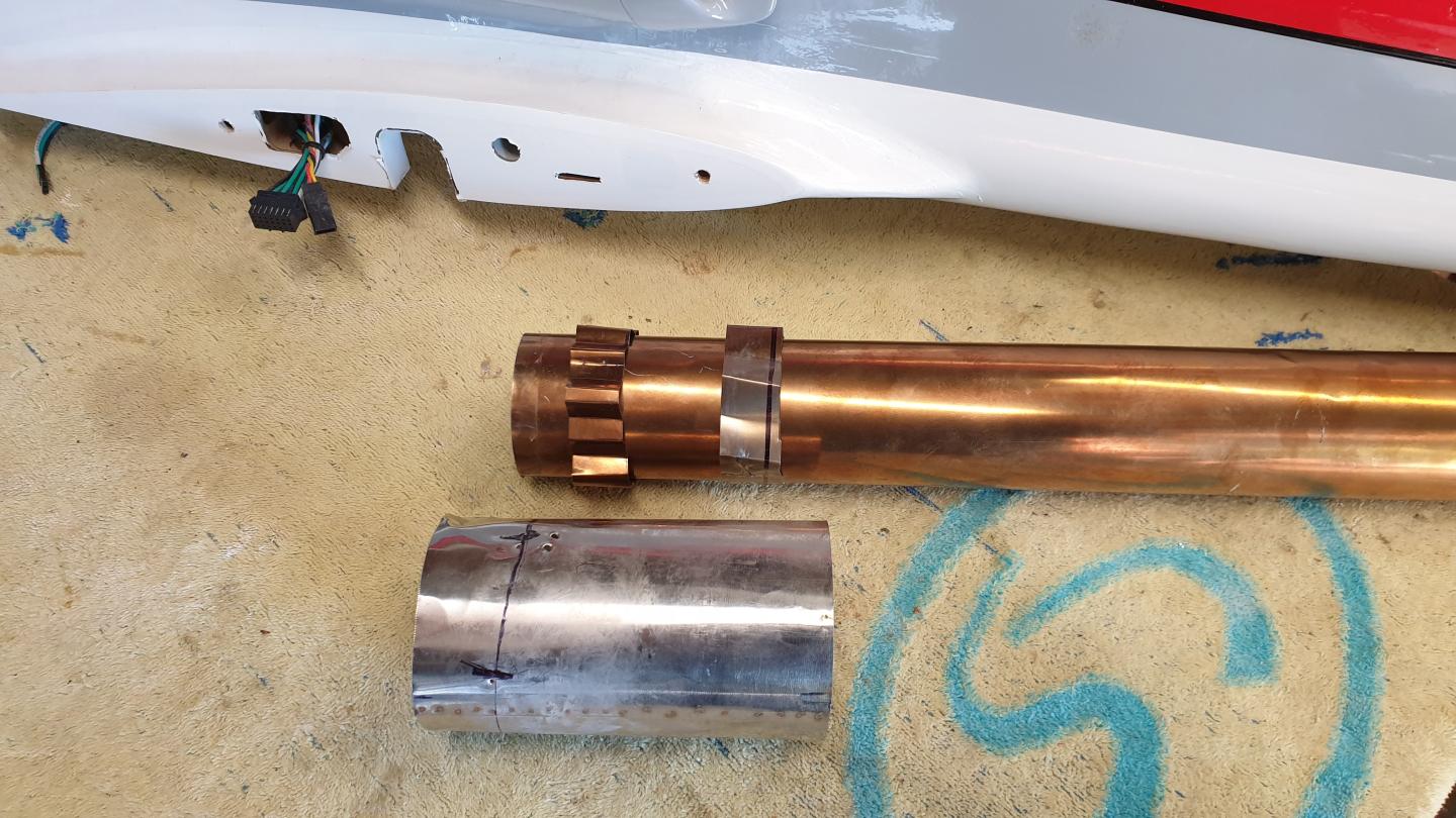

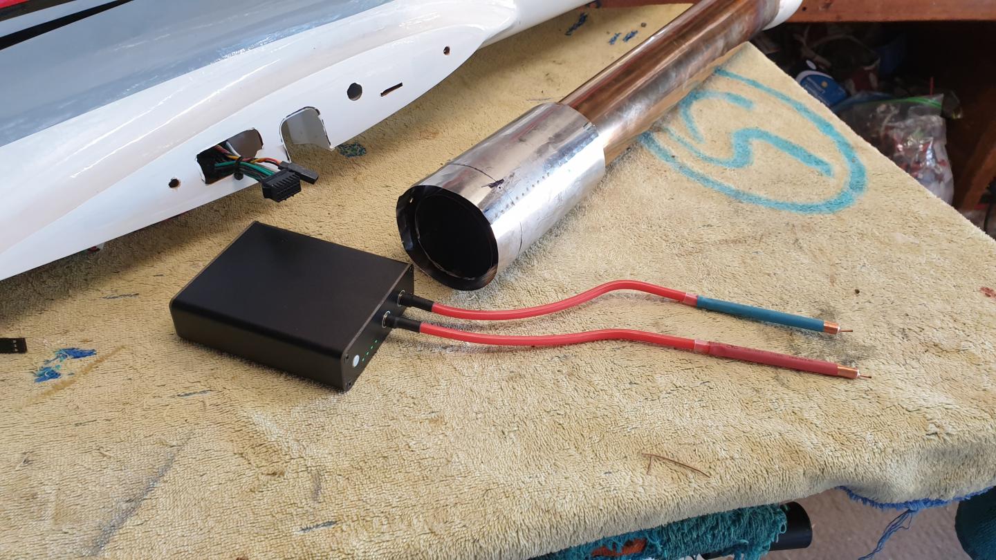

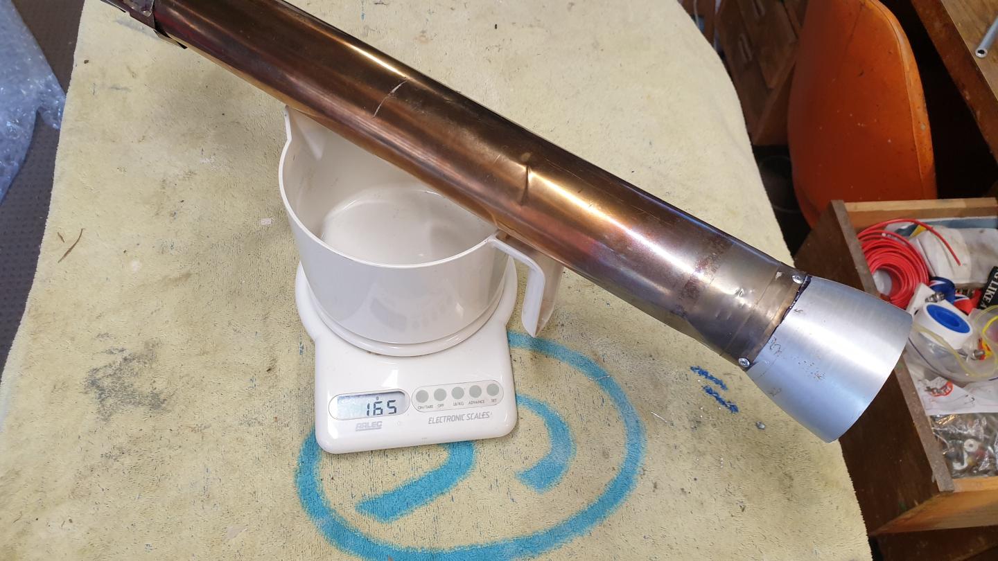

          My flying field is about 200 feet ASL. I have made my own pipe using a eBay spot welder, about 60mm at the front and 55mm at the back. Also, what turbine will you be using?

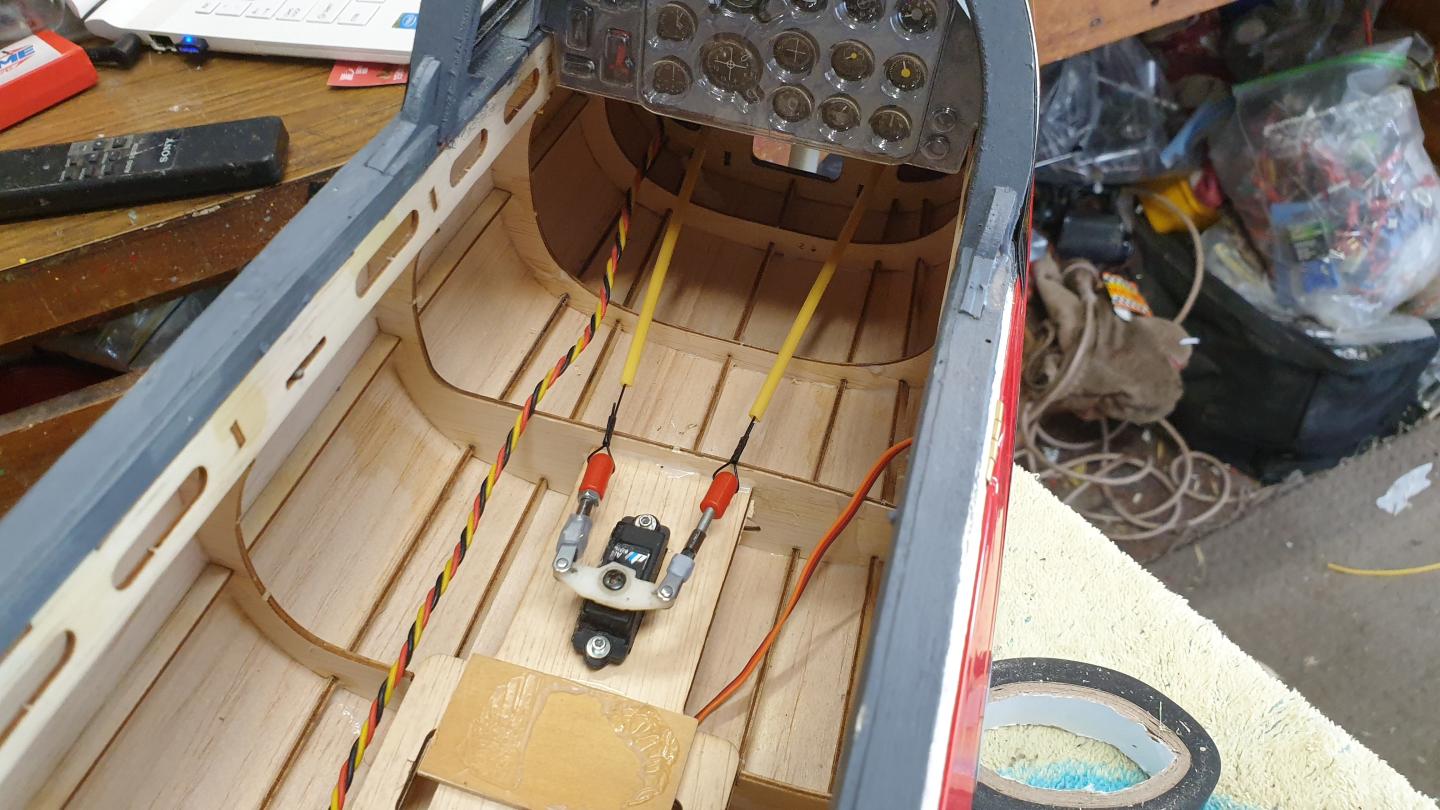

              Their website states, Servo: 08 standard high torque servos, size: (29 x 13 x 30) mm, but I will check mine to confirm. I bought this jet with all electronics already installed, but I want to inspect the servos anyway. Regarding the turbine, I would consider the new X90 as it is flexi thrust and the same size as a Wren 44!! http://www.xicoyturbines.com/X90.html

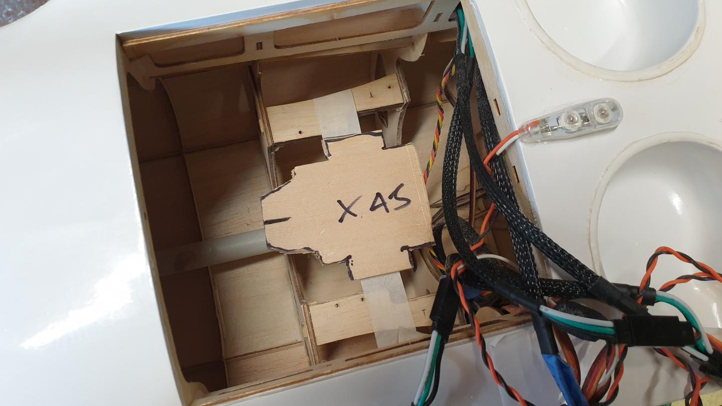

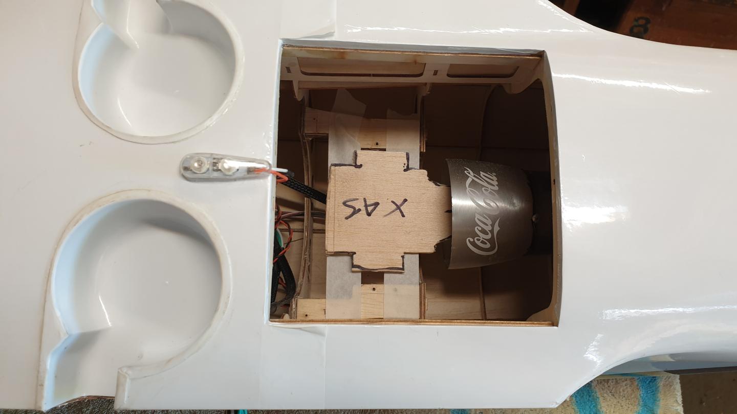

                Hi, just wondering how you went with the Kollibri T35, as I'm putting a X45 in mine, and it is surprisingly large jet!

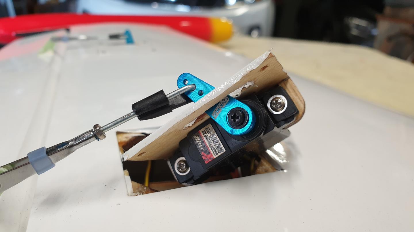

                    Just checked, my jet has these servos. https://www.modelflight.com.au/hitec...cro-servo.html

                        I'll be running them on 7.4v with the gear through a small 6v regulator. It's not finished yet, but those servos are possibly the best that you can get for a jet of this size, and a perfect fit! I have six small turbine jets and generally you won't fly it any harder than if you had a hot 12s EDF in it.

                          Great !!! Thanks for the picture confirmation and all the help. Just fantastic support from everyone on this form.

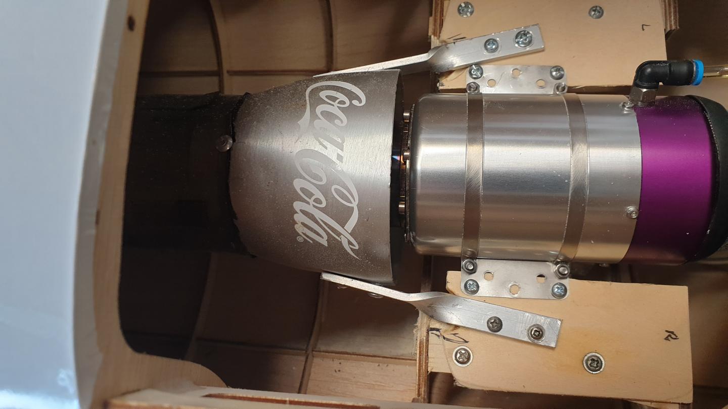

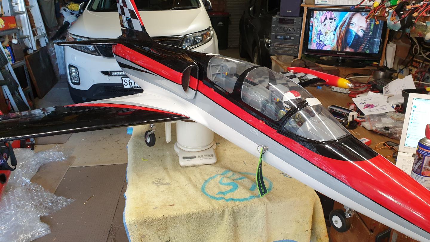

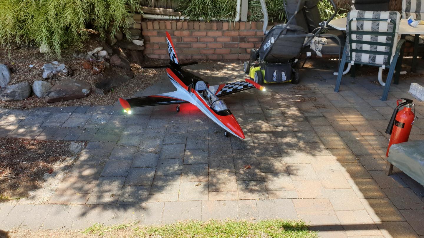

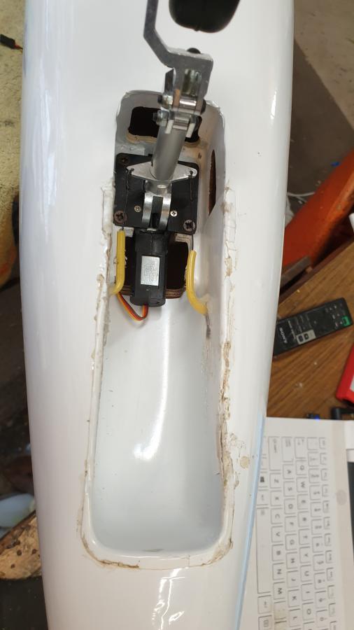

                              My turbine conversion is complete and it came out at 4.8kgs RTF so with the X45 producing 4.7kgs, it should go OK. That incudes 3 batteries and a full Unilight kit installed, plus the CG came in perfect with two batteries up front and one over the one litre tank which is over the CG. Also, I used a AR Booma 20 amp dual voltage regulator to power everything and a JR 12 channel RX. Now just to get time to maiden it!! One crazy design flaw from the manufacturer was the routing of the nose wheel steering cables. They exited the thin plastic tube and went back 180 degrees to the steering arm. I used some Nyrod inner, heated with a heat gun and bent to 180 degrees and fixed with hot glue. Works perfectly and a lot easier than pulleys, hopefully the pics show how I did it. Also, I have used the flexible hinges supplied as they are stronger than the wood that they are fitted into, and have never had one of these hinges fail.
