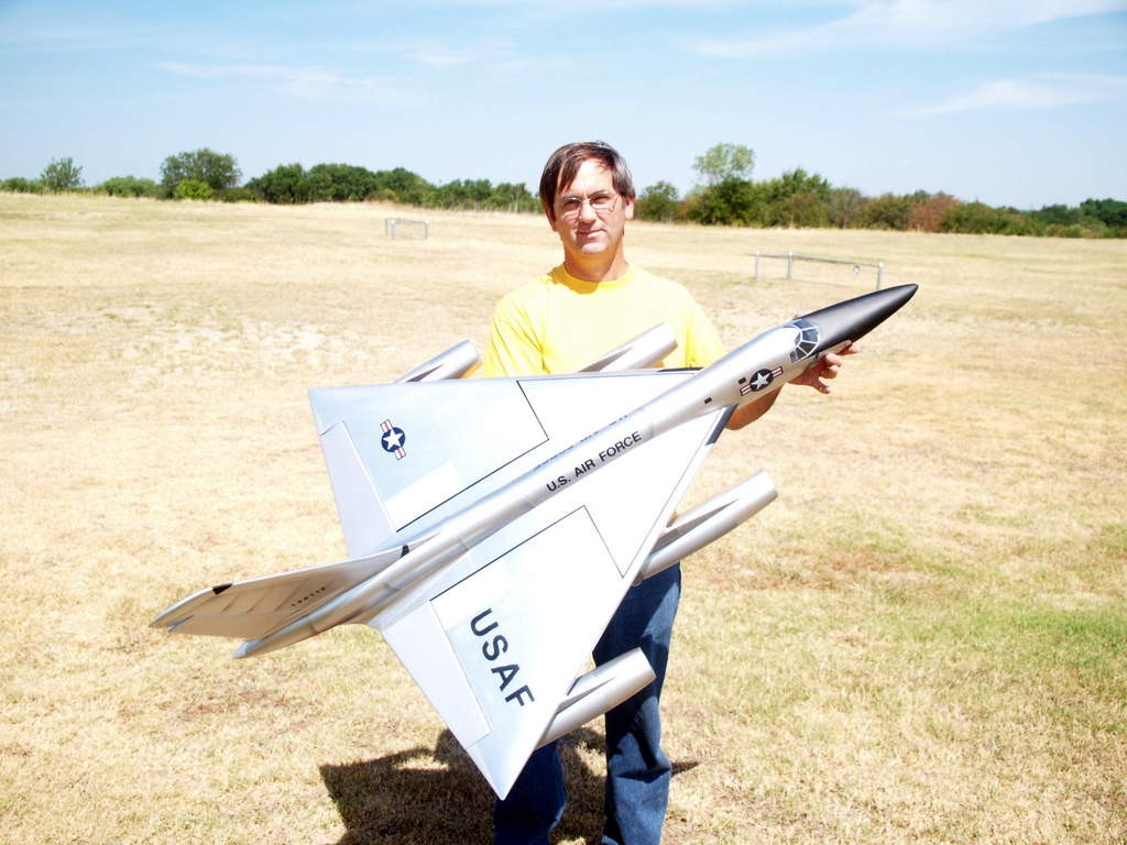

I am going to do some sort of B-58 at some point, as part of my project to buy or build a model of each aircraft ever produced at Air Force Plant Four here in Fort Worth, where I currently work for Lockheed Martin.
The B-24, the F-16, the F-35 and the F-22 are easy. Thank you Freewing and Motion RC.
I have an RB-57F about 2/3rds completed.
Will likely do some version of Keith Sparks Parkflyer Plastics B-58, likely with twin EDFs. It is a nice flying model. will be hand or bungee launched.
