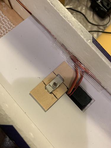

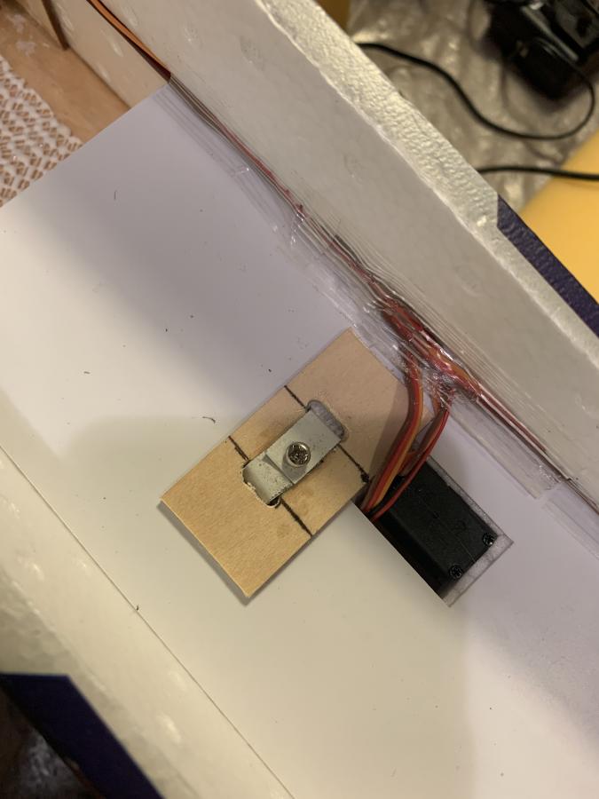

                    A picture of the reinforcement on the mains won't show anything as it's already covered. I basically embedded a 1/4" square CF solid rod (about 6" to 7" long) into a carved out trough (about 1/2" deep) using epoxy to glue the rod in and fill in the trough. The rod end slides under the lip of the retract mount box and extends aft of the box. Since any force on the main retract acts as a lever in that direction, the end of the rod gives that end some support and makes that whole foam area very rigid. Since it's on the underside, it's not visible either on the ground or whizzing by in the air. It's not nearly as strong as that single heavy duty metal plate your friend made, but I'm hoping I won't nail the thing into the ground too hard too many times.
                    Then there's the nose retract. I used your idea to help support the load on the retract in the way the force would push it. I took a slightly different approach. The picture attached shows a metal band that I installed over the long section of the retract as it makes for a better lever to counter the load placed on it in a hard landing. That thin metal band goes through the foam on both sides of the retract tubular section and into the interior of the nose as seen from the top. The band overlaps itself and is secured with a screw in case it needs to be removed for replacement of the retract. I've also epoxied a block of wood at the end of the stock strut brace. That whole section where the wood block is, is filled with epoxy to make for a bigger "backstop". It acts somewhat like one of those 3D printed strut braces that people have made for their front retracts on A-10's and Avanti S.
                    Your mods are way more sturdy and attractive but I did what I could with what I had on hand.

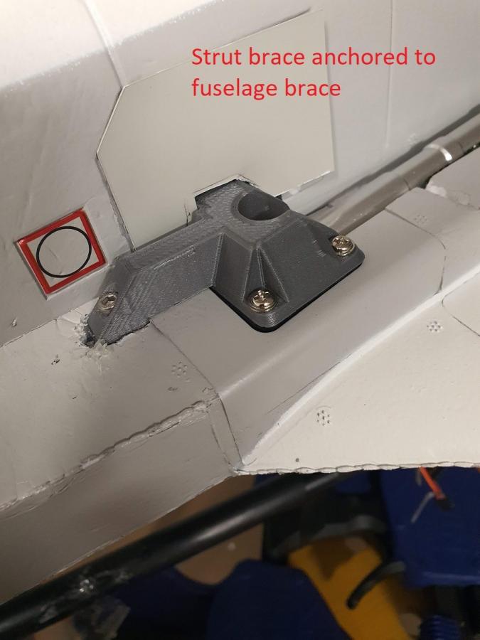

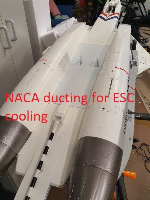

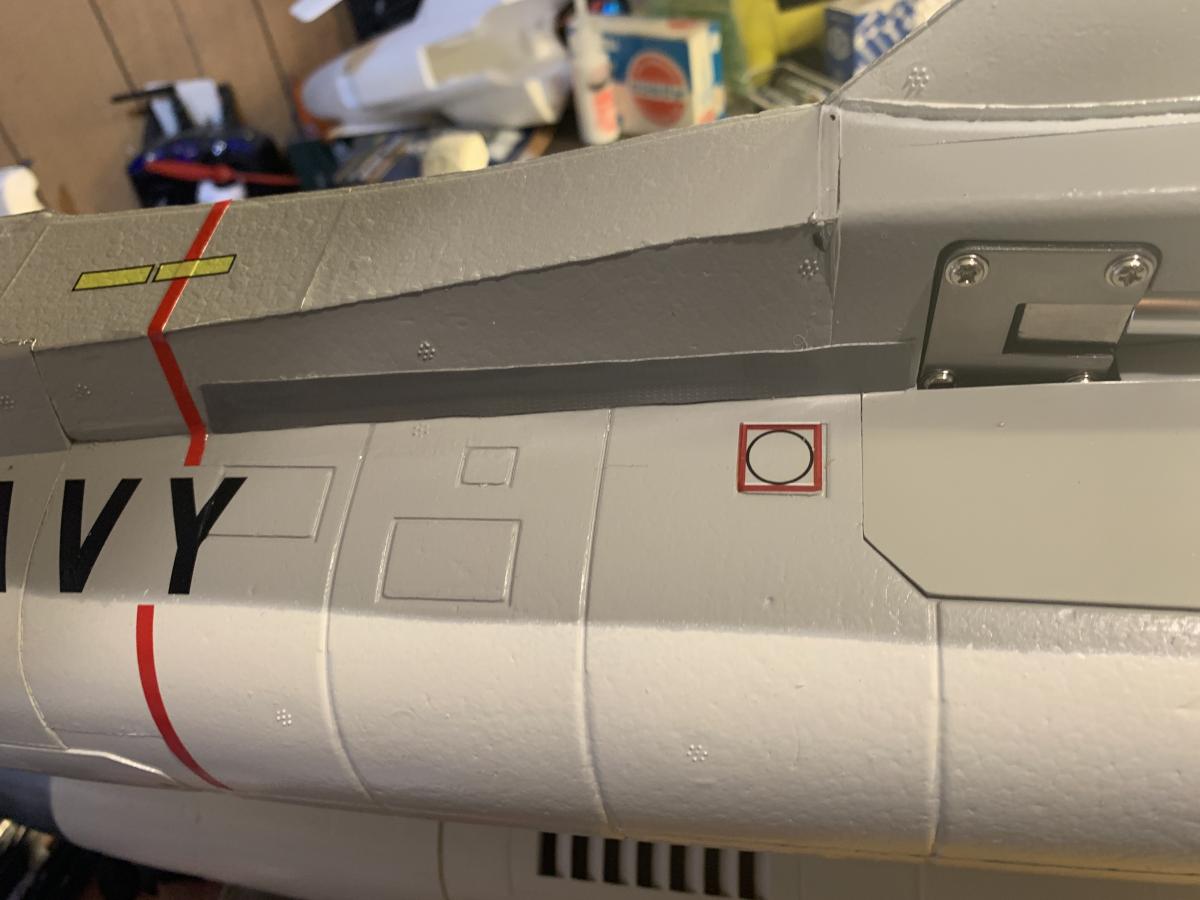

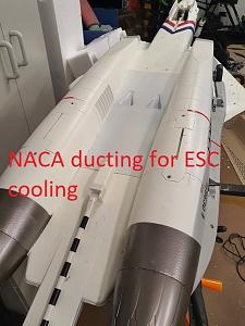

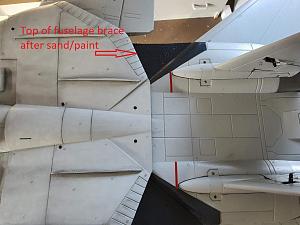

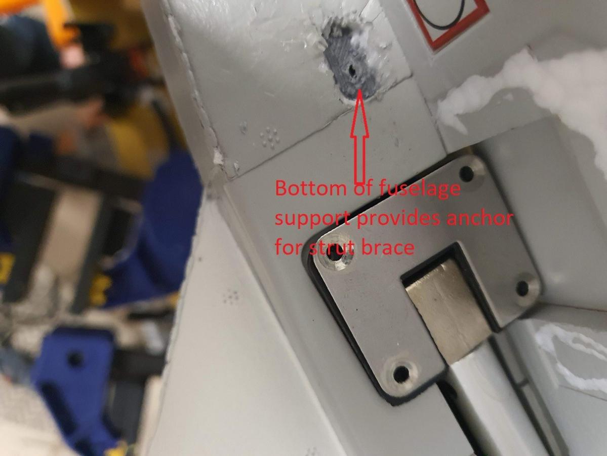

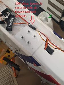

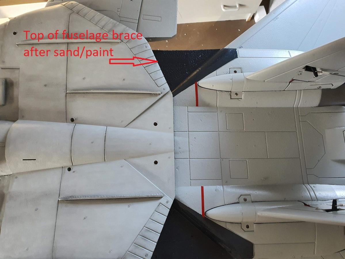

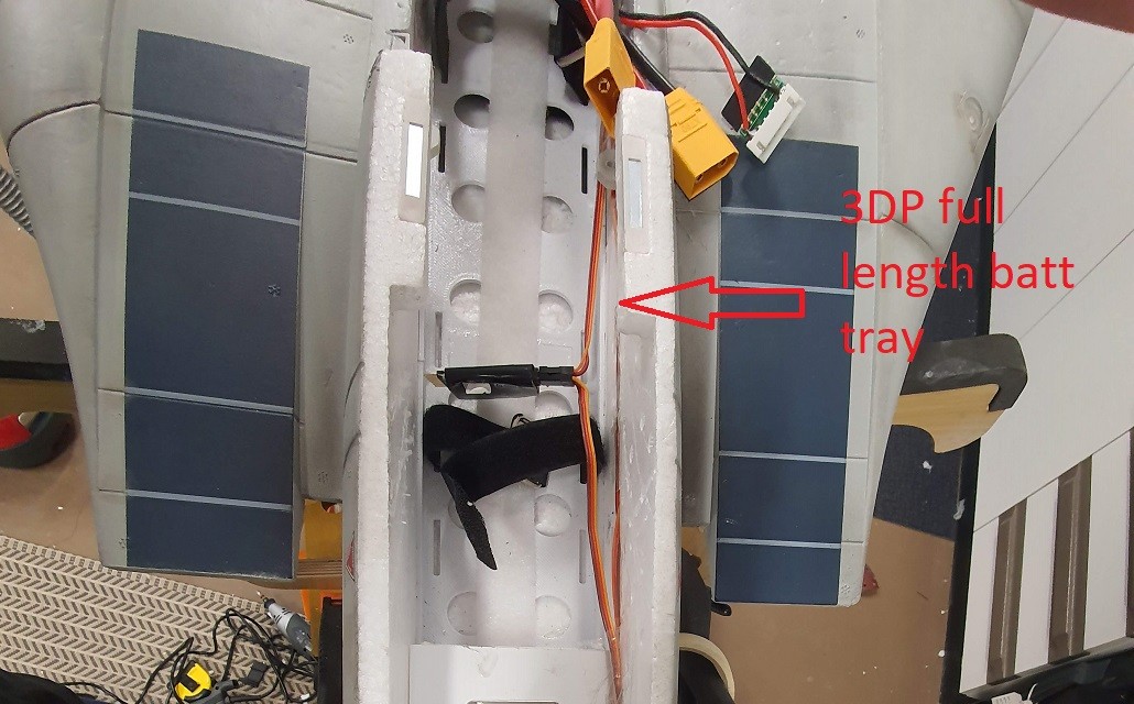

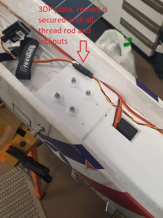

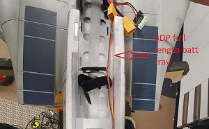

                      Rich - if I may - your vidoes on the F-14 were invaluable. I went down a 3D printed path for both the battery tray mods and various gear reinforcements, but your detailed analysis of the plane could not have been more helpful. I also find your content well researched, clearly presented and above all - entertaining. Thank you for all of the work you put in to the channel.
                      While we're swapping war stories from the grass operations theatre, here's some pics of how the various mods ended up. The external elements look much better post paint/weathering i promise lol. There's been some inadvertent stress testing and it's holding up beautifully.
                      Click image for larger version  Name:	20200728_221625.jpg Views:	0 Size:	84.7 KB ID:	271511Click image for larger version  Name:	20200805_174833.jpg Views:	0 Size:	164.7 KB ID:	271512Click image for larger version  Name:	20200726_205208.jpg Views:	0 Size:	77.4 KB ID:	271513Click image for larger version  Name:	20200726_210059.jpg Views:	0 Size:	49.1 KB ID:	271514Click image for larger version  Name:	20200807_173142.jpg Views:	0 Size:	69.4 KB ID:	271515Click image for larger version  Name:	20200801_162013.jpg Views:	0 Size:	103.9 KB ID:	271516

                        BTW, I really like your strut brace but lacking a 3D printer and the skill to use one, I went another route. Same for your nose brace.

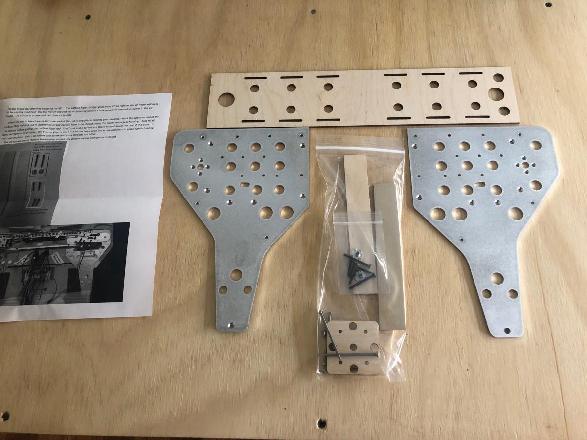

                              My F-14 ARF Arrives tomorrow. Reinforcement Kit ordered from Dustin Holloman, Great guy!

                                Reinforcement kit has arrived!

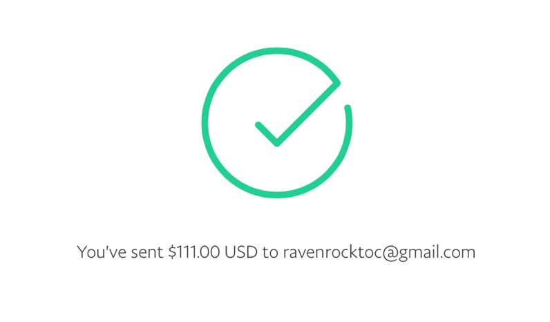

                                    PayPal Dustin Holloman 111.00 and it arrives :-)
