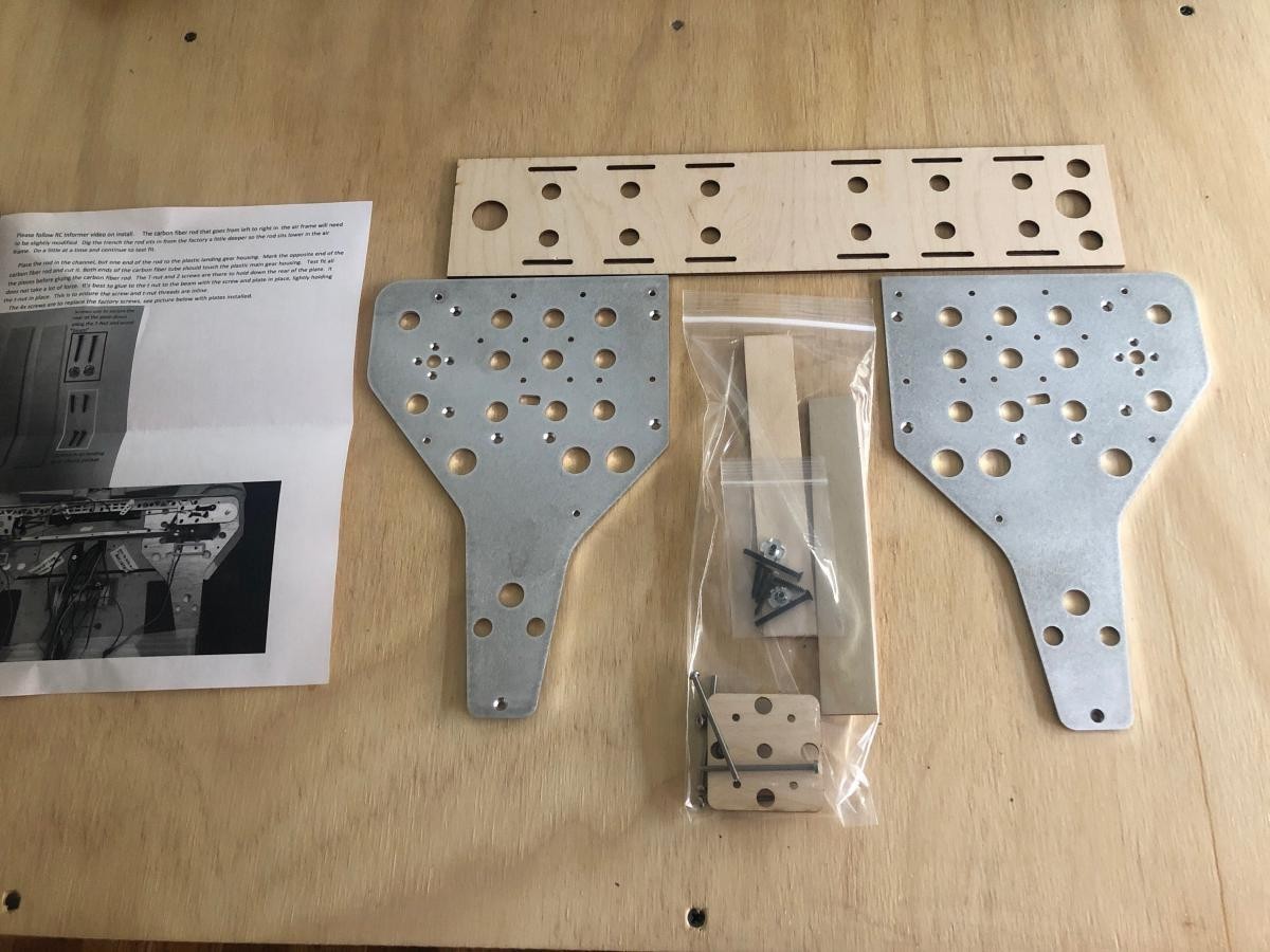

    Et al, I think a CF replacement for the steel plates in the Tomcat is a great mod idea. Any stats on CF thickness to weight/strength versus steel would be appreciated. I like the idea of exchanging weight for performance. Best, LB

                Evan D dk91105 my thought about replacing the OEM aluminum plates with CF plate is 2-fold, lighter weight and thinner material. 3mm alum versus say 2mm CF. I cannot find comparisons of weight to strength gain/loss, if that makes sense. Wondering if it is worth the effort. An overall savings of even a half a pound is worth it to me. There's got to be a way to this bird on a diet. I would think. Best, LB

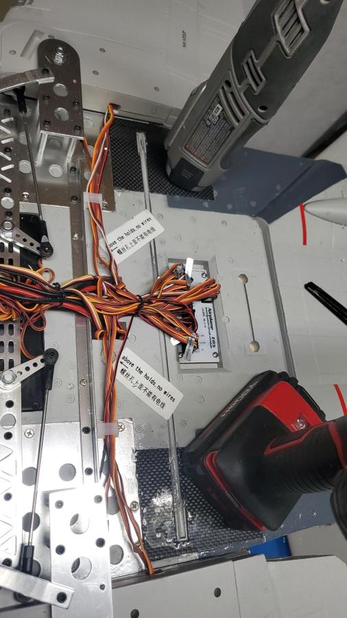

                      Isn't there a big difference in overall size and coverage of the custom plates? The replacement plates extend further aft to make for a reinforcement and possible attachment (if so chosen) for the main retracts. I think the stock wing plates are strong enough and it's the area above the main retracts that was weak due to a seam that runs fore/aft in that area - this seam wasn't even glued very well. After having a couple of very rough landings, which resulted in a cartwheel, I'm of the feeling that only the main gear area needs strengthening. The wing plates are fine. The embedded CF square rods over the main retract housing and that seam, appears to have done quite an adequate job.
                      I never got the custom wing plates so can't say about a weight comparison, but I think because the upgrade ones have so much more material (aluminum), it's gotten weight more. CF would be lighter than AL and should exhibit similar, if not better strength. However, like AL, CF will begin to flex at a certain thickness. At what thickness, I have no idea. Just for comparison (although not scientific) I replaced my aluminum hood on my old sports car with a CF one. Both had the same sort of bending strength but when you push on the CF, it bounces back. When you push on the aluminum one, it bent (dented) and stayed that way.

                                I didn't get them. After analyzing what the upgrade plates did for this plane, I decided their primary benefit was to reinforce the main gear area and that seam. When you put pressure on the retract as when landing, the seam opens up. So, I elected to embed the CF square rods near the main retracts and pushed more glue into and along the whole seam. To the best of my recollection, those rods were about 6mm square and about 7" to 8" long - one on each side. Contrary to what others may have thought, I decided the stock wing plate and accompanying assembly was up to the task.

                                The CF will be absolutely fine. Your struts will bend before the body gives up, I didn't replace the entire plates, what I did was add an extension off the stock plates then put a second piece in under both plates to fuse them together with 30 minute epoxy. The second carbon plate also was glued down to the retract mount and drilled through so the mount would also have its original screws in place. Crossed fingers 🤞 so far it's been working great.

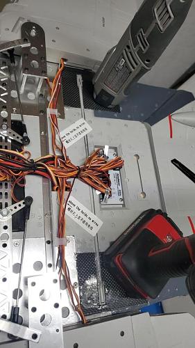

ID:	371365 I used jbweld plastic weld epoxy for mind, and I just used the same thickness as the aluminum plates, if I remember correctly 3mm. But I would still cut away the foam above the gear mount and reinforce it directly to the plate with a small piece sandwiched between the mount and plate that will help a great bit keeping the flex out of the foam as i also did mine differently and left the factory cf cross rod system in place for support as well. These been holding strong, so far so good.
