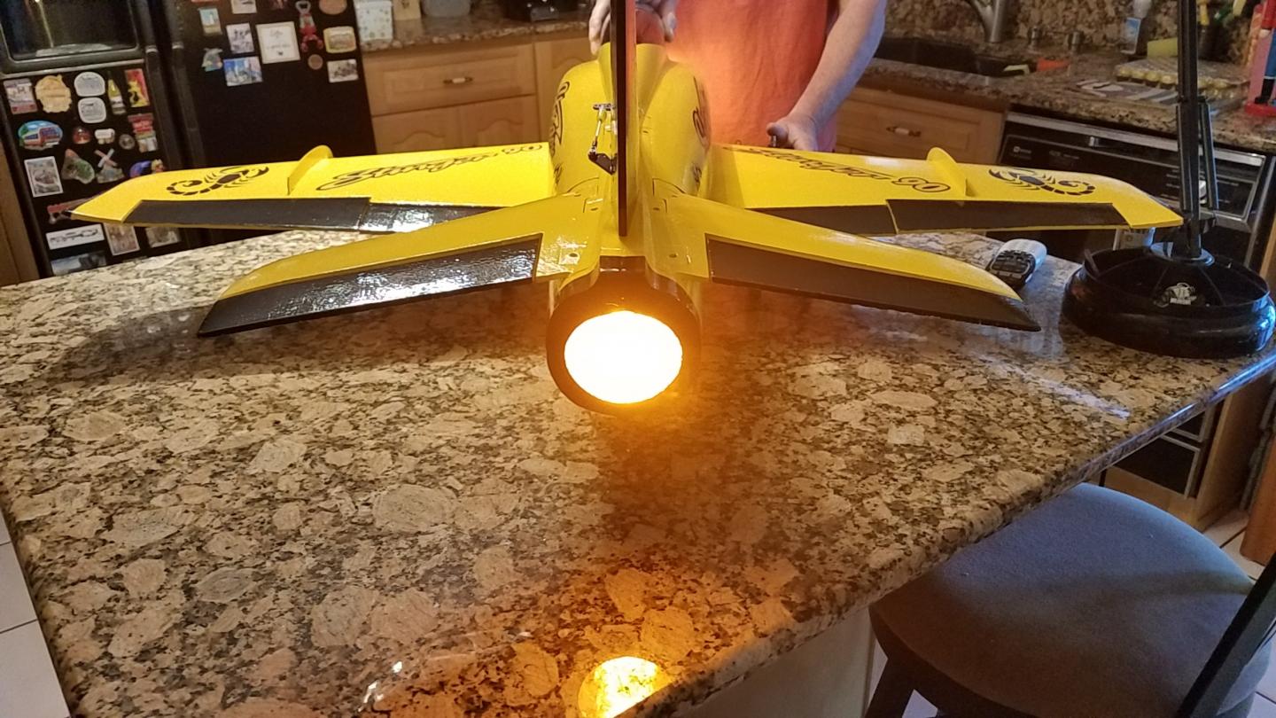

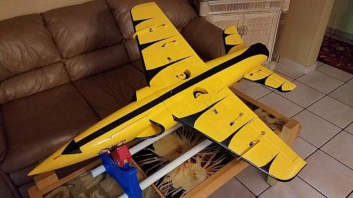

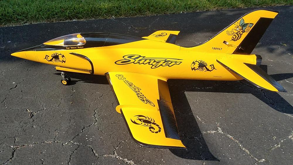

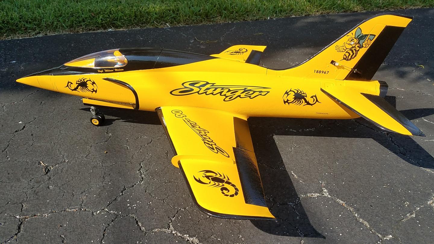

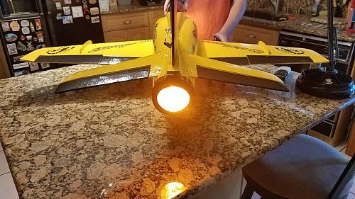

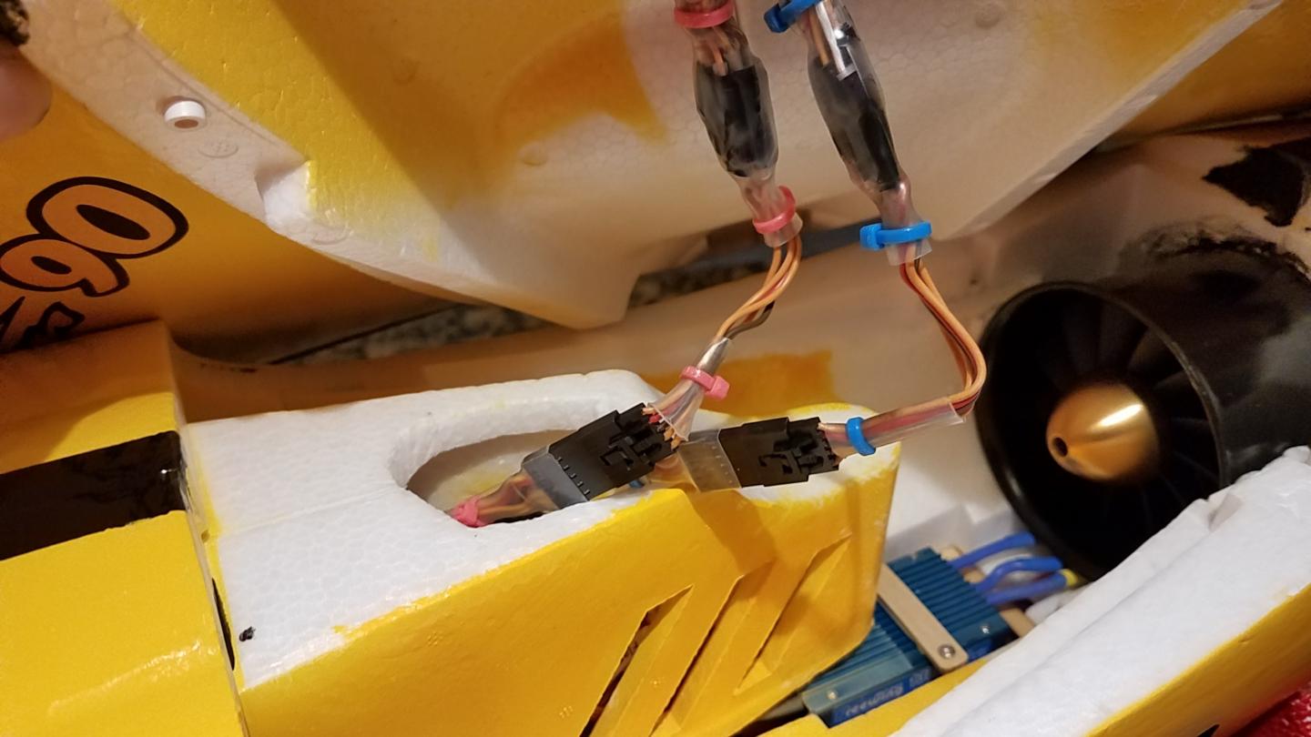

            Late as usual to this thread. I originally got the Stinger 90 when it came with the 12 blade 1650 Kv outrunner. It was my first EDF and at that time I was flying off of asphalt, so it got off the runway just fine. At first, it took a bit of getting used to the increase in speed from the prop planes I was flying but eventually really enjoyed it. Then moved to a grass field a couple years ago and even with that fan it got off fairly nicely. About 4 months ago I put the 9 blade 1900 KV inrunner in it from an F-18 I ordered (which I put the 12 blade inrunner in) and WOW, what a difference. I absolutely love it now, certainly one of my favorite EDF's. The 2 things I hated about it though was the white/red scheme, which gave me some orientation problems (bad eyesight in my old age) and having to plug/unplug all those servo connections on the wing.
            So I repainted it to a more visible scheme (with the help of some custom graphics from Callie) and rewired the connections using the Hansen Hobbies 5 pin latching polarized connectors (used the same thing in the 1600mm Spitfire wings) and installed an AR636 RX with gyro along with a satellite remote. Now it's easy to follow in the air and a "snap" to install the wings. For me, it flies just as well, if not better, than the Avanti. It's always the first EDF flight of the day just to build some confidence up. Using a 6200 mah battery and get 5 minutes of absolute flying fine! Also stuck an RC Geek AB in it, who says a sport jet can't have an afterburner.
            Wing connection photo is when it had the old outrunner in it.
