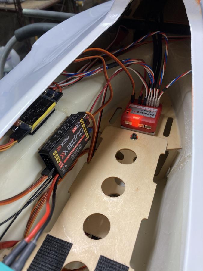

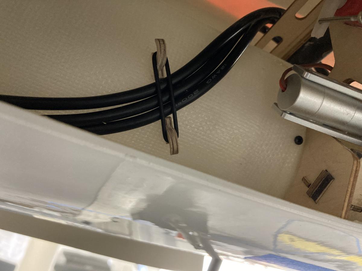

    A couple of photos.
    • Robert Belluomini
      Lithium Member
      • 339
      The esc mounts to the bottom of the battery tray and is positioned just above a NACA shaped opening in the fuse bottom. There is a relief between the inlet ducts that allows the fan to draw air over the esc ensuring cool operation.

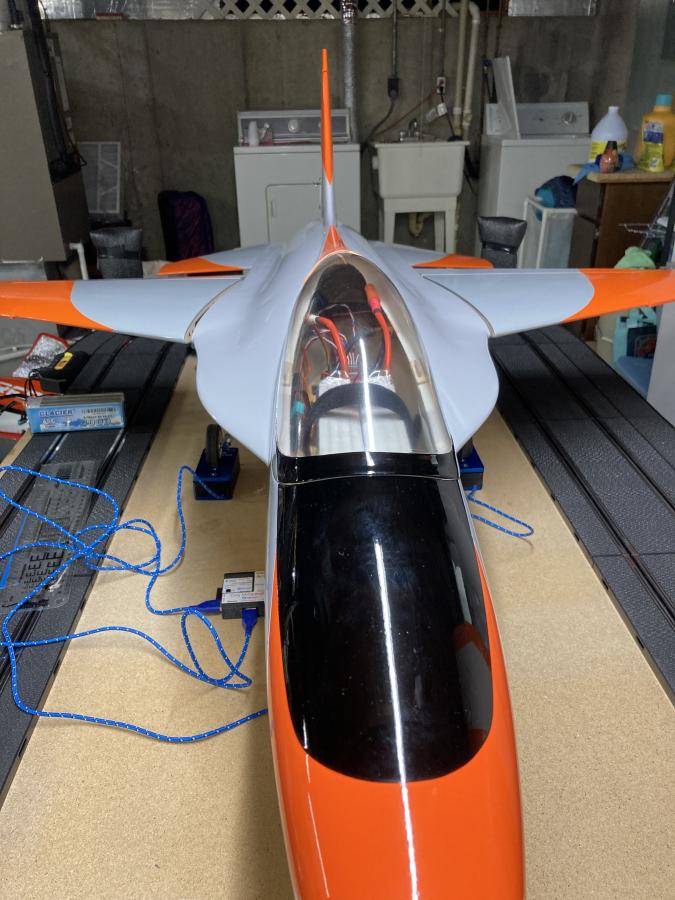

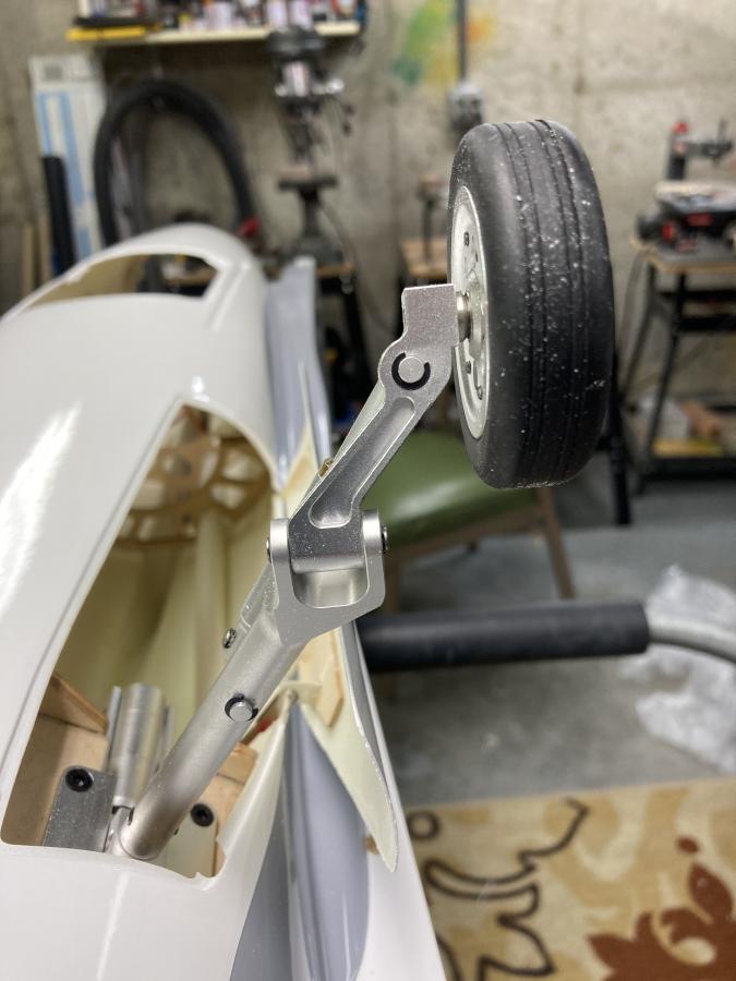

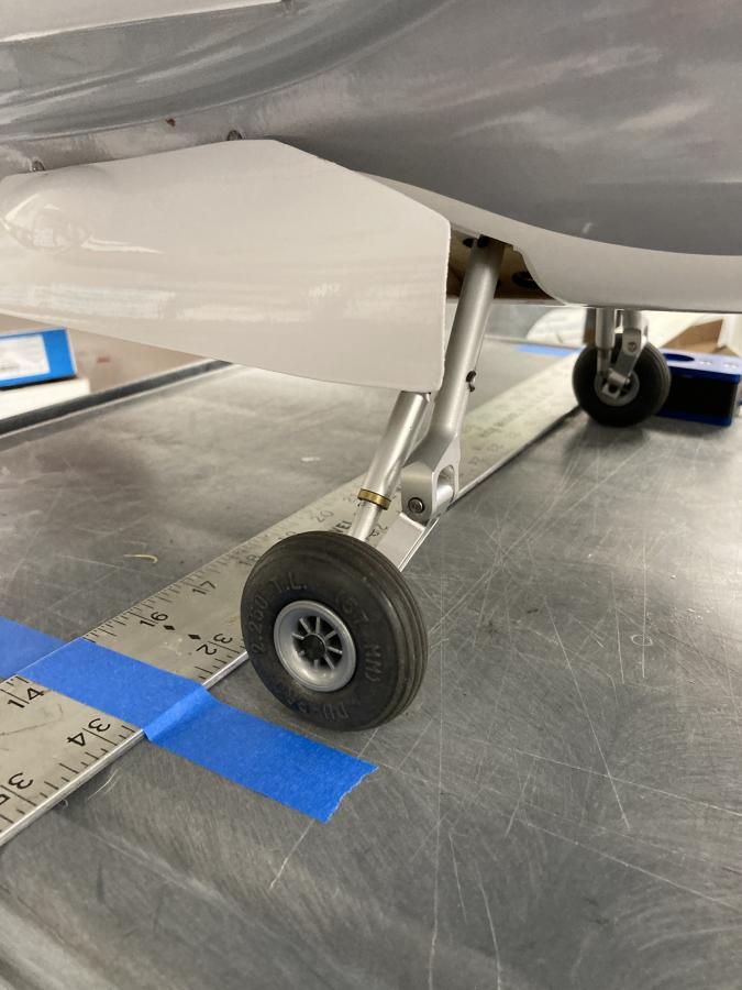

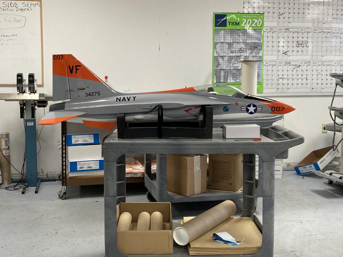

              A few more pics

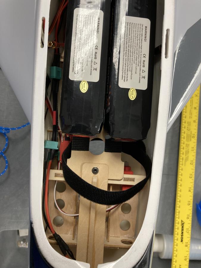

                Great looking jet. I spoke with Andrew at RCJetwerx a few months ago about this bird. I was looking at doing a 12S setup on it He said 2 6S 5000mah packs was about as much as you could stuff in this jet with the space that it has. I'm still considering picking one of these up over the winter and doing an EDF 12S setup.
                • Robert Belluomini
                  Lithium Member
                  • 339
                  The packs will need to have a small footprint to fit with ease.
