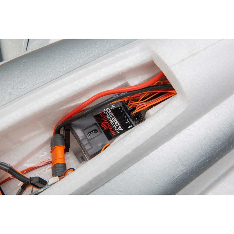

      I just saw the photo. Is the receiver wire.that comes from the ESC orange, yellow, and brown? I'm pretty sure the throttle lead on all of my planes tends to be black, white, and red. I don't have the Habu so I don't know with any certainty. Is there an extension on your throttle lead from the esc to the receiver? Any chance that connection is loose if there is an extension lead?
      • Tacticaljeep
        • Jul 2021
        • 19
        #23
        They are orange yellow and brown for esc and no extension lead. I'll try swapping motor and esc and report back this evening

                It's doubtful that the rx is damaged, but possible. It just more points to either power not getting to the esc or something in the initialization process. I looked at a photo from HH site, are you sure, in this model, that channel 1 is for throttle? What does it say in the manual? Click image for larger version

                    I just looked at the manual, esc is channel 1.
                    Check all of the connections, make sure your battery is charged. Not having the plane in front of me is difficult to troubleshoot. But it seems like it's something with the throttle initialization process.

                        Throttle cut not enabled and verified switch on transmitter works via real flight simulator.
                        channel 1 is for esc per manual and my reference pics I took before disassembly from crashed airframe.
                        All servo plugs are oriented correctly and all control surfaces respond correctly including nose gear.
                        All transmitter functions/ settings work with simulator.
                        Yes, the reclever is separate from flight controller.

                                          Performed inspection and found ESC plugged into port one. On most air frames, the ESC does go into port one. On this particular ESC, it goes in port 6. Changed port and performed function test. Plane operating as designed.
                                          I ran and checked my manual, it clearly states to plug esc into port 6...although the actual flight controller is labeled "port 1/esc".
                                          Just a bunch of self induced confusion.
