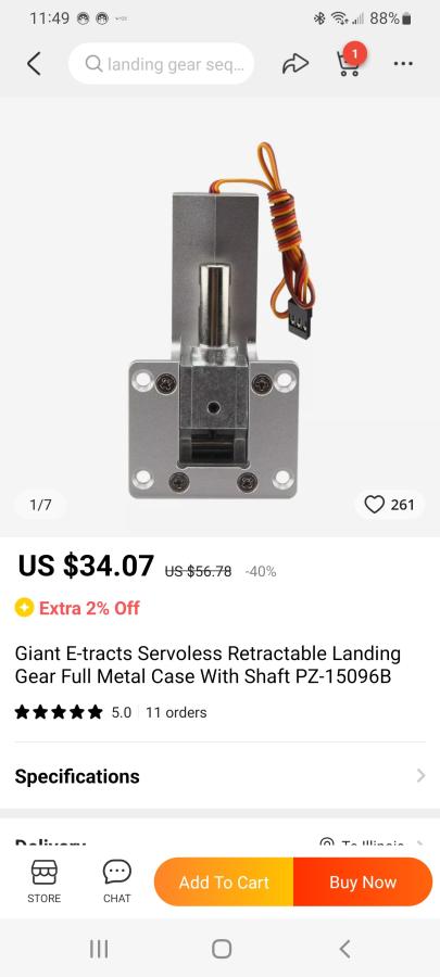

          These retracts have a 10mm pin and are a perfect fit. The mounting holes line up and they seem well made. The connecting pin on the stock struts is painted. In order to get it to fit in the retract I had to remove the paint with stripper. Also the retract has to be taken apart to remove the pin it came with.

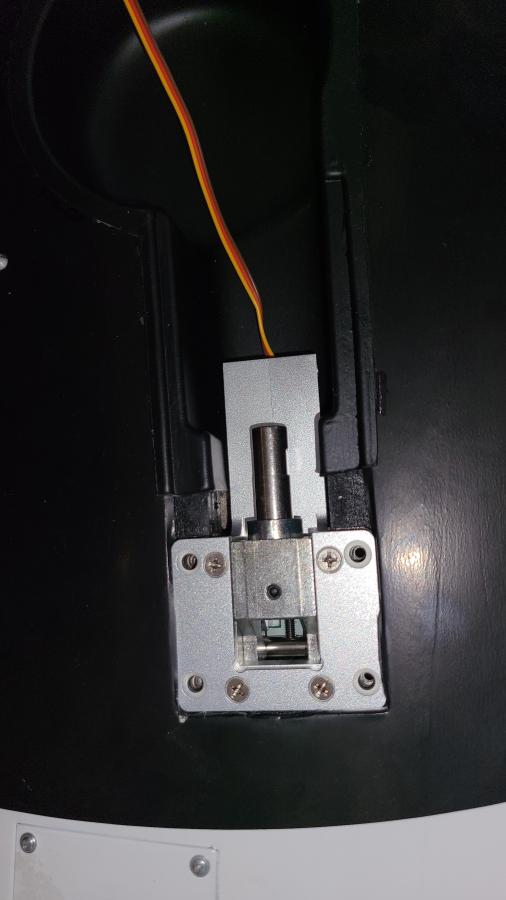

            This retract fits the stock front strut after the paint is removed from the connecting pin. I just need a screw to put in the trunion to retain the strut and allow it to rotate.

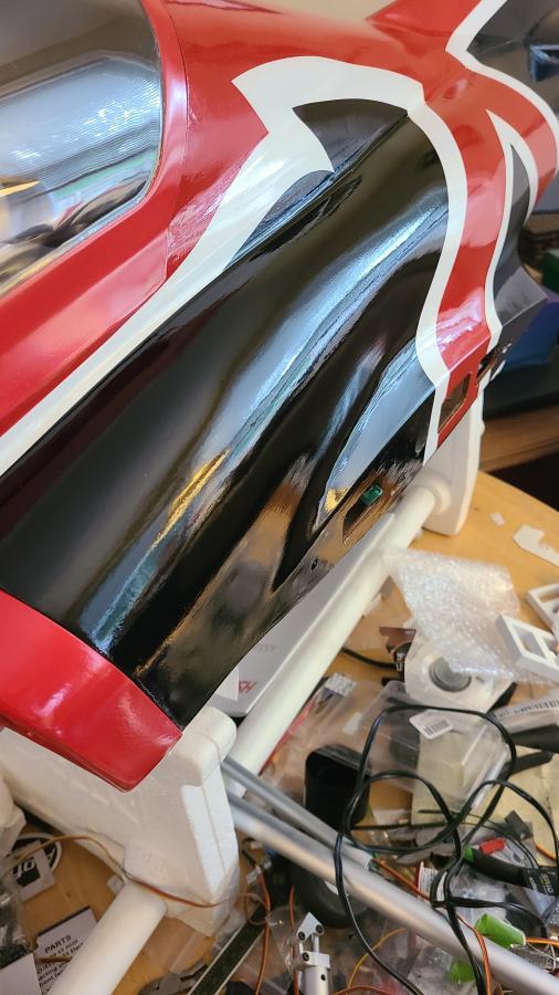

                      Finished with Minwax Polycrylic spray. It runs easily so have a brush ready to smooth out the drips as soon as possible. if you miss some and they dry( like me). Wait a few days for it to harden and then carefully shave off the drips with a razor blade. I will either put a sticker over it or very carefully hand rub it. The coats of poly applied don't bond with each other so be careful not to sand through the last coat if your going to use sand paper. If you do it will leave an eye shaped mark that you will see.

                          I would have preferred to use an automotive clear coat, but it's just too expensive. The only trouble I had with the polycrylic was on the fuselage. The printed graphics seem to just be ink. So if you get a run from the red onto the white you get pink drips on the white. I saw this when it was still very wet and was able to wipe most of it off, but if you know it's there you can see it. The wings and stabilizers I made a them able to rotate while I was painting so if I got a run I could rotate it 180 degrees and get rid of it. The fuselage was able to rotated once and then it got stuck. On the second coat I got runs and was unable to get rid of them because I couldn't rotate the fuse.. I used a brush and thought I got them. I came back an hour later and they were back and hardening.
                          My advice, if you can get a paint gun and a compressor and then buy the brush on polycrylic and thin it as recommended. You can mix it a tad thicker and maybe still get a good finish.
                          The plane looks a thousands times better with clear on it.

                            We have finished the clear coat and it does look better; consistent finish makes it look nice instead of having one party gloss and another flat.

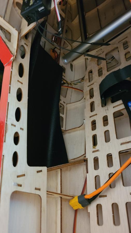

                                  What's everybody doing with the intake ducting? I think I'm going to either completely eliminate it or just use enough to cover the first couple of formers on the interior side of the fuselage. Seems pretty flimsy though.
                                  Also is anyone using the two small intake ducts on each side of the fuselage?
