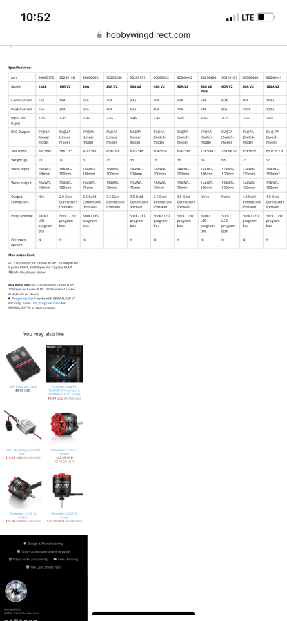

        Just getting back into the hobby I have 2 Skywalker 60’s currently and a few Spekrum Avians I almost exclusively use Spektrum or DID. ESC wise the Skywalker V2 you’ll have to program in reverse but have the option to also do other adjustments off your sticks ( transmitter ) which is super easy compared to Spektrum that they can’t even give the correct way to do it in the remote directions so I’m happy with the Skywalker ESC’s program reverse easy as throttle stick up listen for the tones and it’s set. Want to adjust timing same listen to the tones go to mid or high timing way easier to me than Spektrum

          Here’s a screenshot and I can take a picture of the directions with features if you’d like from one of mine

              Hey shortround91. I learned how to setup reversing on AVIAN ESCs from brianphillipsRC youtube channel. It wasn't difficult once you do it a couple of times. I also stopped using AVIAN ESCs. I changed ESCs mainly because Spektrum ESCs are way too expensive for my taste. At the time, it was the only brand I knew that could do this, so I felt I had to buy them for this feature. It got me thinking that this couldn't be the ONLY brand that thought of this. So I discovered the brands mentioned here, at a significant lower price. I have also stopped using Spektrum receivers for the same reason, cost. I discovered LemonRC 10 channel receivers with gyro built in. They have a tiny bit of telemetry but I didn't really need that. They're more channels for less. There is a learning curve for these but that is with anything new to you.
