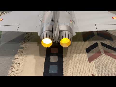

                      #31
                      Originally posted by kallend
                      My controller design would certainly drive it and produce as much (or as little) flicker as you like.
                      I guess I should have followed up with the video: Independent flickering in each tailpipe.
                      The turnon point, and the amount and duration of flickering, are all adjustable.

                        #32
                        KL, that, Sir, will do nicely. Bravo Zulu. Best, LB
