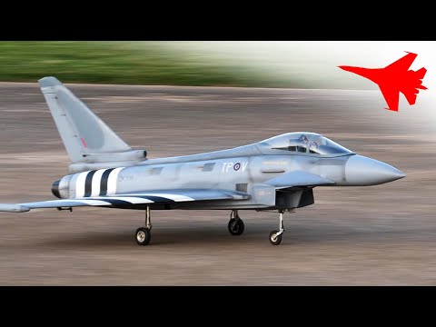

    Long time, no new FW Euro vids!!
    Been neglecting it in favour of the Eurosport, my bad, lol!
    Great vid your definitely in tune with her

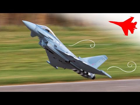

    And to send off the year...
  • Airguardian
  • Airguardian
    w00t
