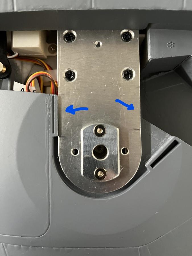

    Just be aware that a hairline crack under paint may be invisible to visual inspection. I saw nothing on mine until it broke. Then paint on the fracture surface showed that the crack was already there before the wing was painted.
  • kallend
    Originally posted by Aros
    Yikes. I'll be checking that first thing when I get back from vacation.
    Just be aware that a hairline crack may be invisible to the naked eye.
    Apparently BH has known there's a problem for some time and is willing to SELL you a reinforcement. Very gracious and generous of them.
  • didier n
    I just assembled mine yesterday, and upon checking today i don't see any cracks. What i did notice upon assembly is the wing sweep mechanism having just a bit more travel than the actual wing sweep. Result is a lot of stress on the ball joint, which in combination with possible cracks is not good. I sanded a bit off the aluminum part where the wing sits when in position, that way i have no more stress on the ball joints ..
    It won't fix the crack problem, but sure will help...
    the arrow in the photo shows what i mean..
    regards,
    Didier​
