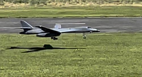

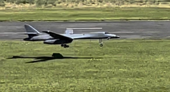

It's hard to see from the video but it looks to me during the take-off roll that the dihedral is coming from the wing root area (the pivots), and is not flexing in the wing itself as would be expected if a spar was missing. At 0:09 the wing itself looks quite straight but it is definitely angled up from the root.Leave a comment:
The other thing to check would be the bearings embedded into the wings. They may have missed adding the bearings on the bottom side of the wings. Having only one set would result in something looking very similar.Leave a comment:
I wonder if you got a QC fail where the factory sealed the wings up without putting in a spar.. it’s the only explanation I can think of that would result in that.Leave a comment:
Well drat, that's what I did too which means it's something else and I have no idea what it could be. I'll have to take the wings apart and investigate.Leave a comment:

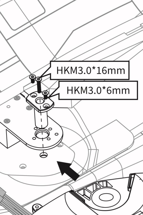

The wings had a ridiculous dihedral so I was hoping to get someone's advice...When you mount that metal bracket piece to the pivot point mech, did you use 16mm length screws for all of them? The manual confused me...Looks like two are a 6mm and the other is 16mm? Perhaps that would explain the dihedral? Not enough "meat" going into the holes?

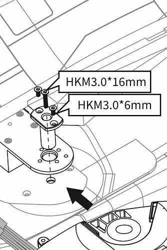

Here's the portion of the manual I was referring to...And get a load of that dihedral!!
