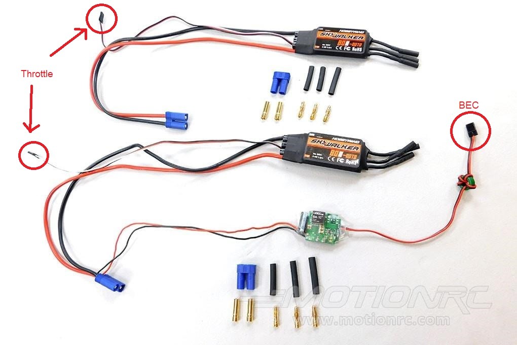

The ESCs have two battery connectors, probably EC5 and three connectors that look like servo connectors. Two have three wires and they are the throttle and get Y'ed into your receiver throttle channel. One has only two wires, red and black, this is the BEC power lead and is what powers you receiver, servos and retract and gives your motor the signal for throttle (through the receiver). You plug this into a spare receiver port or even on an appropriate slot of the E05. See attached drawing.
The bec is plugged up and both batteries plugged up it has a red light on but reciever has green light. No matter which way the on off switch is in the lights and beeping come on all of the e05 was either plugged up by motion rc or it was labeled by themComment
