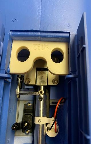

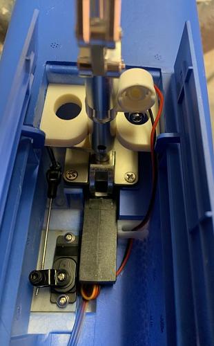

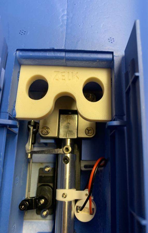

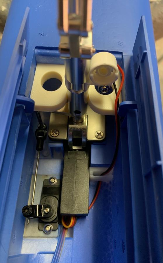

                Who likes a nose gear brace?
ID:	389879 Click image for larger version
                • #28
                  ThanK you very much

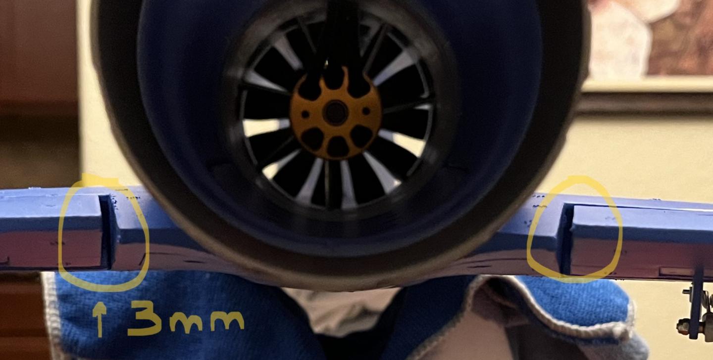

                        8S Maiden Report:
                        Late this afternoon I completed the maiden plus two additional flights.
                        CG exactly on factory marks with gear down (since nose gear retracts forward)
                        All control horn positions moved in towards servo by two holes--using the third on from the end.
                        All control deflections matched the manual settings except elevator in HIGH (100%) . As I suspected, book deflections, especially the elevator were way too much for this type of jet. Flap settings are per the manual.
                        Maiden = 2X SMC 4S 5900 HCL/HVP
                        2nd Flight = 2X SMC 4S 6200 HCL/HVP
                        3rd Flight = 2X SMC 4S 5900 HCL/HVP
                        RX =Spektrum AR8360T SMART with AS3X and SAFE (maiden conducted gyro-off)
                        Observations:
                        I was actually pleasantly surprised with how the airplane flew once I got it trimmed up. With my gyro off, I conducted stalls clean and in the landing configuration with full flaps, upright and inverted spins, attemped snap rolls with only pitch inputs--no rudder--upright and inverted. Also tried inverted loop--was successful in low rate elevator (who wants to do that though)--but in 100% high rates (remember I moved my elevator control horn out of the "3D" factory position) she definitely snapped out of the maneuver. Not dramatic but definitely wants to snap pushing forward on the stick. I can imagine if Evan used full book elevator why that got his attention When my gyro was in the AS3X flight mode, it was noticeably more resistant to snaps.
                        I noticed no unusual behavior during the full aft-stick stalls in any configuration--nothing different than other sport jets (other than the Avanti) and definitely much more tame than the Havoc Xe.
                        I was really surprised that I did NOT notice any nose-down tendency when pushing up power to full during a go-around or low pass.
                        Landings really reminded me of the Havoc--my first few were purposely fast, then I started slowing them down and even tried holding it off until the stall (but just an inch or two above the runway) Unlike the Havoc, which would drop a wing if you breathed to hard during the flare, I couldn't get the wing to drop even when running the 2 X 4S 6200's. I wouldn't try holding it off though unless you could keep it within an inch or so of the runway.
                        At the CG marks--I found that I did NOT need the down flap/elevator mix the manual gives. I got rid of them on the second flight. Flew on final so much better and the flare was nicer. Note my stab trim at Book CG in pic below. I am feeling compelled to move it back as I just don't like the up elevator trim required at that CG.
                        Thrust Reverse - Well I was disappointed--it helped a bit, but not as effective for braking as other jets I have. I have a mix set with the reverse channel mixed with throttle, so all I have to do after touchdown and in idle is hit my "G" switch full up and it goes to 100% reverse power.
                        All in all I like the jet and will continue to explore her performance envelope. Oh, I did have a broken cloud layer a little bit of haze and I did find the airplane a little difficult to see when I was high and the sun wasn't shining on the plane. When it did--it stood out nicely. The upper fuse EPO above the intakes is softer than I'm used to--put a nice thumbprint dent on it as I was rotating the airplane off the stand.
                        I didn't do any speed runs today--I was more interested in exploring the flight characteristics. Those are easy and will be later. Hope this helps those who are waiting to maiden theirs.

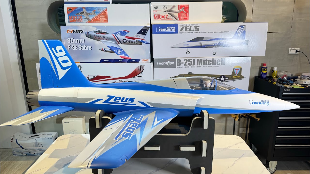

                                      Last week I bought the ZEUS 8s
                                      a couple days later the box from MotionRC arrived woohoooo
                                      but uhmm it was the wrong model
                                      they send me the 6s noooooo
                                      quickly I send a email to MotionRC
                                      (and I saw that the last 8s model was out of stock arrgh)
                                      I picked up my phone and called them.
                                      in short: bla bla bla sorry send it back !!!
                                      but but its going to take days noooo
                                      I jump in my car and drove to them the next day (2hours on the highway)
                                      Click image for larger version  Name:	D0121E80-22C9-4FA2-ABDF-674C30189DD6_1_201_a.jpg Views:	48 Size:	176.8 KB ID:	390574
                                      yesyesyes my box was still in the warehouse !!!!!!
                                      hopefully tomorrow I can do the Maiden (weather is very bad last couple days)

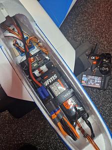

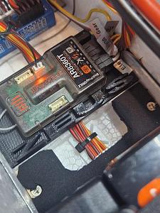

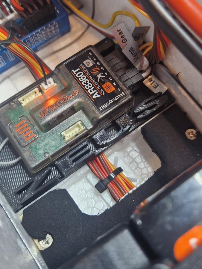

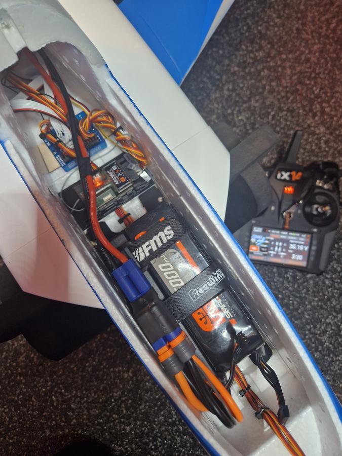

                                      SPEKTRUM AR8360T
                                      Click image for larger version  Name:	B428B7B9-3404-4F77-B3BE-1E23F1024AF4.jpg Views:	14 Size:	98.4 KB ID:	390575
                                      SPEKTRUM SMART 6S/5000 + 2S/5000
                                      Click image for larger version  Name:	5182B322-2952-4C8B-BB4C-953C0314FF15.jpg Views:	14 Size:	93.8 KB ID:	390576
                                      CG from the BOOK ??
                                      upside down with Landing gear out ?
                                      any other suggestions

                                        Hey Danny--read my maiden review above and on RCG. Has everything you need. I flew it again today (first time since maiden day a week ago). Verified that unlike most models, factory CG is really where you want to be--I conducted test flights throughout the entire envelope with CG at factory, and then at factory CG +5mm aft. It is very noticeably more prone to snaping (spin entry--or commonly here: tip stalls) at the 5mm aft of factory CG both upright and inverted with pitch inputs ALONE (no rudder or aileron). This was really consistent. The same can be said for stalls in the landing configurations--both partial and full flaps: It would smartly drop a wing with and without gyro after the stall with the CG 5mm aft of factory with High, Medium or Low rate elevator. At the factory CG, it tended to buck a bit but resisted wing-drop unless you input aileron. I can imagine the stability decreases even more the farther you move aft of the Factory CG +5. If all you do is speed runs, it may not be a factor for you. However, it probably will during landing and flare unless you fly very fast on final and the flare--lol.
                                        The keys here are stay at Factory CG, and reduce the factory 3D Elevator throw!
                                        I measured gear down rightside up since the marks were under the wing and used my EZ Lite CG Balancer rig.
