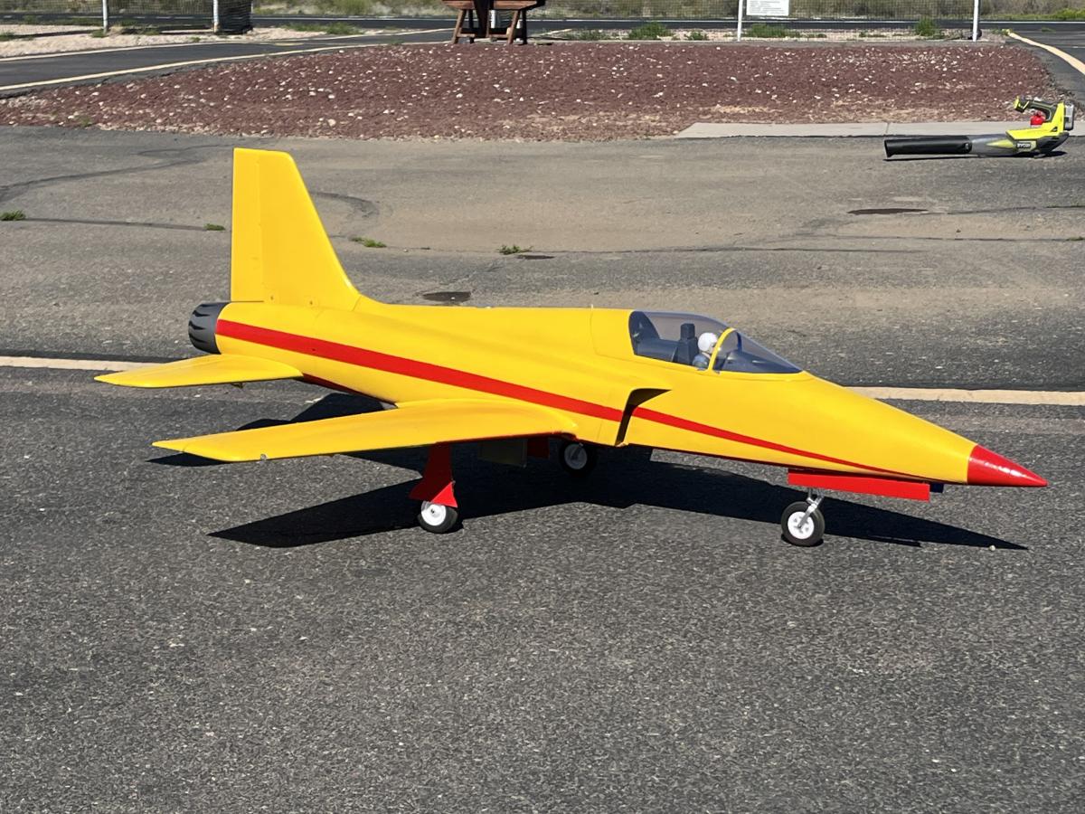

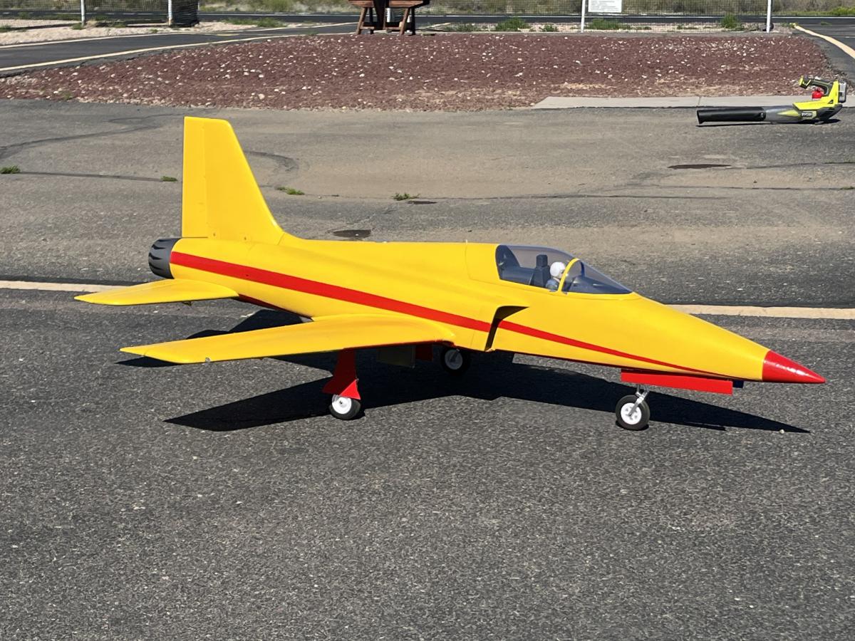

                              Getting to know my Zeus, but not loving the paint scheme (why they would make a plane the color of the sky is beyond my pay grade to figure out). So, I had to make it look like a Vulcan, best I could. This thing pops in the sky!
