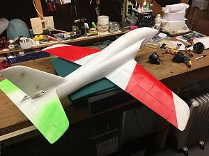

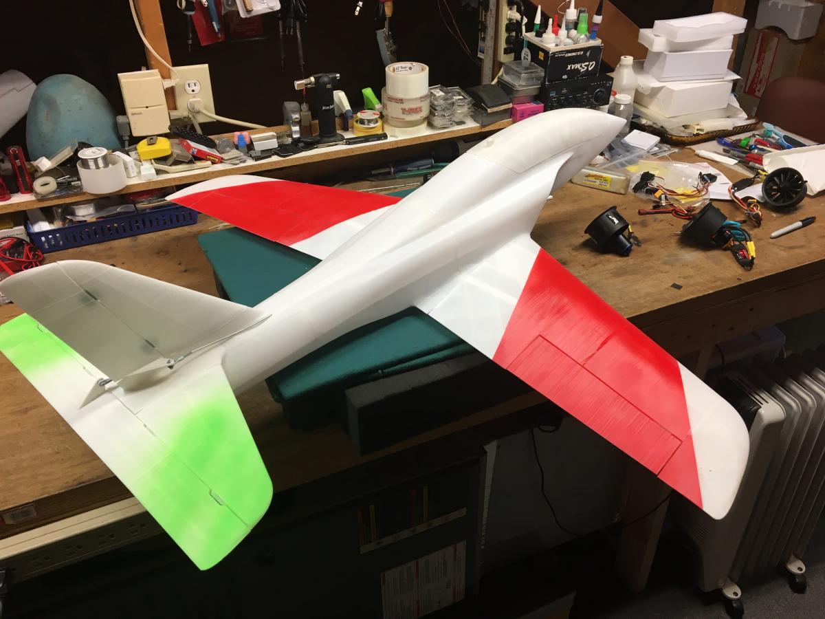

          My current experiment is with this 3d printed plane. Running the 2200 6S/ Beatles/ 2200 in it too.
          Click image for larger version  Name:	F0C4AA2E-BA51-4671-A563-344241A620C2.jpg Views:	0 Size:	117.0 KB ID:	392287

                  This is a resized 50mm EDF, a friend got it and the 50 flew so well I had him blow it up 127% to fit the bigger V2 FreeWing 64mm but reduce the wing a bit as its really big for a 64mm. Plus it was in old PLA and just not a great print. It turned out 127 was just a little too big so we are now printing another in three color polyair that should be a perfect fit for the fan, stronger and lighter.

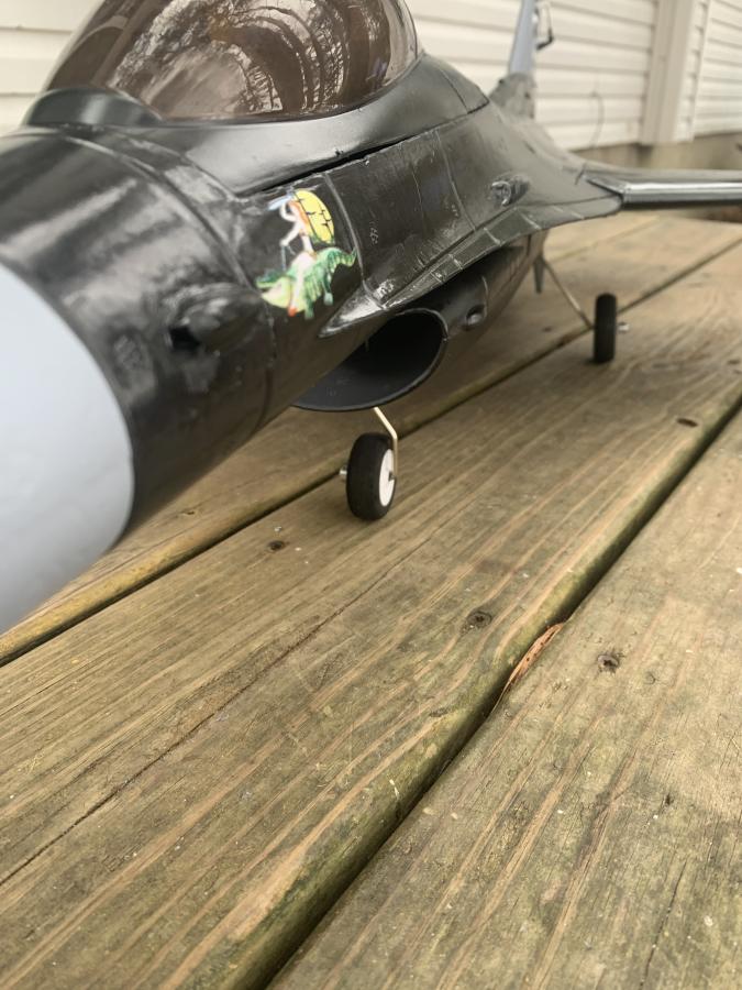

                                  Ok no FMS 64 EDF yet however the Freewing parts arrived so to the block I went fitting the 70mm EDF in the older airframe. Not bad or hard to do, I do believe in order to see any difference the area where the EDF body ends will need to be reshaped for the increased exiting airflow not to destroy the thrust. I’ll start on that tomorrow EDF installed will need to make a few brackets/hold downs as I had to cut the rear access hatch to fit the EDF and once again will need to be modified to keep airflow smooth as possible. Here’s a few pics and the ESC is actually a 60amp still for a F16 70mm will start the install there after I make a channel for the wiring to the EDF as it’s changed as well. So far a pretty straight refit I believe the EDF has to remain true in the airframe in order to really gain anything why I used the stock mounting holes only trimming the brackets wood slightly. Well this is long enough will keep up to date as things progress

                                        Ok need a little help on this one, EDF I’m good to go with however I purchased new balllink ends but cannot for the life of me find the ball link stops that screw into the control horns. I received a V1 airframe wings and rudder that I ended up epoxying the old ones on to as the plastic horns are super thin like my other planes. Don’t want to have to go through tearing my new one up to make this one fly any thoughts on what I can do here? I did reshape the area after the EDF have installed clear gorilla tape to smooth out the exiting thrust ( hopefully) about all I need still to do is make brackets for the access hatch to seal it better to the airframe. I’ll include a pic of the mod I did to fit the 70mm EDF, after install a few more servos and wait for better flying weather
