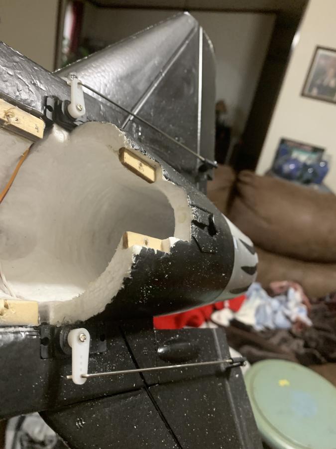

                    Ok guys 70mm revamped into the F16 64 throwing the Skywalker 60amp V2 in for Reverse. I reshaped how I did this one set it deeper into the airframe took more time smoothing the thrust tube area out. I do need to reconnect an aileron she will be up hopefully in just a few more days with updates once again. I’ll add some more pic shortly of how I did the EDF install this time much different than before should be a lot more secured. Happy Holidays all

                      How did you smooth the thrust tube?

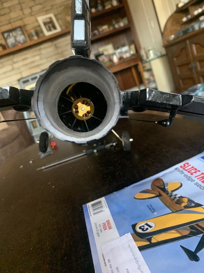

                        #71
                        I start with a dremel reinforced cut off wheel to get my general shape which is to cone from the EDF going about half way outward. After my basic shape I swap to a large sanding wheel just to smooth a little more followed by 120grit dry sandpaper. I’ll remove the EDF and take some shots to show how it looks I do both sides post and aft attempting to allow more undisturbed intake exit flow. I have also minwax clear coated the inside cone that actually made a big change in sound which is amazing

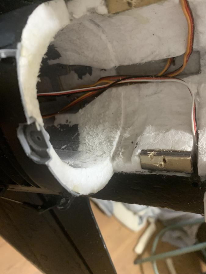

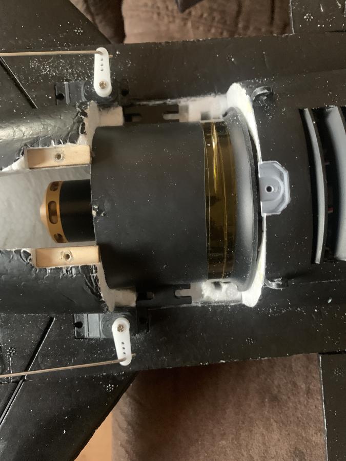

                          #72
                          Here are a couple of pics of the tube area the sand paper just gradually breaks the foam down adding the clear coat then hardens the foam back up. Hopefully since we have rain today I can get this wing servo hooked back up install the Skywalker 60amp V2 ESC finish the EDF wire up and have it ready to fly

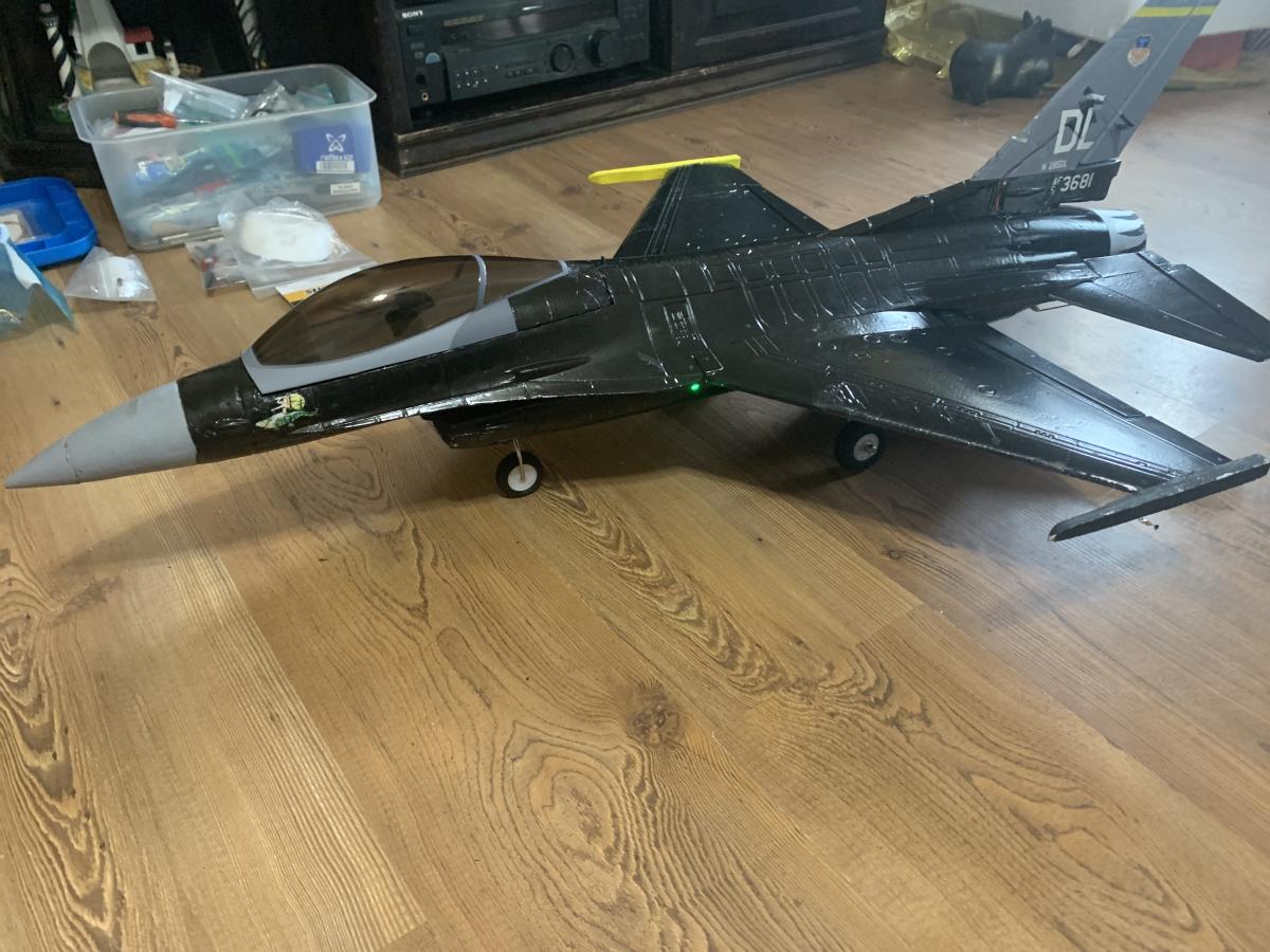

                            #73
                            Well success finally it is definitely faster the sound is soooo much better than the 64 non of the motor whine that’s normally heard. I am going to remove the second battery try to lighten up the front end only one flight so far managed 5 minutes ( not on purpose) with 10% left in a SMC 2600 pack. Had a few cars going by every approach I made think 3:30-4 flying mix will be just fine. I would like to do 2 small cheater grills in the top just to see if it makes any more difference. Will have my wife do a video for me this week and try to post here so far very happy actually think the next step is a 70mm 6s EDF just for general test purposes. Have a great day everyone happy flying
