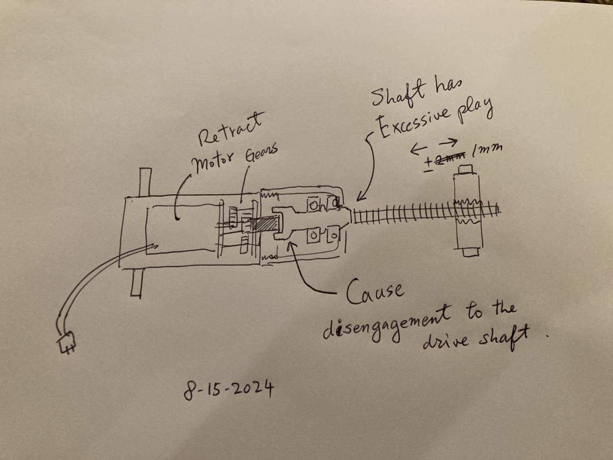

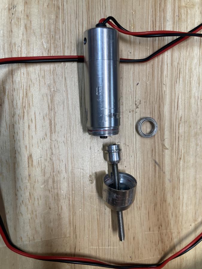

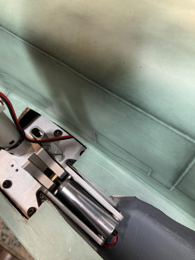

                    Resume MiG-29 this week after long delay. Found retract motor assemblies have fundamental design problems. Two out of three had failed. The motor would keep spinning and not able to drive the threaded shaft. Click image for larger version  Name:	1391D847-DAD2-4AF4-9C84-DDF925BB556A.jpg Views:	0 Size:	105.3 KB ID:	409048 Click image for larger version  Name:	560EB5C1-17EA-43B1-B319-6201E58D25EF.jpg Views:	0 Size:	88.1 KB ID:	409049 Click image for larger version  Name:	E7FCDD25-6B94-4654-A4E9-50A25CCB56B9.jpg Views:	0 Size:	96.8 KB ID:	409050
                    • Jeff C
                      • Apr 2024
                      • 7
                      #30
                      I believe the manufacturer need to fix this problem and provide the replacement retract motor assemblies to the current buyers. Also, for future buyers. Caution for the few that are already flying. The retracts may work now, but could fail and landing gears would not come down in your last flight.

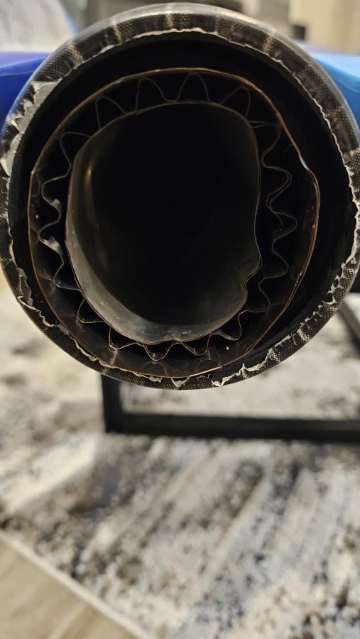

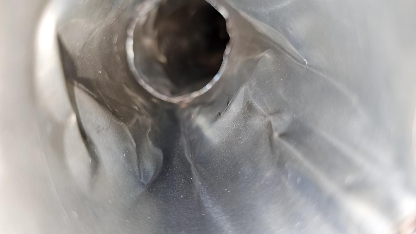

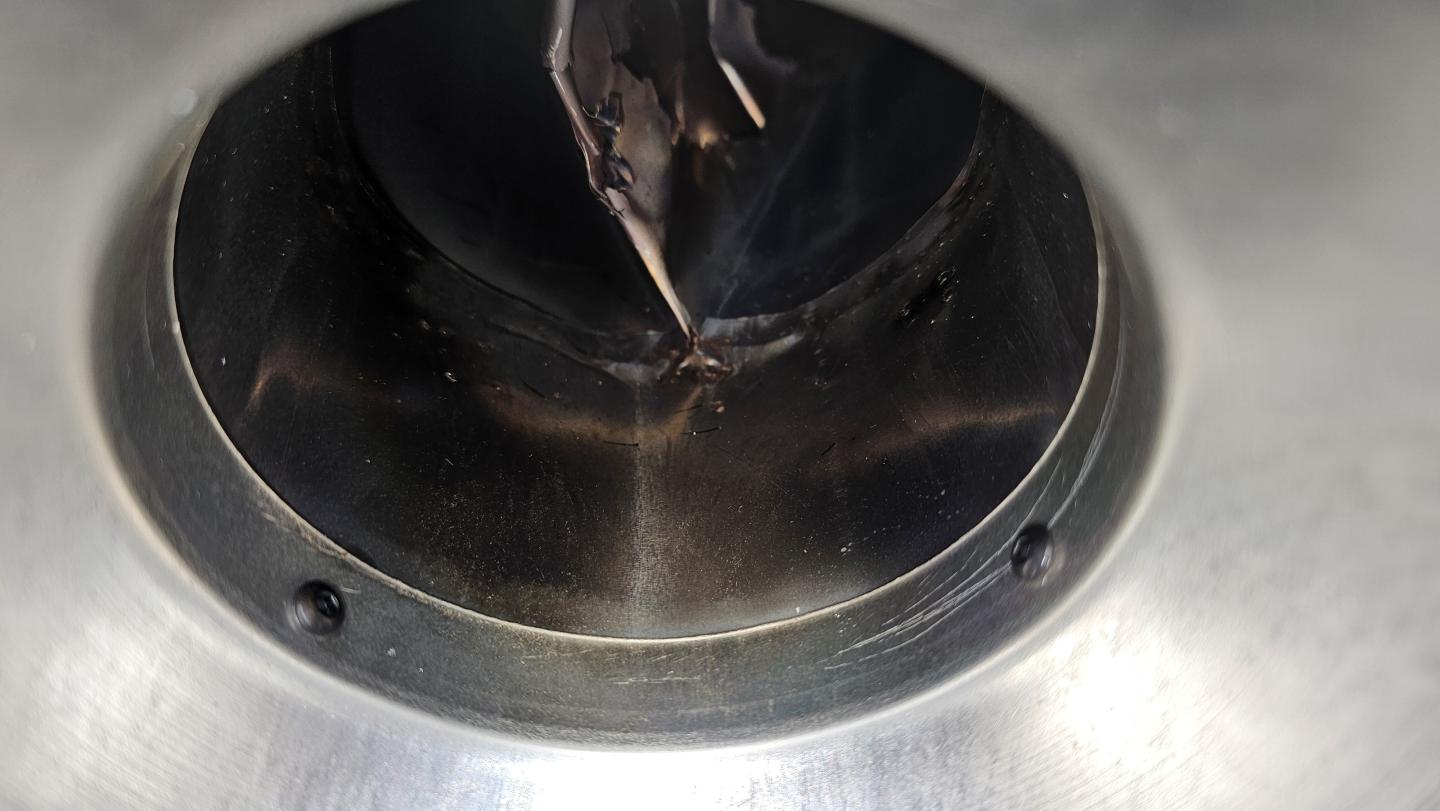

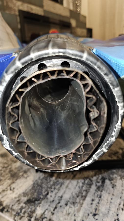

                        Hi guys, here is an update on my experience with my Mig - 29.
                        5 flights of 4 minutes each over 2 days and my pipe is melted. To date I have replaced 2 main retract motors. Main wheels and brakes with JP wheels and brakes because it had no brakes out of the box. Black Horse and Motion needs to do some extensive testing on this model and give a longer period of 30 days warranty.

                          This pipe issue looks terrible. I have just finished mine and am ready for maiden. After some testing the breaks are so week they will not even hold the plane at turbine idle. I bought JP 75mm wheels+break assemblies to replace. Does anyone know where to source a different pipe?

                                        He volado eL mig 29 y no lo aconsejo a nadie....soplo me ha durado 8 vuelos...el escape de gases en Y se rompio y me quemo todo el avion....y hera el segundo escape en Y que rompia
                                        El avion es muy bueno...volaba muy bien, pero en este modelo lo que falla es el escape en Y... con una turbina de 13 kg se rompen todos
                                        NO SE LO ACONSEJO A NADIE
