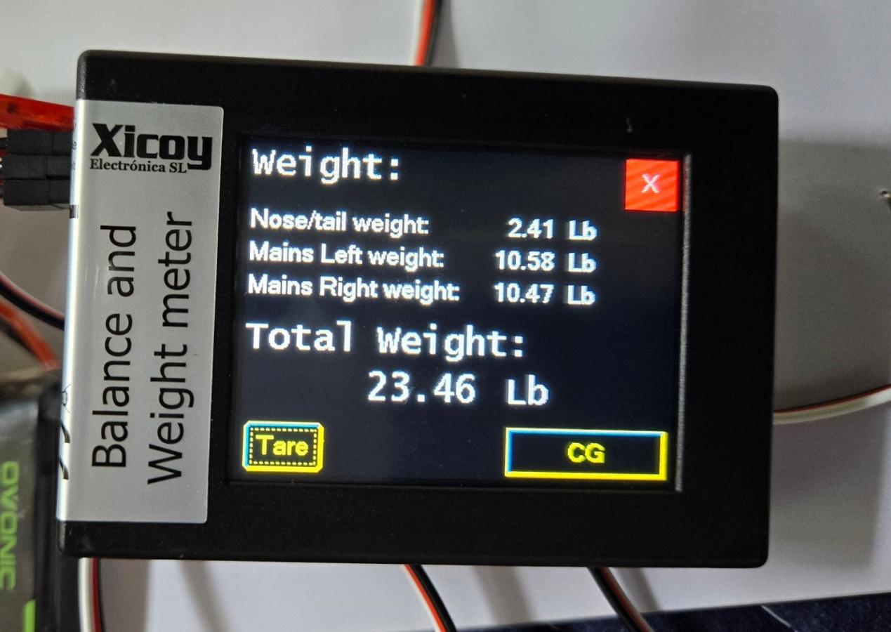

                                      Hi Jeff,
                                      I am in build process and should have it done in a week or so. Trying to decide if I should go with K-142 or Jet Central 160.
                                      Have you flown yours yet? If so what did you find on the neutral position of the elevators? What size turbine did you use? Any feedback is much appreciated!
                                      I don't trust the spec or turbine recommendation on MotionRC website or BH site. They show it weighs 27 lb. I put mine on Xicoy CG meter and it is 23.46 lb dry with 160 turbine. Tanks combined are 4,200cc which is about 9lb,so it is about 33lb wet
