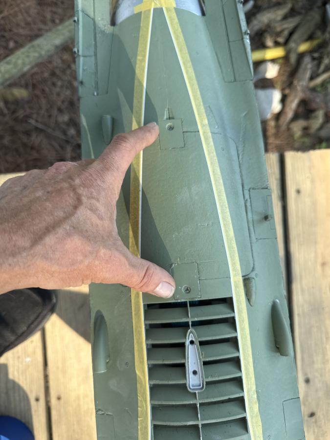

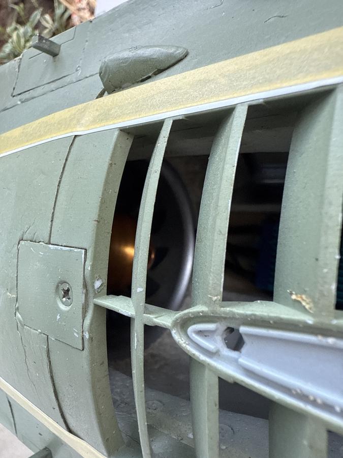

    Here ya go super easy way, here are the 2 screws remove thin straight blade or whatever both areas rock lift until it comes loose. All of mine have been sticky the first removal

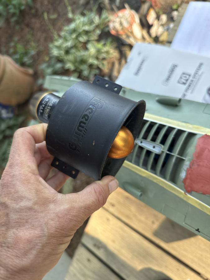

          Both my 6 and 8 came with the blue.
          Originally posted by shortround91 View Post
          The ESC should be Blue ( hopefully) and just look inside the bottom cheater if the housing ( EDF ) is black that’s 6s if it’s metal ( silver ) it’s 8s

              On both my 6 and 8S the ESC was blue. Looking back I don't see a question I didn't answer. Looks like I was also the first to respond...
              I was wrong about the only difference being the motor, as shortround says the housing for the fan is silver on the 8s and black on the 6s.
