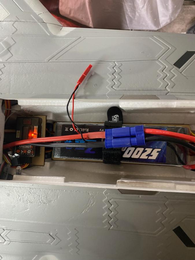

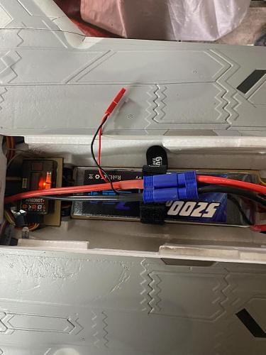

ID:	433224 My friend has bought this 80 f22. And he is not sure about a wire.. it's a negative and positive. Around 1 mm in diameter. At the ec5 end( battery). Going into a red joiner

                                Click image for larger version  Name:	IMG_1873 (1).jpg Views:	0 Size:	66.5 KB ID:	433224 My friend has bought this 80 f22. And he is not sure about a wire.. it's a negative and positive. Around 1 mm in diameter. At the ec5 end( battery). Going into a red joiner
                                I just purchased a set of twin ESCs from RC Castle. On the power lead (Y'd together from the 2 ESCs) was this very same red connector. Plugged into it was an external BEC. You can see it here:
                                 - Suitable For FMS SU-27 & Other Twin 70mm EDF Jet.- Extremely low internal resistance.- Super smooth and accurate throttle linearity.- Size: 86 x 38 x 12mm ( Lx W x H )- Continuous current: 80A x 2- Peak current(10s): 90A x 2- Battery: 2 - 6 Lipo / 5-18 NC-
                                The "center burners" I usually get are plugged into the balance lead of the battery, and generally tap into only 3 or 4 of the cells. "Afterburners" (ring type) can be plugged into that lead as they can take higher voltage.

                                      Antholy has said the JST is for their new AB module. Obviously it can also be used for other things.
