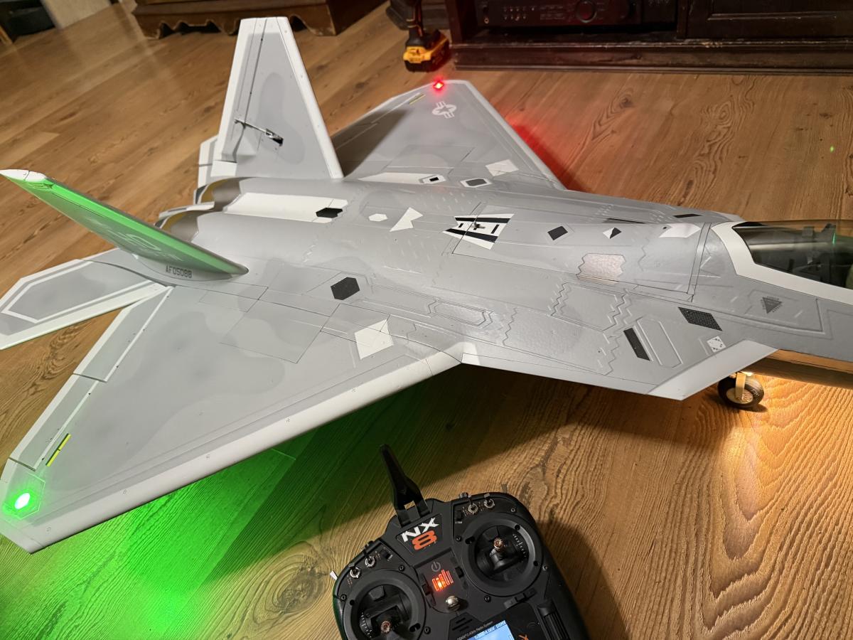

                      I have made a cheat sheet to setup a new aircraft.. See step 17 about setting up flaps on my NX8 transmitter. Hope this helps.

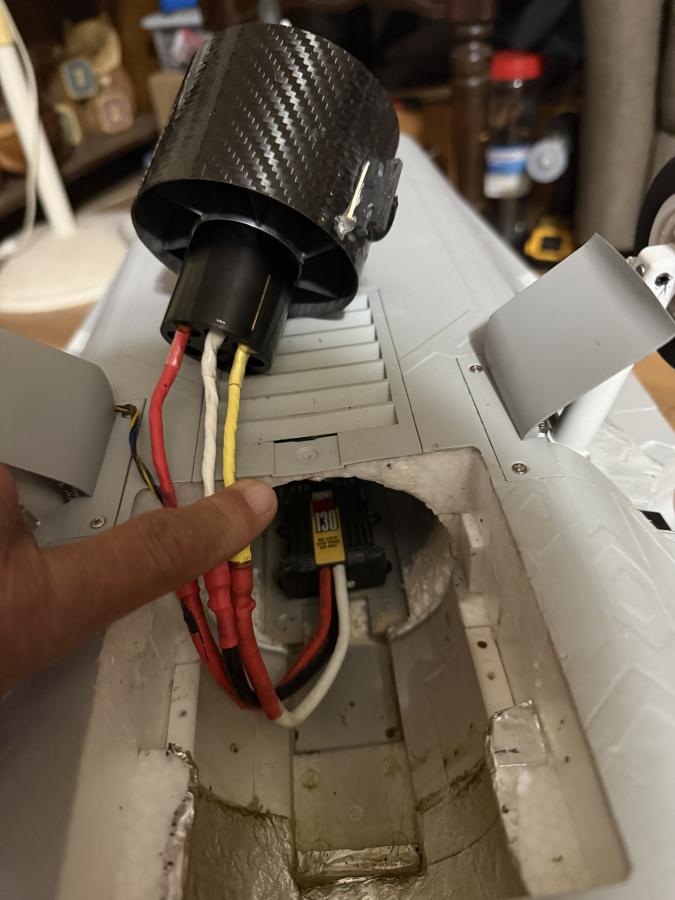

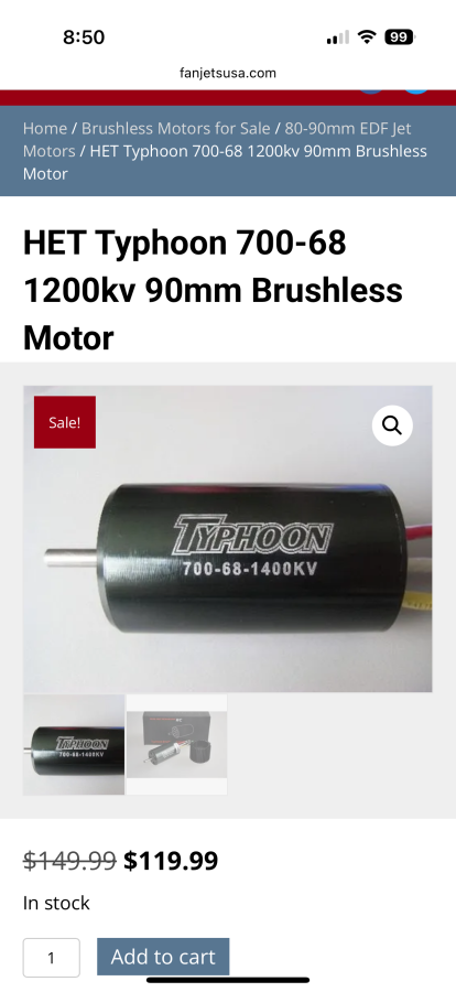

                            Been once again upgrading my 80m F22, not that it flew bad stock but who doesn’t want more. So more I went, added a JetFan CarbonFiber housing along with a 6-8s typhoon motor. Running duel 4K 4400 up to SMC green label 5200’s. The extra weight didn’t hurt a thing 4min flights still along with 152mph speed runs ( level to slight dive ). I own the 64 a few 70’a the 80 and a 10s 90 F22. Have to say the 80 is actually a sweet spot for me, love my 10s 90 it’s just hard to transport have gotten spoiled but quick disconnect wings. FreeWing Motion keep em coming please. A revamp 80mm F14 and 90 Raptor are way overdue and yes some of us like 10-12s hint hint even if it’s a upgrade

                              ~150mph on 8S? You have my attention! Would you please elaborate on the specifics of the fan, motor, ESC and battery placement?

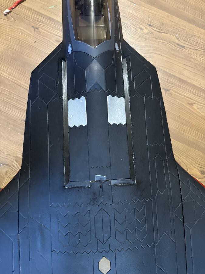

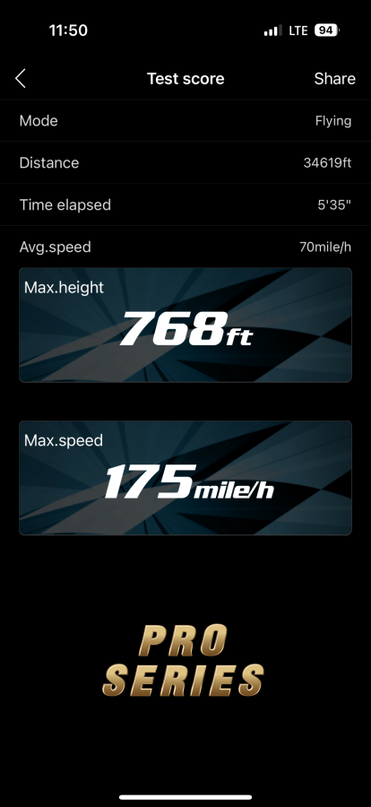

                                When I was 8s replaced the ESC with ZTW 130a HiVoltage honestly other than that she is stock EDF ( FW ). I’ve since gone to 10s same ESC with a JetFan HET motor and have GPS’d 175mph on a slight dive. We are a 800feet approved club so no hate comments please, my latest mods are carbon over servo rods aileron and elevators along with adding carbon edges to help stop foam damage around the battery hatch area

                                  I tried my first 90mm on stock 6S and Jet Fan/ HET 8, 10 and 12S. I felt that 8S was the best all around. My 8S went a paltry 126MPH. Are you saying the 80 on 8S got to 150+? I know stock it feels the slowest of my 70, 80 and 90.

                                    That's pretty amazing. It's as fast as a 12S Zeus, a plane that's designed to go fast.
