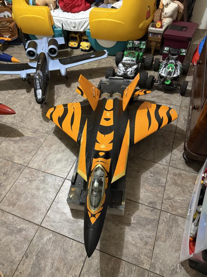

          Ok the canopy isn’t glued on all the way comes off really easy, hobby knife under an edge peel carefully. Mod wise for my tailerons as always, went to a JetFan 8s set up with a 120a ZTW esc along with a new custom paint scheme. My older eyes can have some issues in certain maneuvers with origination

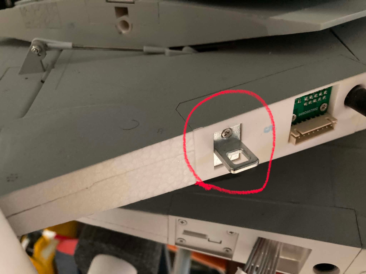

                          Any chance someone has these T shaped metal wing connectors around from a crashed aircraft? I’m hoping to use them as part of a scratch build project, but they don’t seem to be available anywhere.
