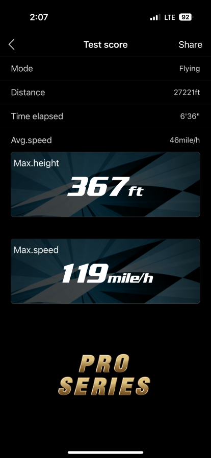

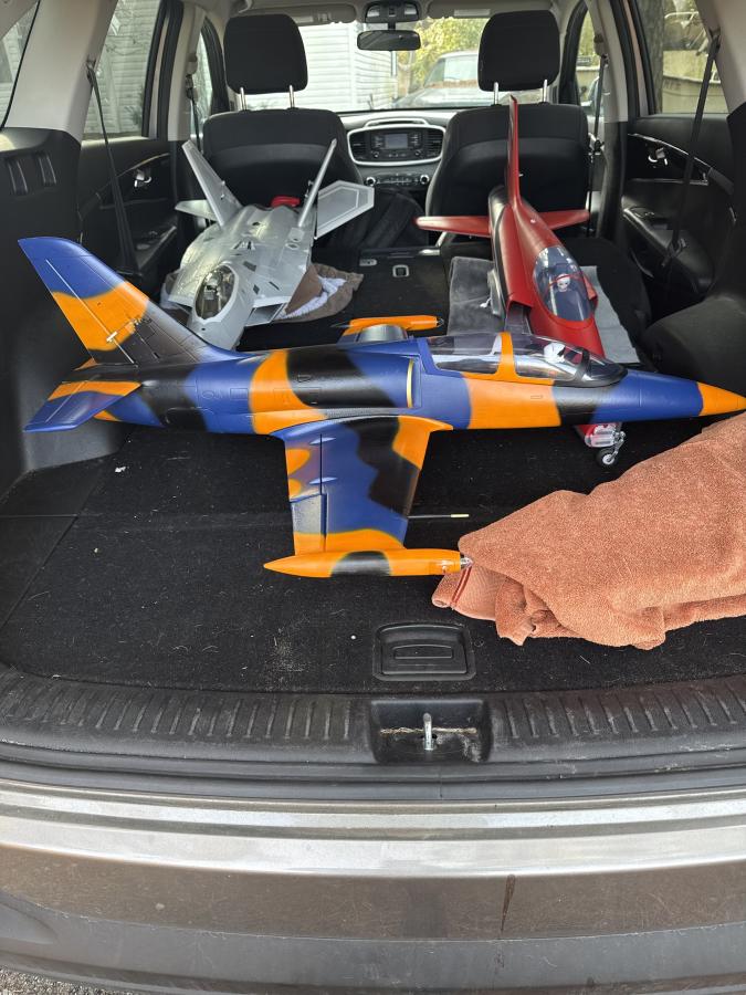

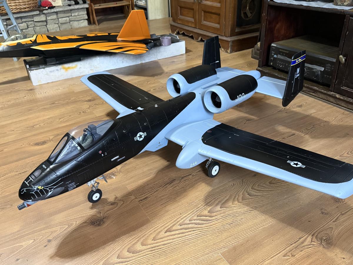

I had these 2 fans for the Banshee both inrunners also, they definitely are powerful. Removed the stock outrunner from my 64 L39 installed a 65amp ZTW ESC she went from top speed of 93mph to 119mph GPS’d with witness on a slight dive. Freewing did an excellent job on those fans. Working on a new paint Scheme for the A10 currently can’t wait to finish her upComment

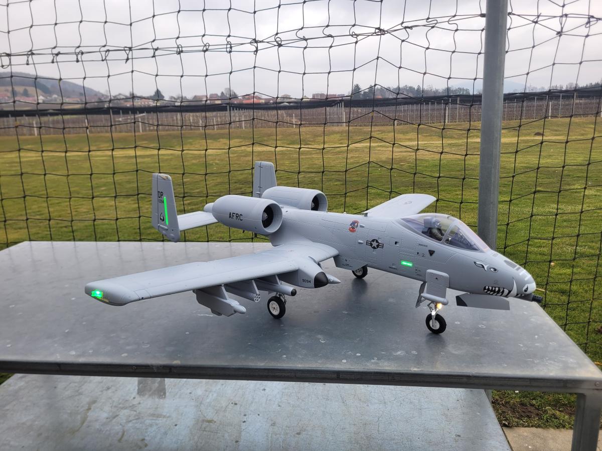

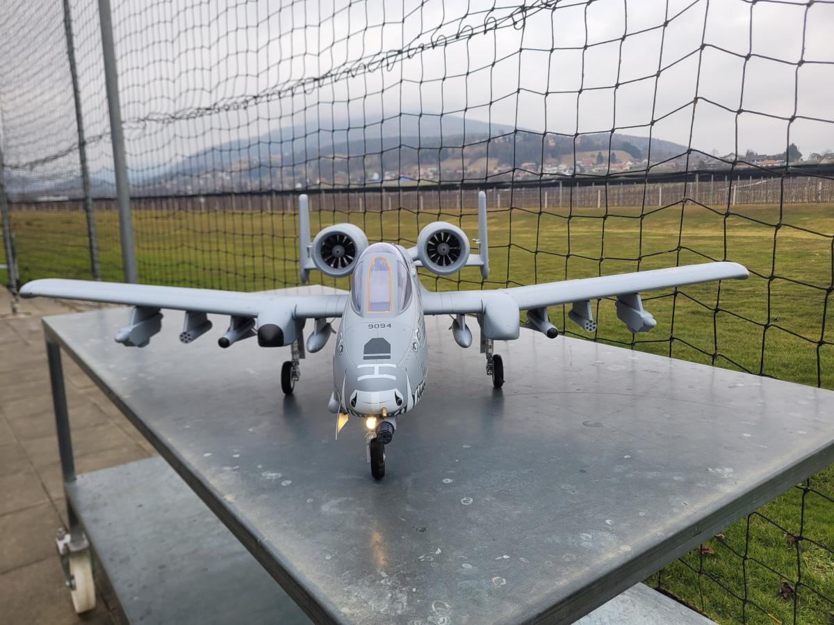

Maiden flight today here in chilly Austria. What a fantastic aircraft! No unpleasant characteristics whatsoever. Takeoff from a damp grass runway was absolutely trouble-free. The flight characteristics and the LED lighting are a dream. Not a high-speed jet (it's an A-10, after all). 91 km/h (56.5 mph) with full armament.(6s4000/50c)

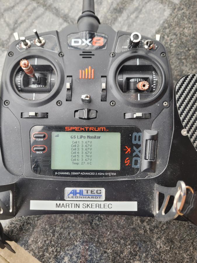

108km/h with a spektrum 6s5000/30c without armament.Only the landing flaps require a bit more down elevator input. The flight times are also OK. With a Spektrum 6s 4000mAh 50C battery, flight time is 4 minutes(fast flying). With 3.67V per cell after landing. Definitely my favorite jet.Comment

I’m always max throws on elevators to me it’s much easier to add expo or use less stick. I fly mine slightly nose heavy on higher winds and of course slightly tail heavy on calmer days. I have 2 one I installed the FW inrunners on then this one stock except the paint scheme but have never had any issues getting up. I do like to get good ground speed on the A10 before rotating but she’s just a awesome plane to flyComment
