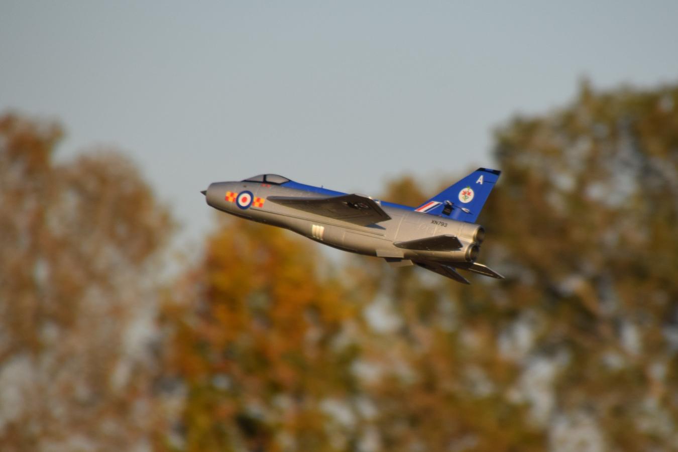

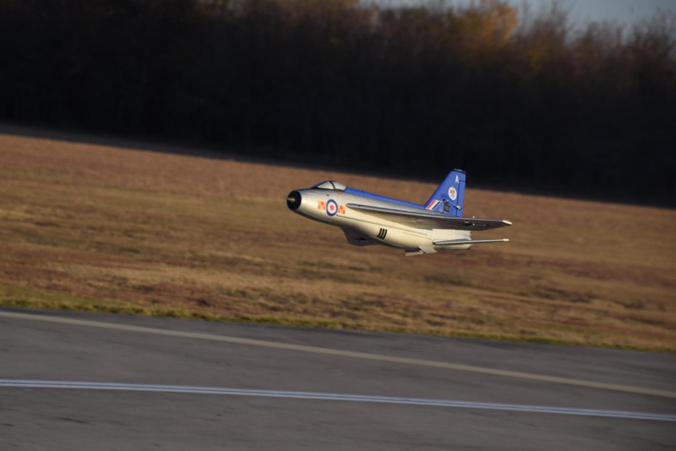

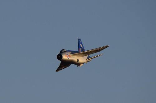

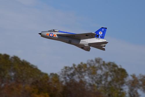

                          I was excited to see that FW had done such an interesting jet in 64mm. Have always liked the Lightning! A very iconic cold war jet.
                          I ordered one the day the model was announced on Nov 7. It arrived on Wed Nov 12, on the third day after it was shipped. I very consistently get my MRC orders 3 working days after I order. No signs of MRC slipping from my viewpoint.
                          The instant response from many people is that this jet is too small and should have been an 80 or 90mm offering. I respect that opinion, but still like this small hand launch version. Very fun and affordable.
                          The price is a little more than the previous 64mm hand launch jets, but it has some nice upgrades. 4s 64mm 12 blade fan system instead of the old school 3s 64mm 5 blade fan. Includes the landing gear, so no need to order it separately if you need to use it.
                          FW did decide to not include a clear canopy. That is my only design complaint. There are some minor scale deviations here and there, but the model is great looking overall. In any case, you can't see the cockpit in a 90-100 mph flyby...:)
                          My only cosmetic complaint is that it arrived with a lot of mild to moderate gatoring. The theory is that the factory sometimes removes the foam parts from the mold without enough cooling time, causing the gatoring. My flying buddies Lightning had far less, practically zero, gatoring.
                          The model was VERY quick to assemble. You do have to apply the upper wing roundels and wing walk lines.
                          I used a 4s Zeee 2200 120c lipo. Control is via a AR400 RX and my DX9 Black TX. No gyro at this time.
                          The only setup complaint is that FW has the elevator linkage as installed moving the full flying tail far to much. I rated it down for now and will improve it linkage wise later.
                          Ended up doing the first two flights yesterday.
                          My Lightning was easy to hand launch and had plenty of power to get up and away easily.
                          My first flight at the factory low rate throw suggestions was overly sensitive on ailerons and elevator, IMO. After landing, I went to 40% expo and reduced the low rates a little. Second flight was great, very groovy. Did the usual small jet aerobatics. The stab is powerful and the model loops with ease.
                          Landings are a non event in the grass.
                          The model presents well in the air, as you can see from my pics as well as the ones on the MRC web site. My flying buddy Mike R. (F106DeltaDart) took some awesome flying pics of my model on flights one and two yesterday.
                          All in all, a great little model and lots of low stress scale EDF fun!

                            Nice photos.

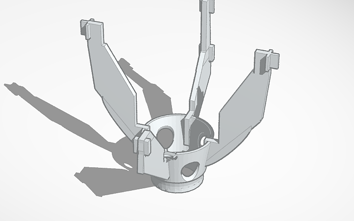

                                        The afterburners were a lot of work. First, the EDF unit is glued in place and it took a lot of pulling and tilting and twisting to get it out without damaging the fuselage.
                                        Then the outrunner makes it almost impossible to use a "normal" lamp mount to the back of the motor, and running the mount around the outside to fix it to the fan case would make it excessively obstructive to the airflow, so I decided not to do that.
                                        So I made a lamp mount that goes right behind the motor, streamlined with it as best I could, and located in the exhaust duct itself rather than attached to the motor like a normal installation. Because of space constraints on the 64mm I went with a single lamp (I normally use two on a twin).
                                        Click image for larger version  Name:	abl.png Views:	0 Size:	96.2 KB ID:	440550 .
                                        Limited access to the space made it a challenge to measure the dimensions needed, and to get everything aligned and glued in place. It took four attempts until I got one that fit properly and aligned exactly. After that, running the wires to the controller in the battery compartment was a piece of cake.
