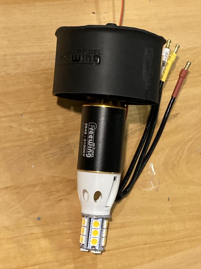

In previous models Lippisch etc i used a cheese wire to remove the edf unit slices through glue easily but wear gloves
