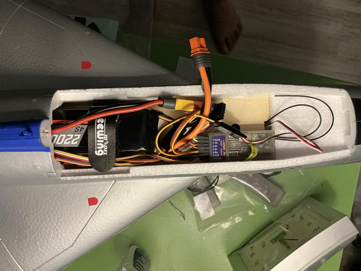

    Looks fantastic and a different idea with the two seat conversion. I moved the lead from under the lower exhaust ring, I thought I would need more because of the move forward but a reshuffle in the battery compartment seems to have resolved it.
    Can't push my 2200 4S battery further back, but is balancing OK with the leader I've added, plus with the FPV gear in the area behind the canopy has moved the CG forward.
