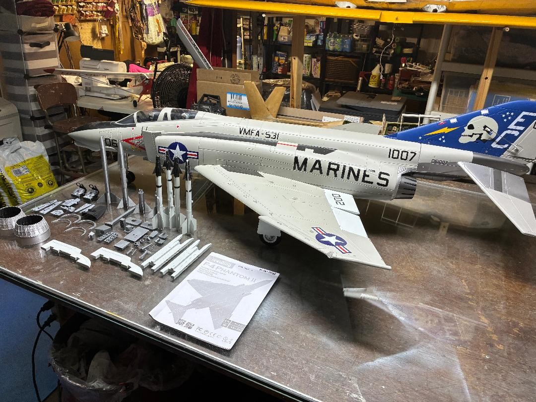

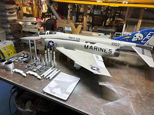

    Going to modify and repaint my new 6s F4 Phantom into the Sundowners scheme. I have several 3d parts to add for more scale version. First thing I plan to do is strengthen the elevator pushrod with 4-40 rod. Hopefully you will follow along and give me your pros and cons on this re-do. Plane was assembled and checked to make sure everything worked the first few days after delivery from Motion R/C. Now I'll disassemble it and start the process. Plane weighed 5.7 lbs. without battery (stock configuration). Here's a few photo's of parts to be added.
Name:	tf4 1humbnail.jpg
    Best Regards, Rex

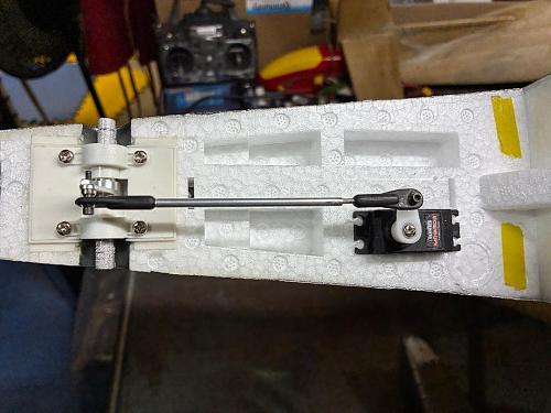

      Beef up the elevator’s ball link and servo clevis link - heavy duty!!! And consider installing a higher quality elevator servo. I had a stock servo fail with bad results.
      -GG
      • jetfool
        • Nov 2022
        • 1335
        • Crawfordsville, Indiana
        Thanks Glider Guy. I will check out the chokes and I am adding 4-40 wire elevator upgrade. Will add Hitec servo. Better safe than sorry.
        Best Regards, Rex

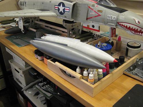

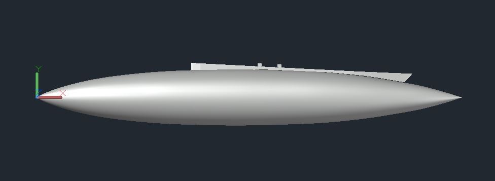

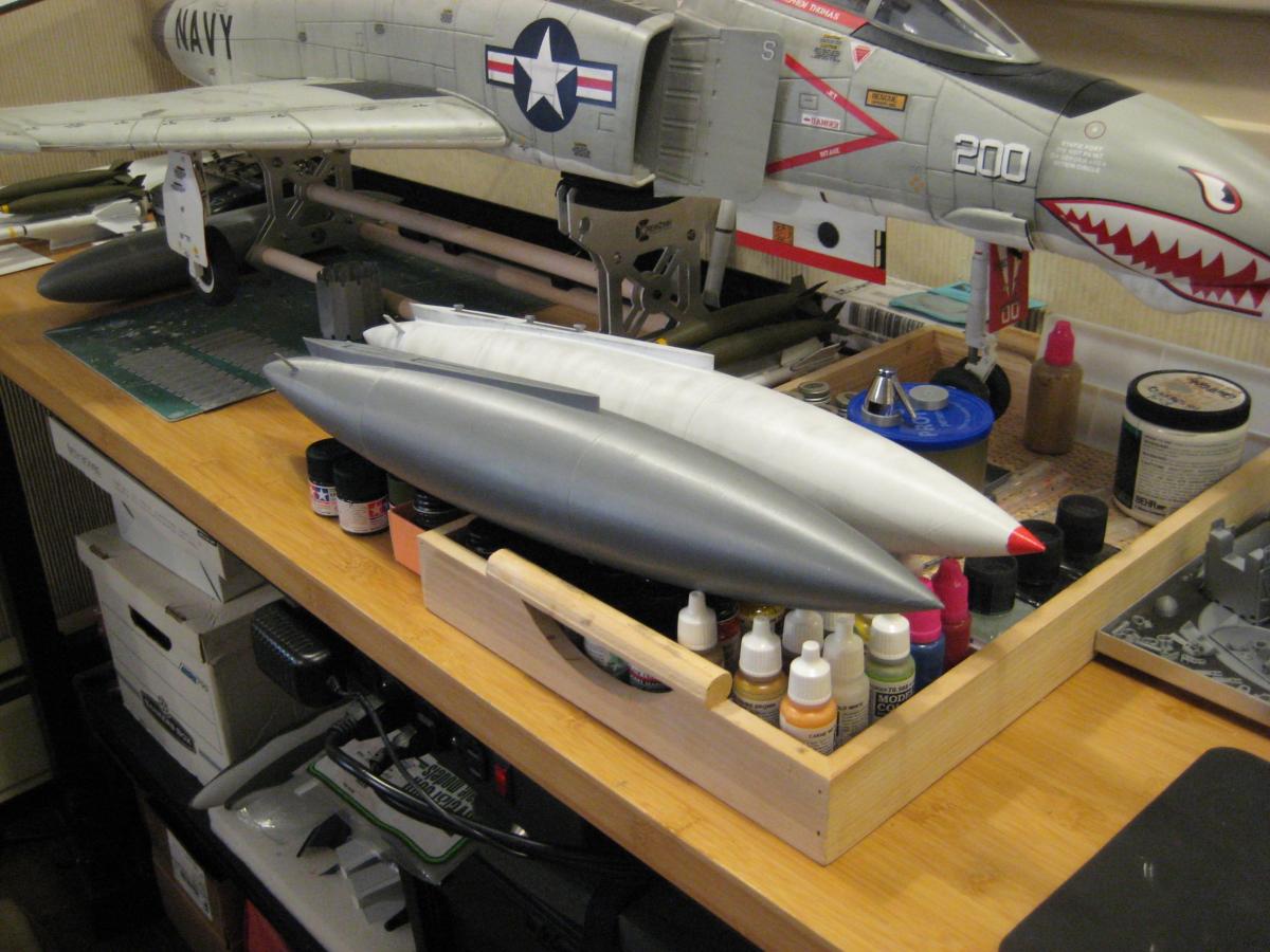

                This is the 600 gal Centerline tank I printed for my Phantom..
                It was designed by apmech1 .
                It is perfect BYW for your Freewing Phantom.
                The file is too big to send through HS, I will email it to you, as well.
                Best, LB

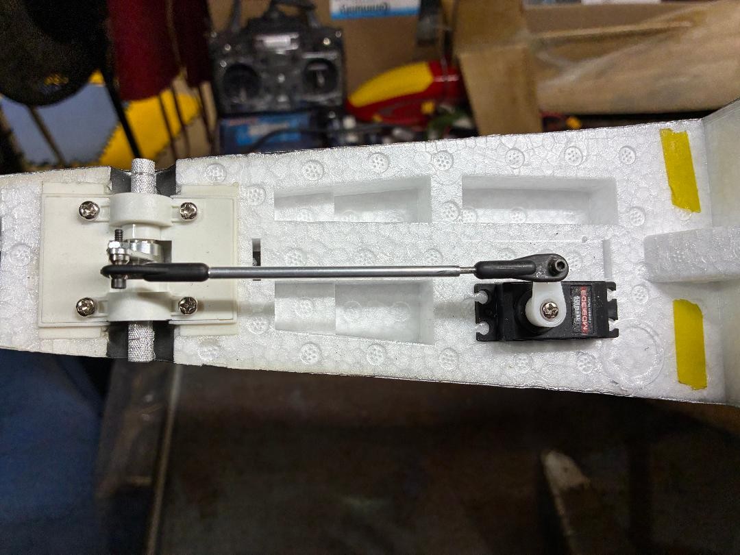

                  If I use a 4-40 ball clevis on the elevator I would need to drill for a 4-40 bolt, a regular 4-40 clevis has play because the original hole is larger. A new hole wouldn't leave much metal around the hole. If I use a 2-56 ball head clevis and a carbon fiber rod over the linkage it all fits the original holes after tapping for 2-56 thread. I think the 2-56 set-up would be ok. Everyone's thoughts please.
                  Filling all the non-scale holes, manufacturing processes just because they drive me crazy and looks better after painting.

                    I went the 2-56 All thread/Ball-link/Clevis and carbon fiber tube route.
                    Works great with end point adjust,
                    Best, LB

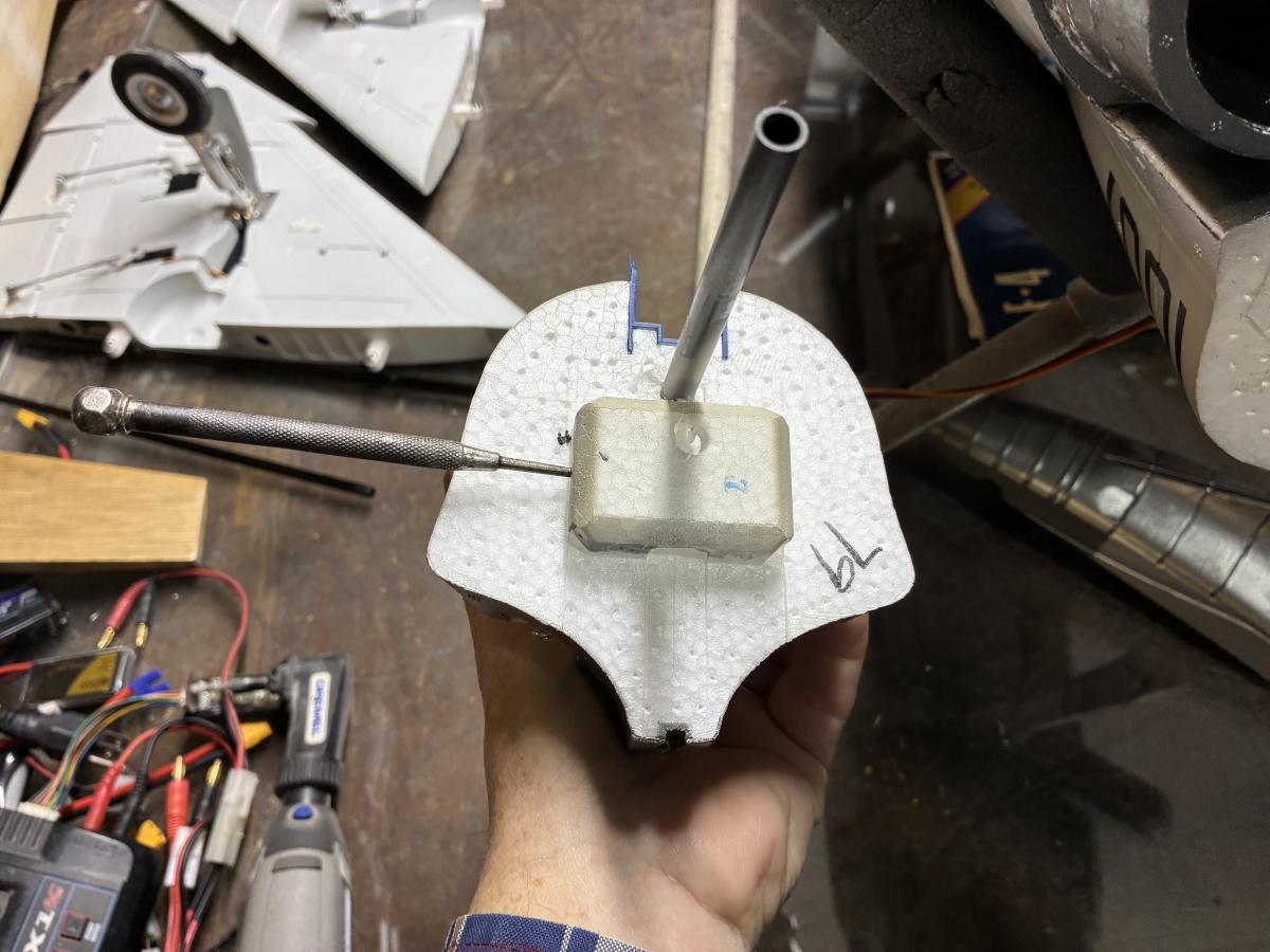

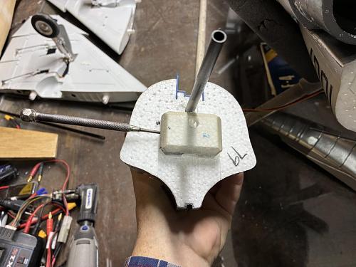

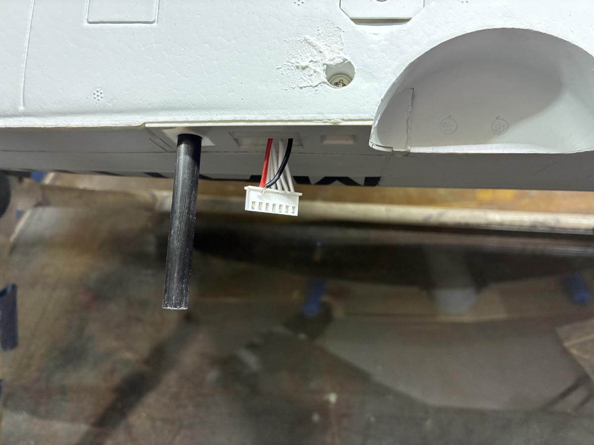

                      Using 2-56 ball links and an alum. tube over the linkage (my carbon rods were too big). This is a lot stiffer than the original. Factory linkage is ,059" versus 2-56 at .074" plus the alum. tube. Need to order the Hi-tec servo.
                      Best Regards, Rex

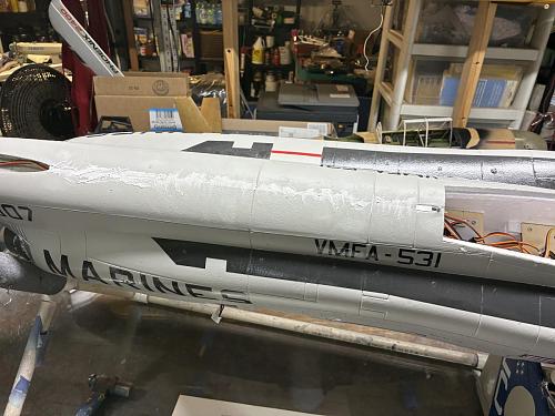

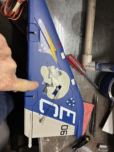

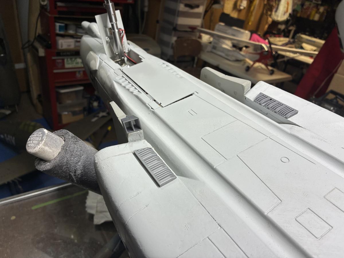

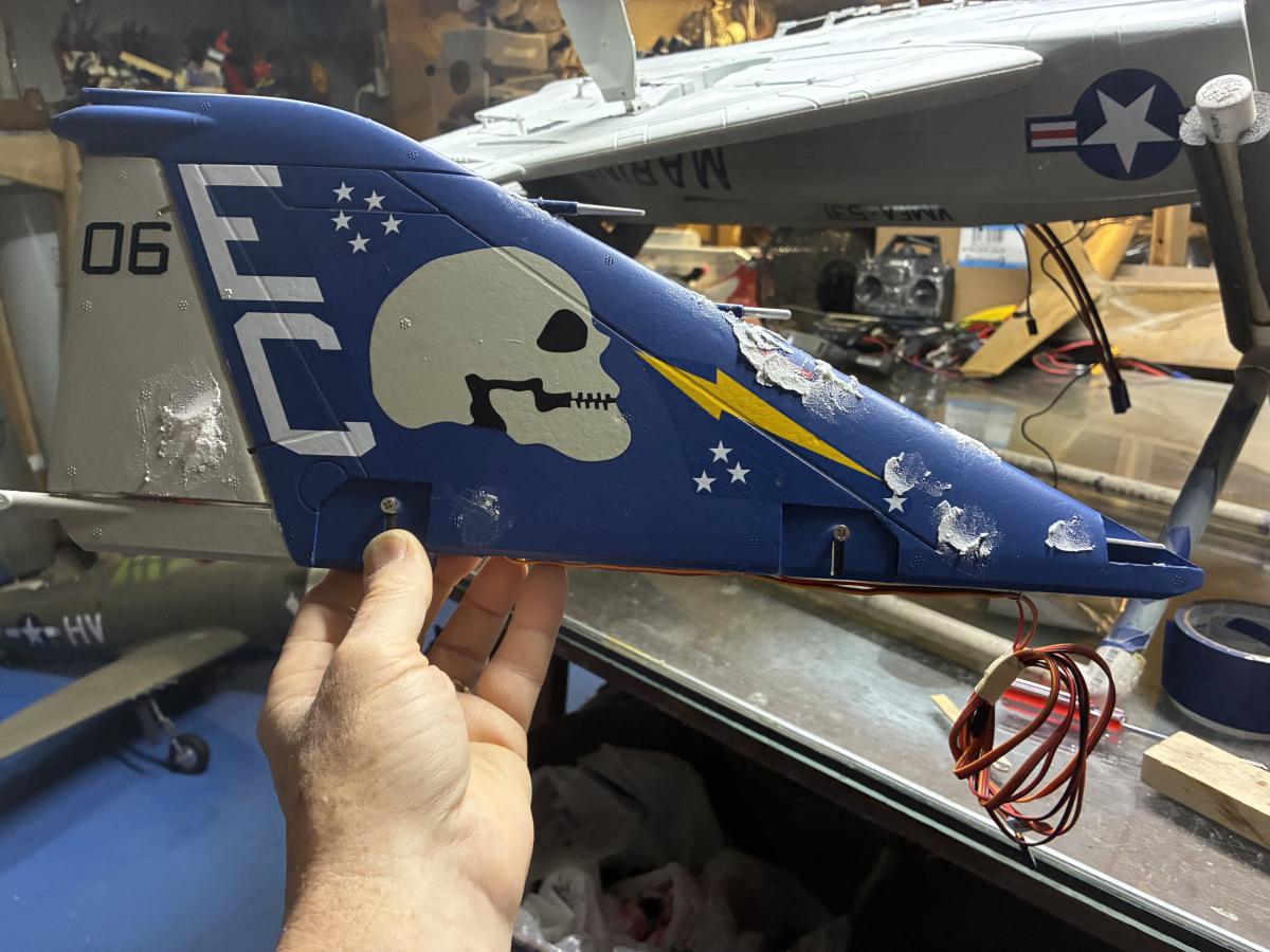

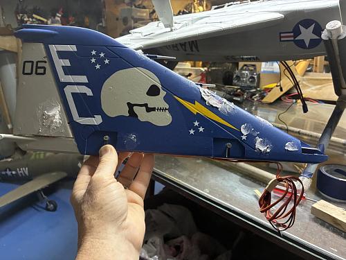

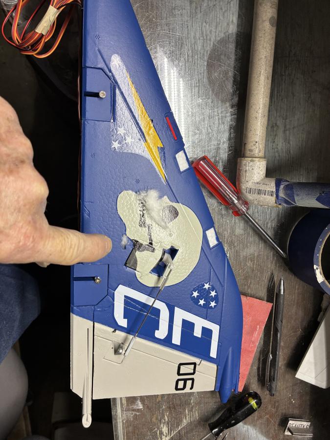

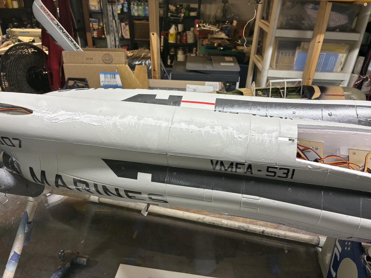

                      Today with snow falling and no need to go anywhere I spent the time spackling the non-scale holes, removing OEM turkey feathers and pre fitting the 3d exhausts. Want to install the retracting Tail Hook while I'm at this end. Good thing I disasembled the plane because I found the black wire had pulled from its wing connector socket. Might have been a bad day if I had flown it.
                      Best Regards, Rex

                        Used cotten to push in servo wire hole before putting spackling over. if need to remove servo I just take out the upper layer and wire comes out.

                            Nice catch on that black wire. you avoided some type of issue there.:face_with_monocle:
                            Spackle Party:partying_face::partying_face::partying_face:

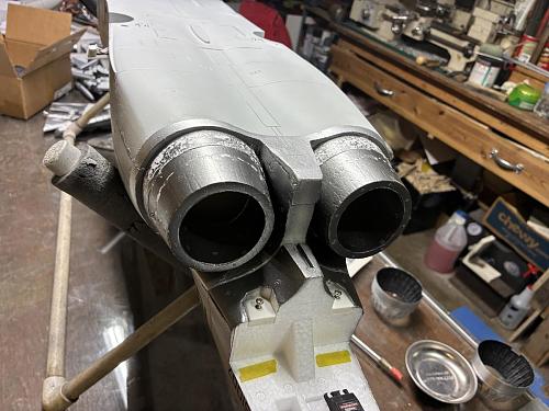

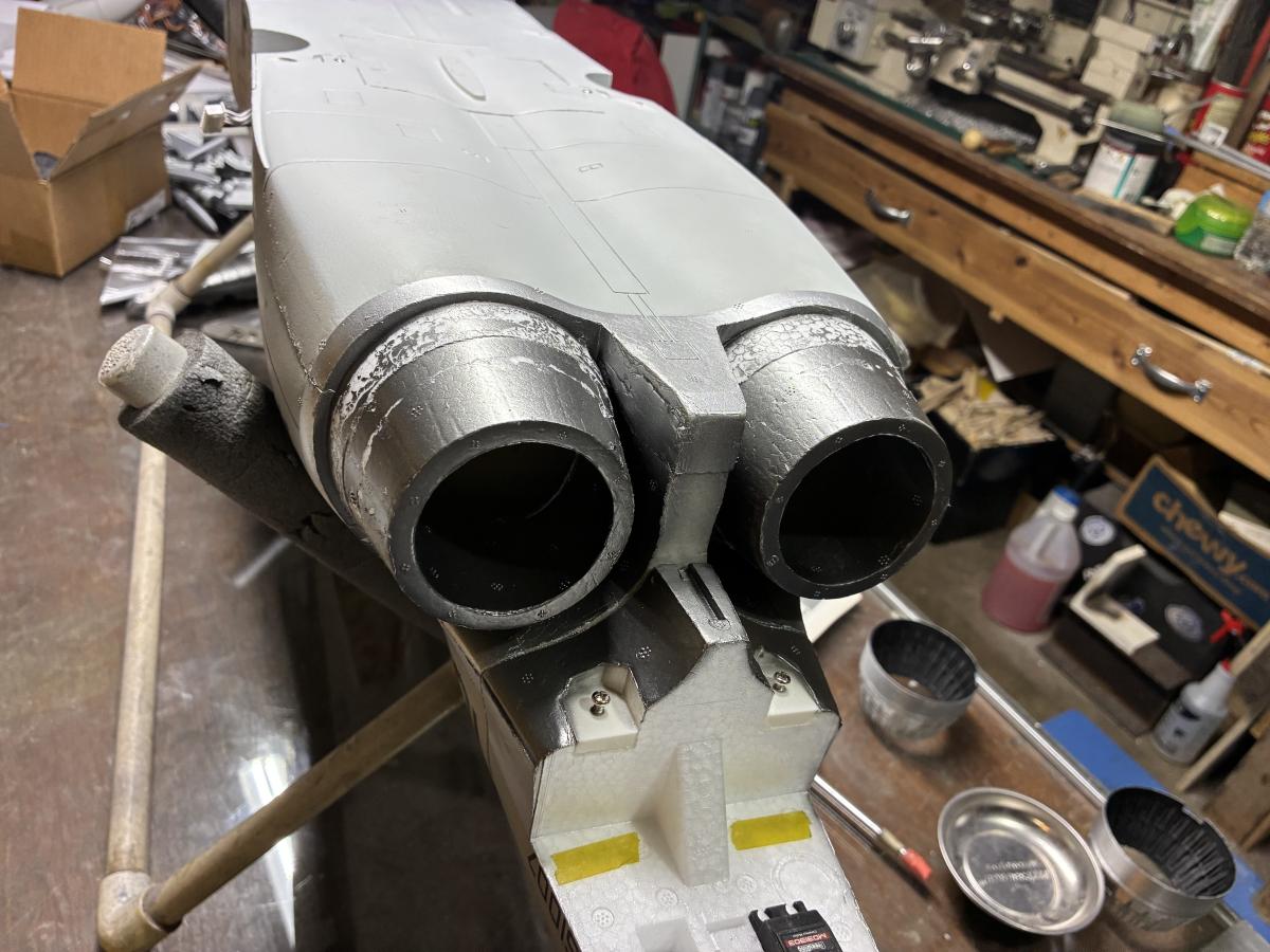

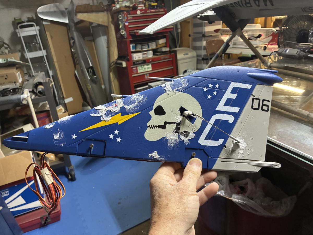

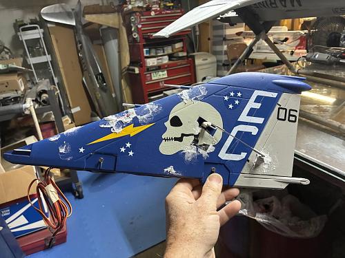

                                  From James past assemblies I glued the tail to the fuselage. Poked holes into mating surfaces with an Awe before gluing. More spackling and I installed some styrene strips around the hatch latch to bring it level with the fus. I have applied 3 coats of poly-acrylic to the stab. sanding between coats w/320 paper lightly. It is starting to get smooth and level for the primer.
                                  Best Regards, Rex

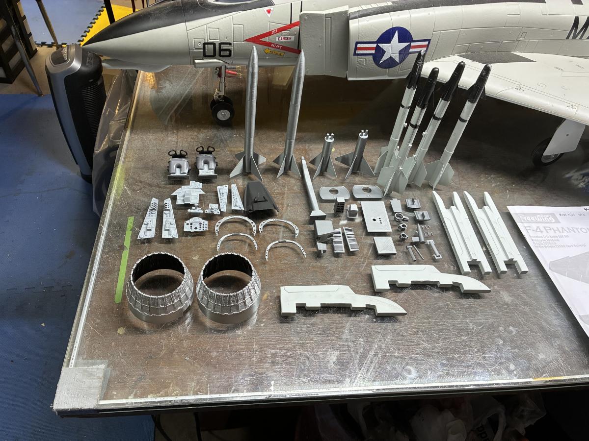

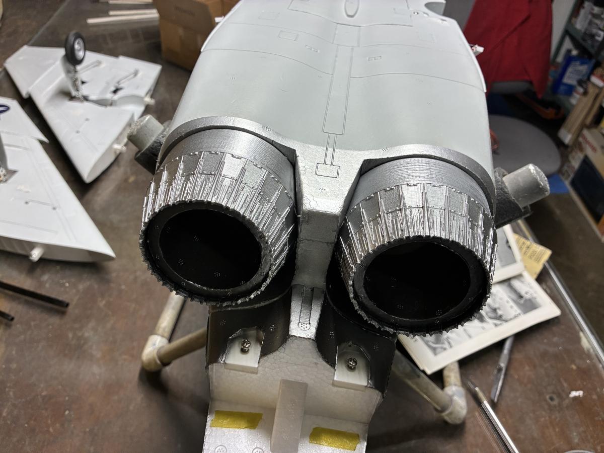

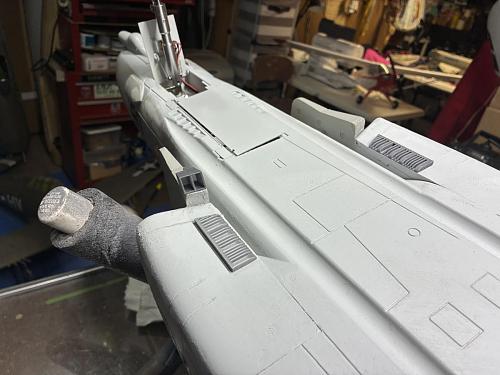

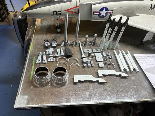

                                    Just placing some 3d parts where I think they go. Looks like some cutting and fitting required to get them flush. Wondering if I should install now or after the poly-acrylic coats. Decisions!
                                    Going to take a coffee break and look back thru the original posts for Elbee's tail hook installation.
                                    If this is all boring to everybody please advise.
