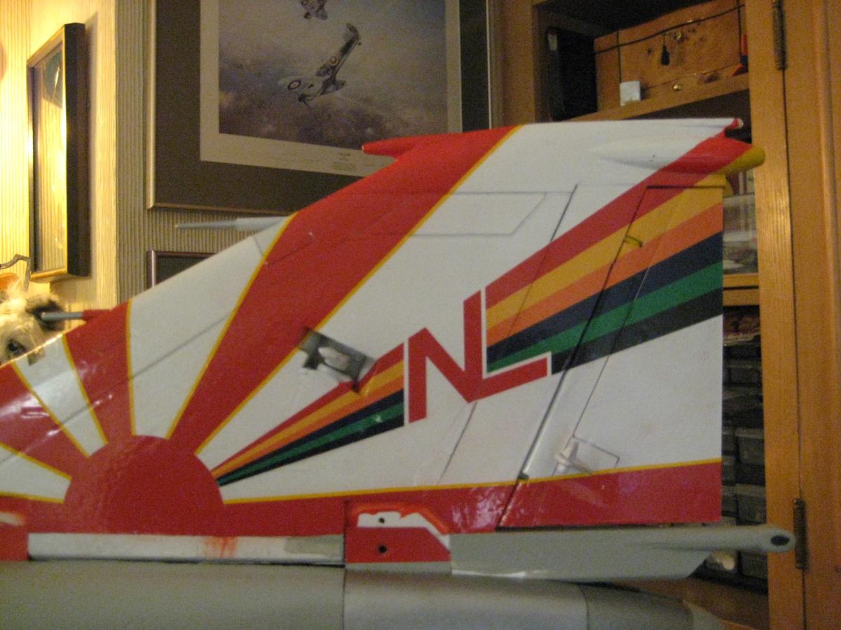

      Rex, Firstly, your fill, sand, prime is paying dividends.
      The vertical does not look 'foamy' at all, well done.
      The VF-111 Phantom vertical is Insignia White, but I used the Behr exterior latex "Pure White" base for all the Insignia White on my Phantom.
      I painted the entire vertical white and cut out the red Sundown stripes from Callie's sheet.
      I also cut the stripe from the sun portion making certain I had marked where the marking on each side should go beforehand.
      The tricky part is making sure the stripes line up with each other at the top of the vertical.
      I good color match for the Insignia Red will allow some fudge factor filling in at and around the top edges and where the stripes meet the sun.
      I also painted red, yellow, orange blue green black around the trailing edge of the rudder.
      Those colors were mixed quickly using Vallejo acrylics.
      You're going to top coat the model, I presume, so 99% of all this will not be seen.
      Take your time and use water on the surfaces and graphics in order to slide 'em where you want 'em.
      I squeegeed using Q-tips and soft paper towels and let everything dry over night before gently squeegeed everything down again.
      Hope this helps.
      Best, LB

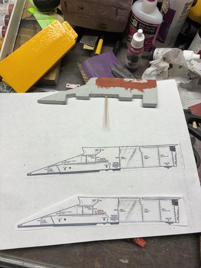

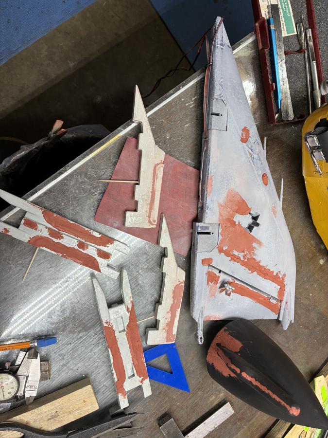

          Looking on the web, I found information on the inboard pylons. Lots of diagrams both for the Navy and Air Force pylons and missiles. I enlarged the pylon to match the FW phantom and will add the panel lines, ect. before painting. The FW pylons are kinda semi-scale but I think using the TAR method they will look ok.
          I sprayed a thin 2nd primer coat and now back to fixing bobbles and sanding, again. Ugh
          Also foud a picture of the F4B&C turkey feathers
          PS Please dismiss my cluttered bench, started out clean 5x10' table and now working in a 1' square area. Anyone else have this problem?
          Best Regards, Rex

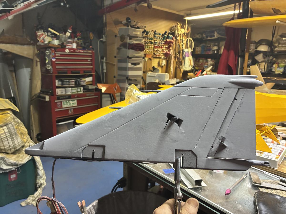

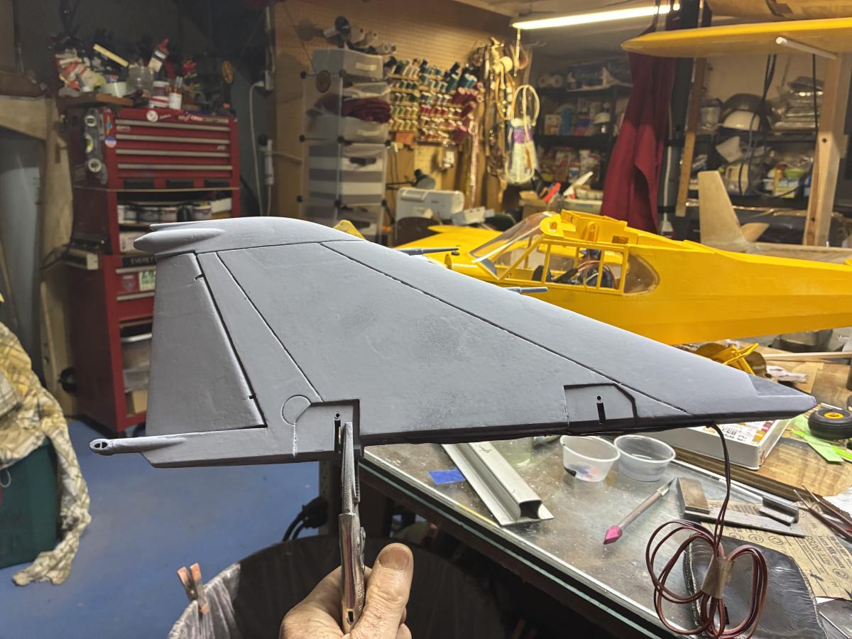

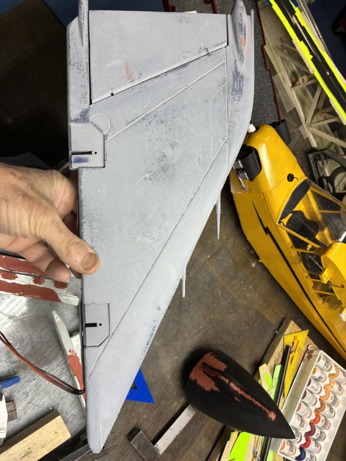

              Moving on with the Phantom I sanded the second coat of primer, one side looks great, the other side will take some filling to feather in around the protruding servo, checking my 3-view found that some manuf. lines on the left side needed to be filled. Pylons getting filler on manfu. seams also. Slow but moving along.
              Best Regards, Rex
