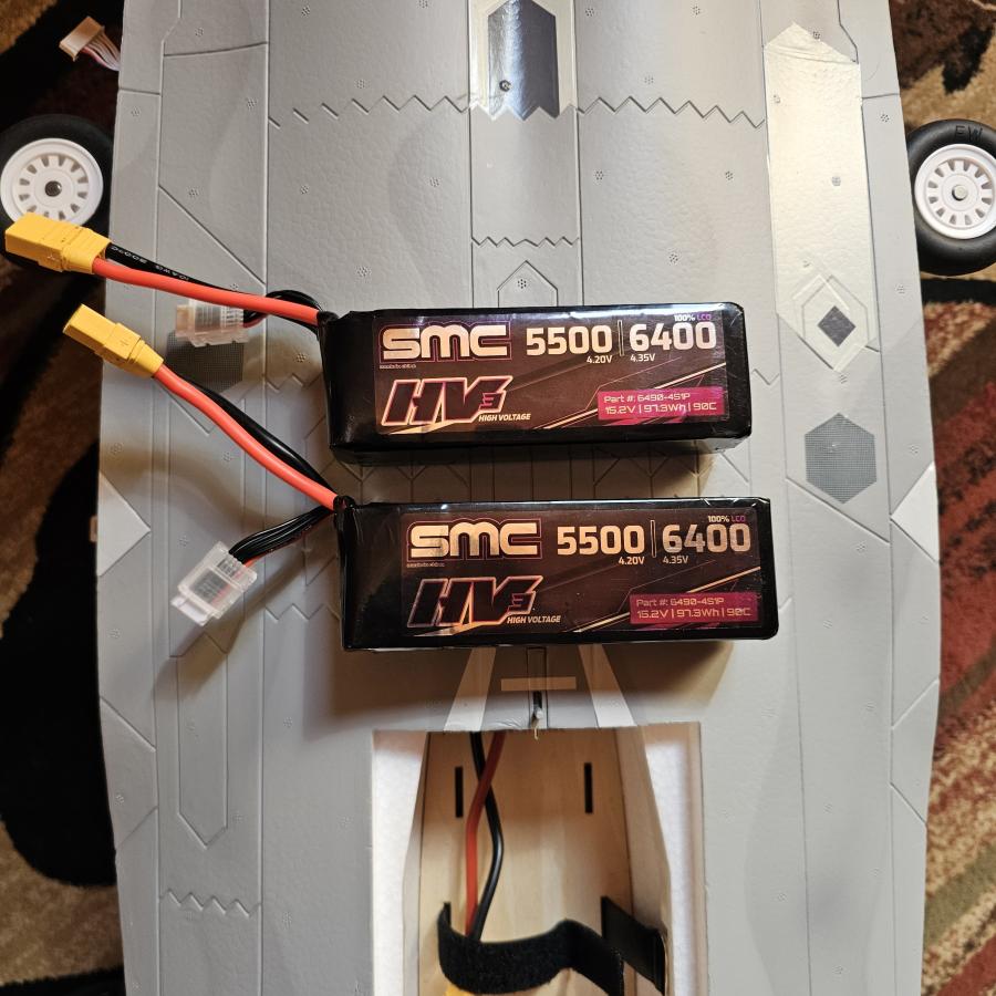

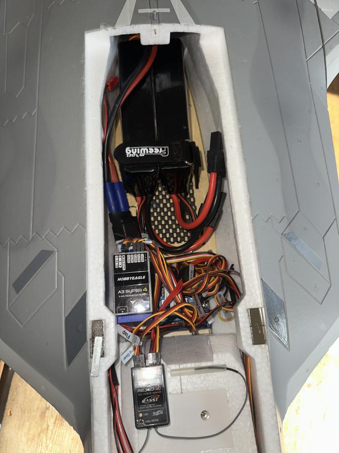

          I have the V2 8S version and am using two 4S older HV SMC 5300 packs (510g each). Came out a little nose heavy with the packs pushed back with the front of the packs right at the Velcro hold down (see pics). Maiden and subsequent flights were fine with literally no trim needed. These packs are lighter than the MotionRC packs recommended and I just surprised the packs wouldn't be centered under the Velcro for the factory CG. Not an issue, but I was thinking of using larger mAh packs in the future and really don't want to add tail weight. Thoughts.
          Thanks
          Nick

            I'm using GNB 5300mAh HV packs in 6+2. Weights are 590g + 210g. Awesome batteries, I have 15 of the 6S and 10 of the 2S. I use these in all my 70mm to 90mm EDFs and most prop planes I have. Super hard to find and GNB recently took them off their website, not sure why.
            Much more punch than the SMC HV I had.

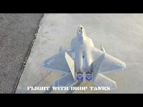

                    Some highlights of my flights this morning

                      Nice video it's really pitch sensitive on landing with Flaps deployed.

                        I noticed that, too. Mine doesn't do that. Must be something in the way it's set up.
                        • #52
                          Hoping it's just not enough down elevator mix when flaps deployed.
                          checking Expo wouldn't hurt either.
                          CG is stock.

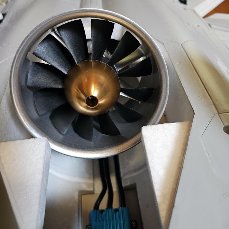

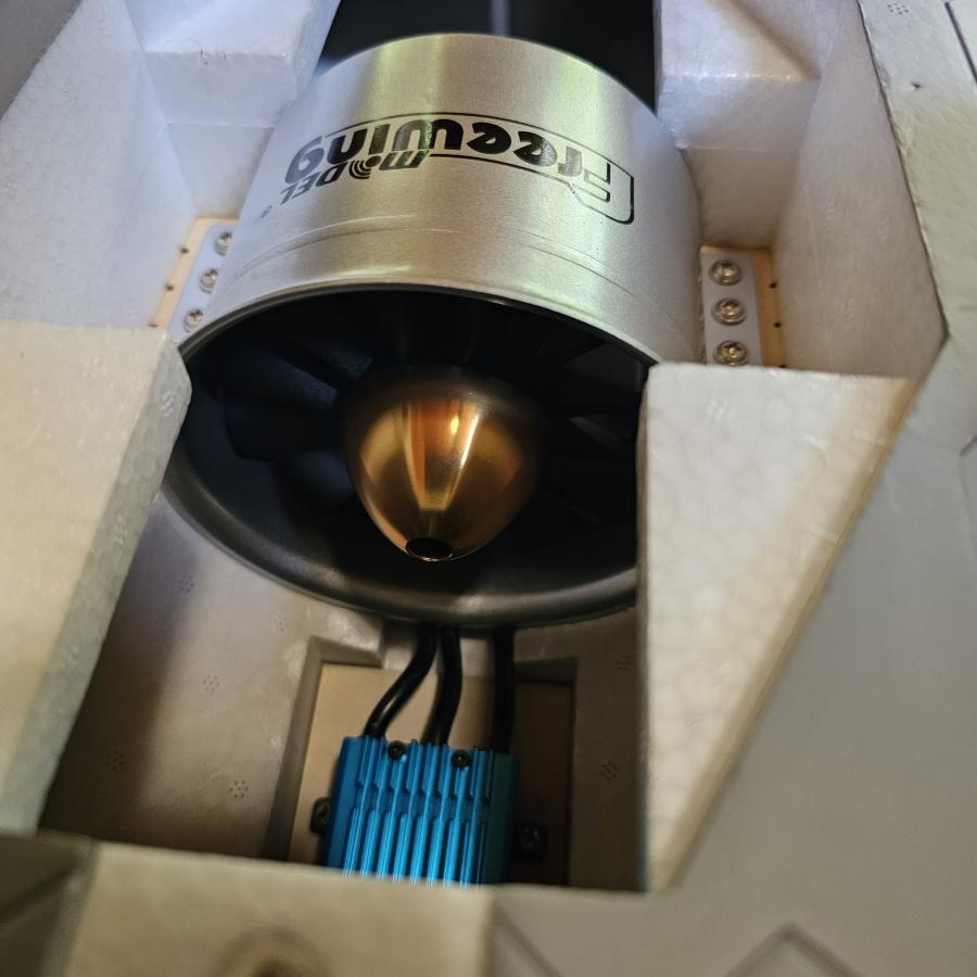

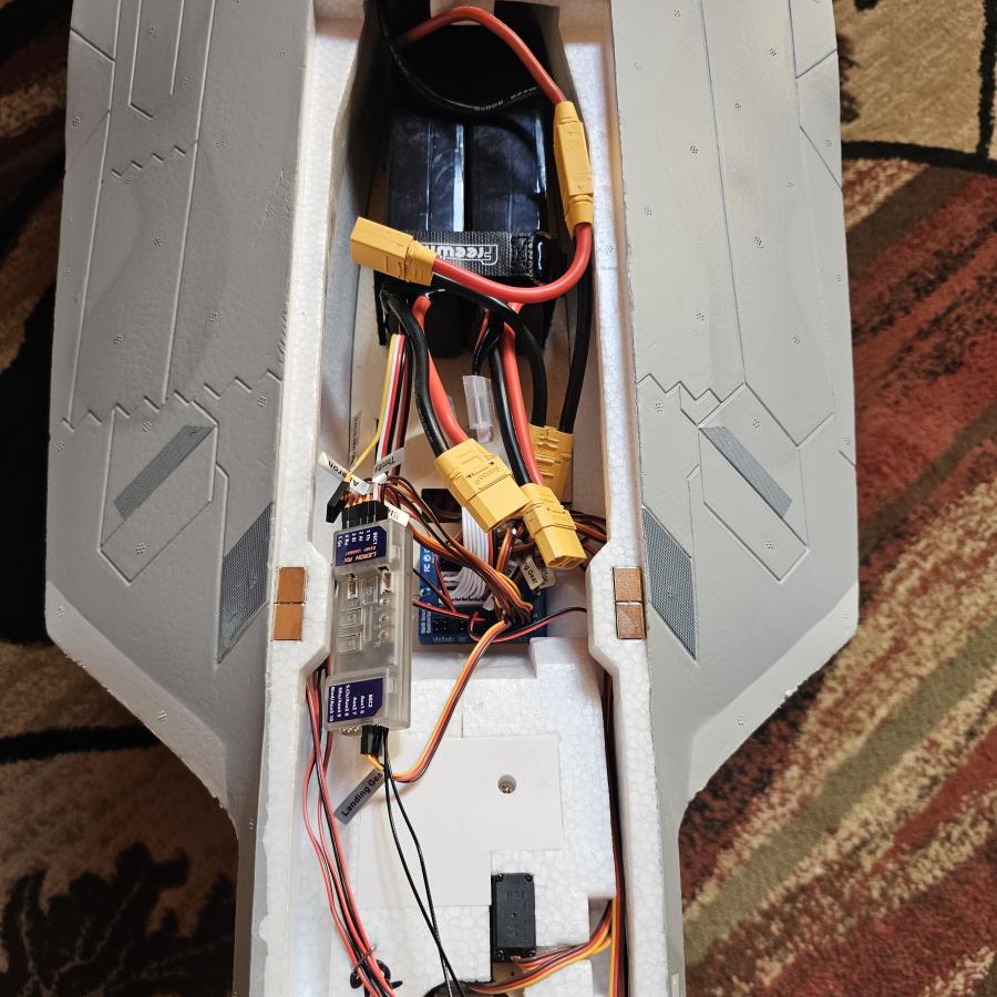

                            I took the the 8s Fan out with Speed control to rewire for XT90 connectors. This allowed me to put my test equipment on the Motor.
                            Power with the LHIV charged to 4.35 volts per cell pulled a static Load of 122 amps. To say she had some thrust is an understatement.
                            Still have a few more things to program in my Radio Master TX16s hopefully by next week I will have her all finished.
                            I'm not a foam airplane guy I see loads of people clear coating them with MinWax water proof poly is it worth the extra step?
