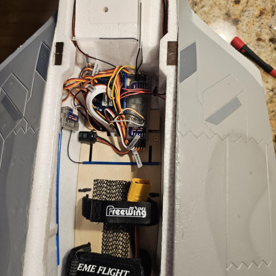

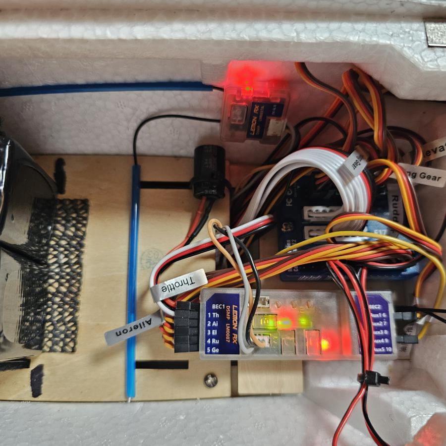

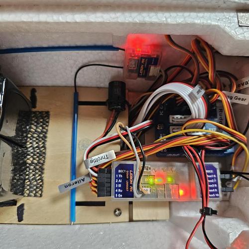

    Worked on the 90mm and added a lemon Satellite receiver gen 2 as well as a small Capacitor. Minimal amount of weight. I'm not a fan of the stock Aileron throw or Elevator ended up flying on 100% all control surfaces.

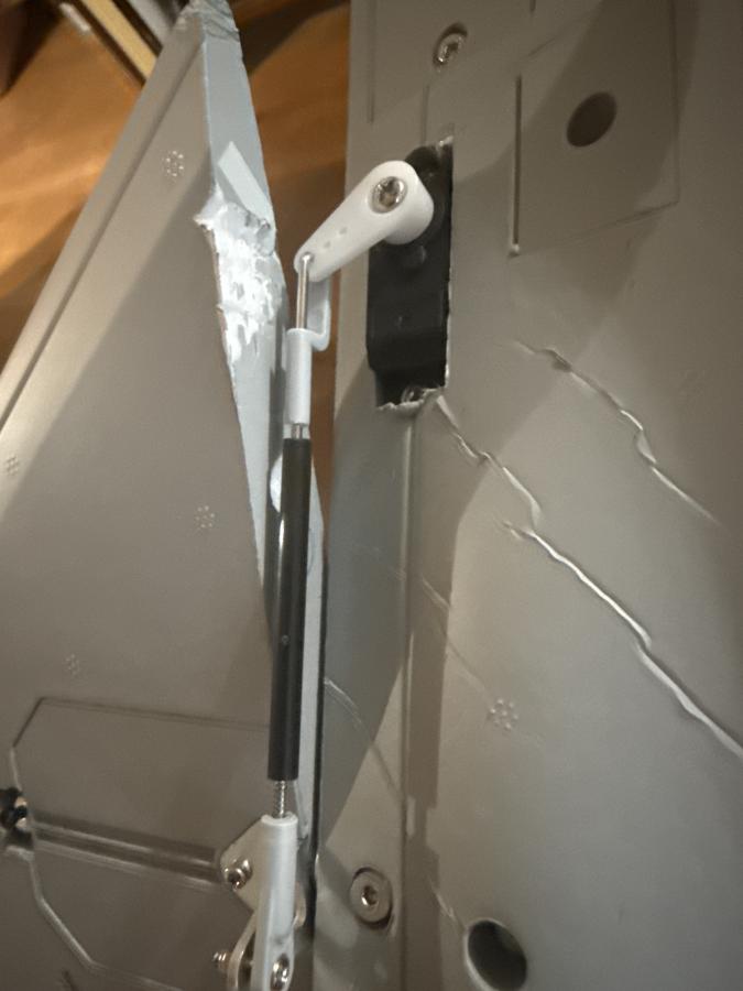

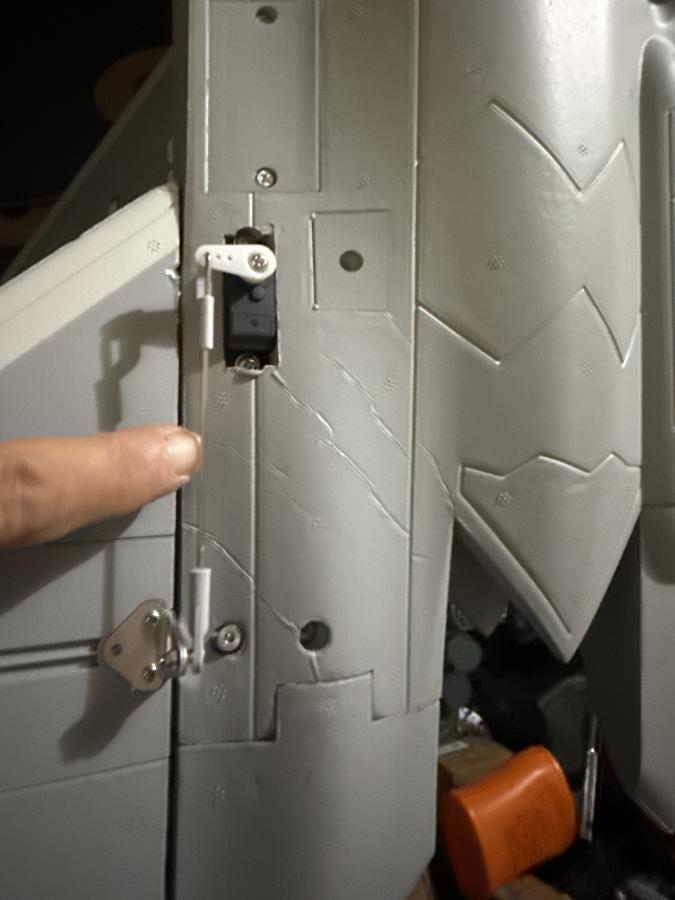

              Had a small issue on my V2 Raptor last Sunday, of course being 10s she’s a bit faster than even 8s. It was pretty windy good 15mph winds higher gusts but on a full power low pass I noticed the right elevator shaking itself to death. Slowed my speed and it went away, landed zero issues however after inspection I found the elevator rod had bent so violently it actually damaged the elevator and wrinkled the foam on that side of the fuselage. Been a little busy with my 1/8 RedTails F16 turbine but am planning on adding carbon tube support on the elevators. Just seeing if anyone else has had the same or similar issue, the V1 even on 10s clocked at 170mph never had this happen. Here’s a pic of the slight damage

                Did you have a Gyro running on the Stabs at the time of the incident?

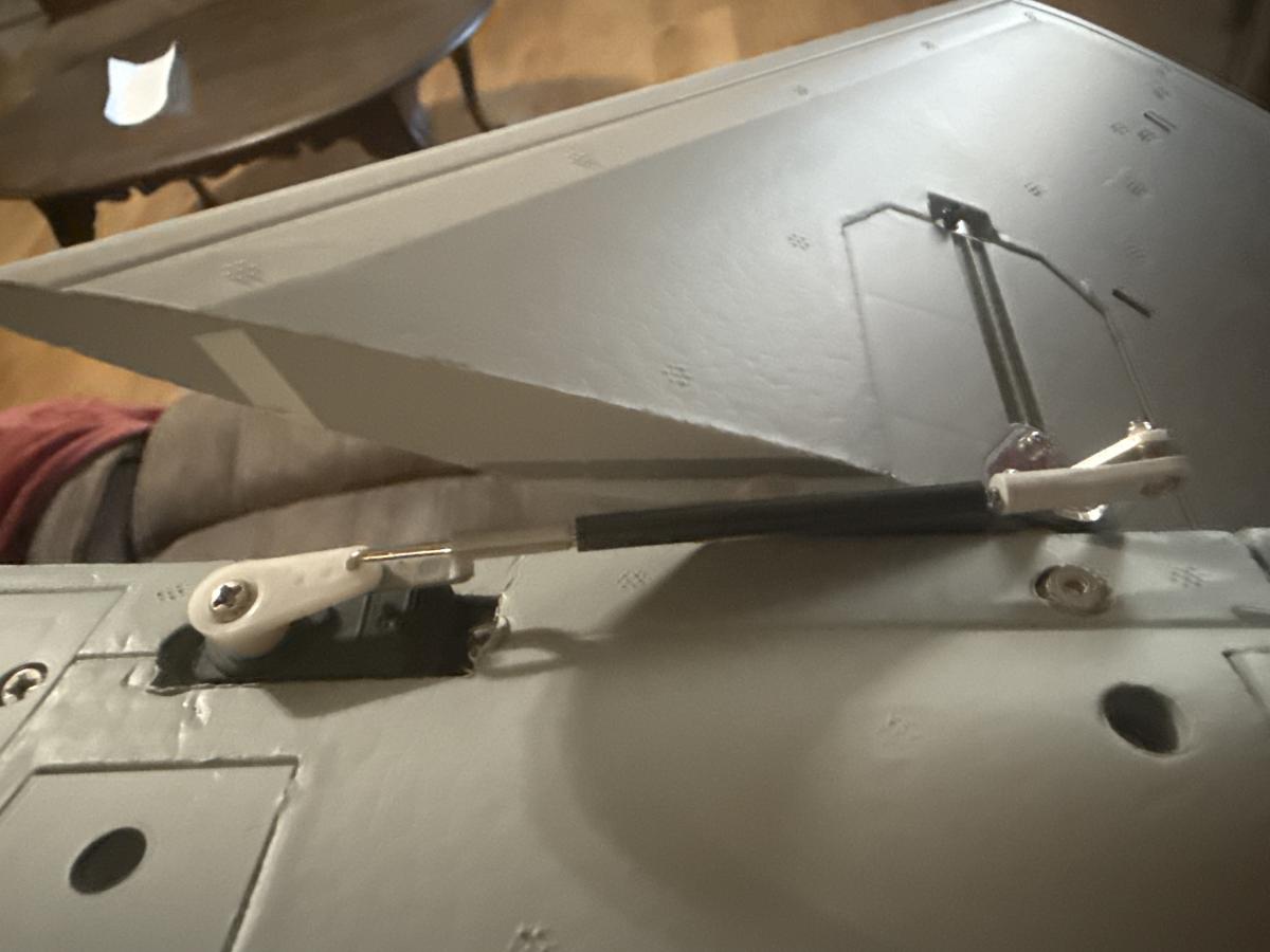

                  Yes I did, update added carbon sleeves around the elevator rods. Flew last Sunday in 10-15 winds everything feels so much better, took care off the slight oscillation it had compared to my V1 that was just rock solid

                        I have ran my F22 90mm V2 up to 150mph no Gyro no flutter of any kind the stock metal rods handle it with no issues.
                        I'm running the stock Servo arm location #2 I noted Shortround91 is running Hole 1​

                          for 6s I don’t believe you will need to just the extra speed I gained from going. 6-8 to finally 10s put a lot more force on the elevators especially with my throws. If your Spektrum for AS3X+ I did have to lower gains to almost nothing for the oscillation, I am running tailerons though. Probably won’t be an issue going standard. I got 5 flights in on her yesterday super rock solid after doing the carbon and of course I make a carbon fiber plate for the nose gear taking pressure off the bracket.

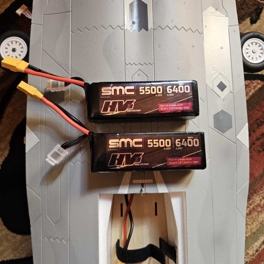

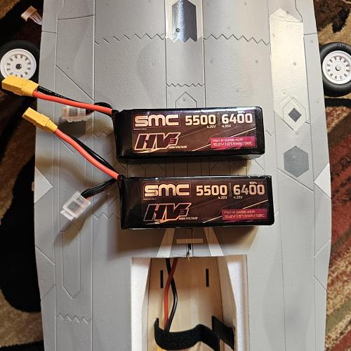

                                        I fly my 8s with 2 of these charged to 4.35 with no issues.

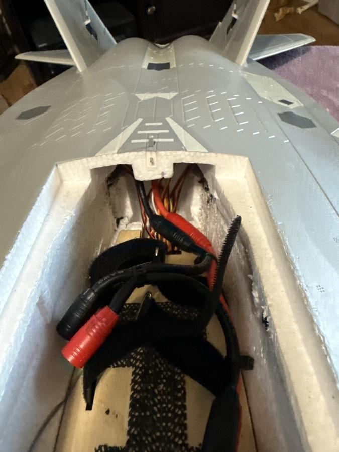

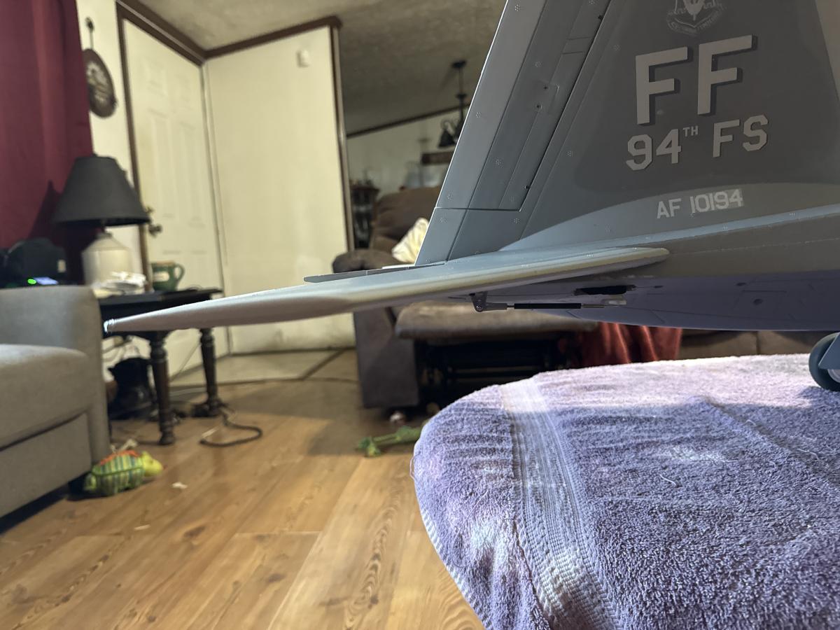

                                          #100
                                          I had to modify my battery area to get CG where I like actually carved to the plastic intake inserts in the fuse. Far as my elevators here’s a pic hope it helps. Again I’m 10s with a tail based CG
