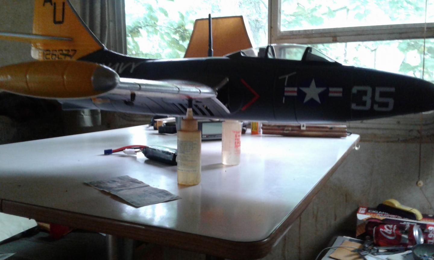

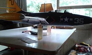

                            Click image for larger version  Name:	20170706_172037.jpg Views:	2 Size:	107.7 KB ID:	85863 Received mine in great shape. The build went well. Haven't maiden yet. I also read a ton of reviews concerning c.g.
                            I have admiral 3s 2200. Can't push battery to far forward under magnets without cutting the tray. When i set her up to check cg she's pretty much spot on.
                            Also I upgraded to an 40amp es
