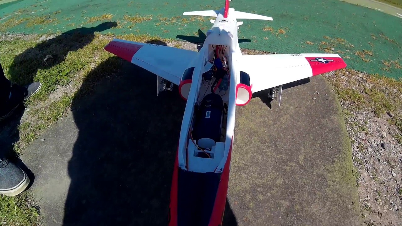

    ok guys here is the video of the T-45 with my modded set up. the specs are a 4082 1600kv Leopard motor with an Inrunner Freewing Fan. Stock esc with a 6s 60c 5000mah pack. I found out later that the pack was brand new and he had not broken it in. So it could have been better. This motor set up is significantly heavier than stock but it moved the plane pretty good! Also the CG may have been a tad further back than before. We only got one flight with it. He changed it back to stock since it didn't really suit his flying style. I am sure that I could get it t work out pretty well with some extra fine tuning! Take a look...
