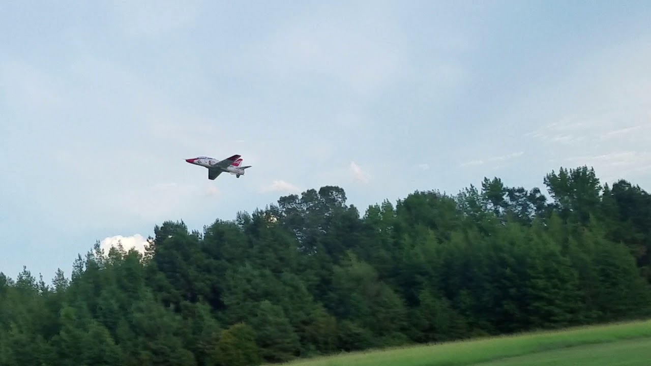

    Yeah our grass had not been cut in 4 days. Plus it was probably our hottest day so far, and muggy. So takeoff performance was marginal.
    With a fresh cut, she will launch in about 125ft. This video shows a typical takeoff on our field. I used about 150 ft. But the grass was high.
    And yes, bone stock.
    I may try that 4068-1680 in the future. Do you think it would help me get off the grass quicker?
    Here is the maiden.

    Looks great and nice flight, had me worried though if you were going to make it in time on that take off.:Scared:
    Just got mine back together after a mishap with a fence, maiden this weekend I hope. Also is yours all stock? I know you said you like the sound but if you decide to upgrade, try the FW 4068-1680kv, the sound is even better than stock and very smooth too, I took the 1680kv out after I crashed mine, used it in a Yak 130 so now that I have it back together I put a 9 blade power plant from the F-4, just for fun I wanted to see how it performs in the T-45 then I will switch back to the 1680kv.

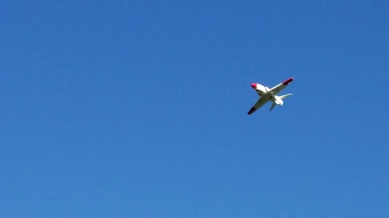

    Maidened the new T-45 this evening. Got 4 flights on her.
    On flights 1 and 2, I had an issue with the gear not fully retracting. As it turned out, I had plugged the esc power lead into an unused elevator channel on the board. My thinking was that the board would distribute the power rather than the RX.
    So I plugged that esc power into an unused channel on the RX (X8R receiver, RSSI port) and all went back to normal. Lesson learned.
    I flew her with default low timing. I hit the pattern at 2 minutes and rolled up to the bench by 3 minutes. Batteries were all at 3.85/cell.
    I cannot say how much I love this jet. It's a truly great model. And you cannot beat the sound.
    Flight 3 of 4
    First flight of the day where all the gear tucked up nicely. (at 0:33 the words are "all tucked up". I know it sounded like something else...but it wasn't)
