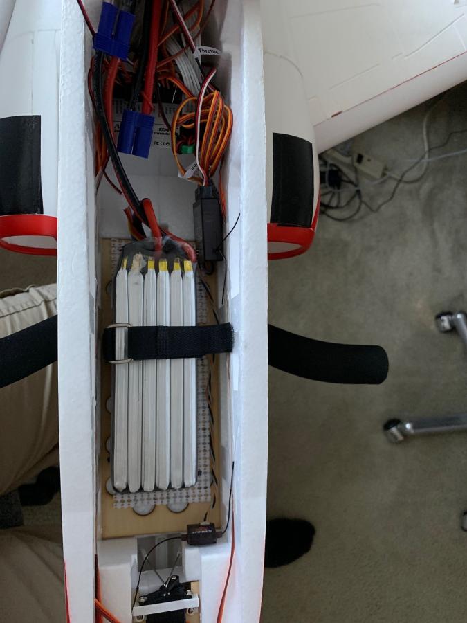

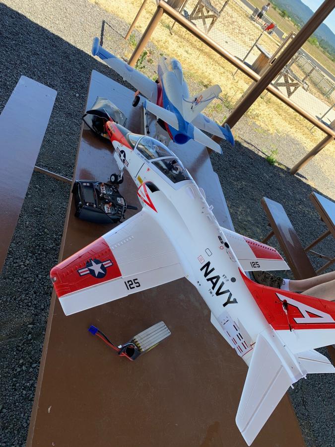

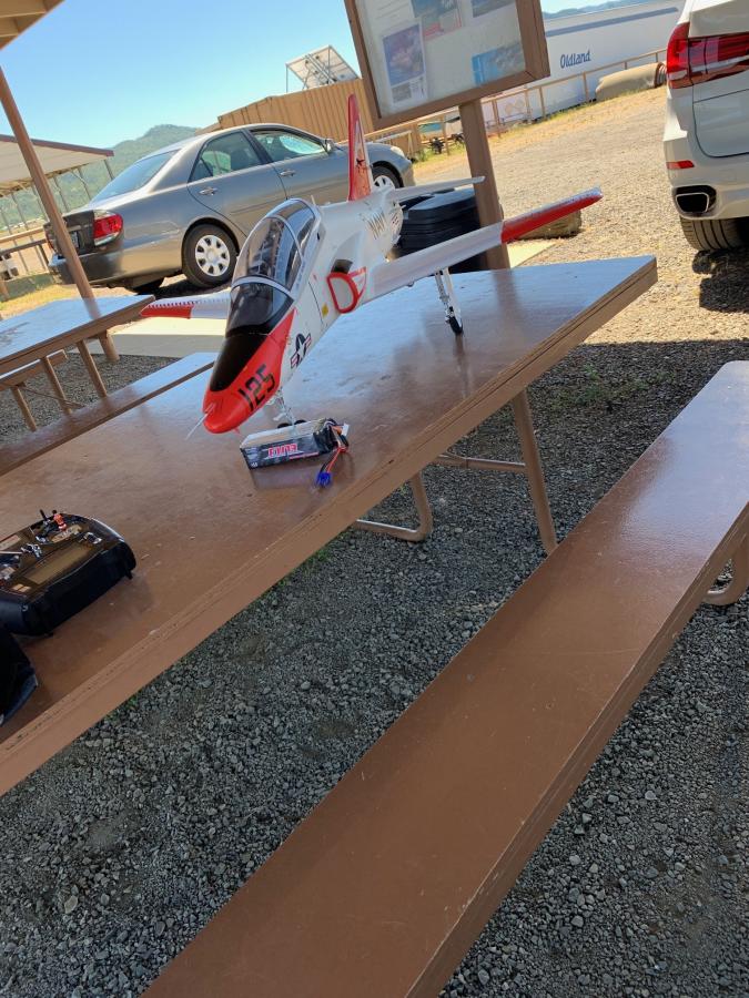

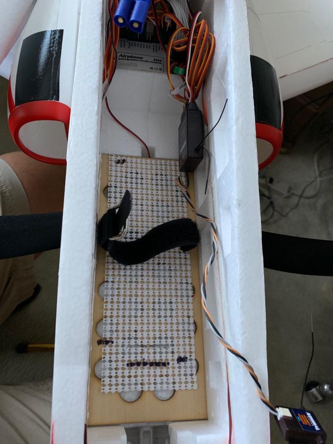

    Hi Guys,
    I finally had a chance to maiden my T45 today and flew my L49 first to get my nerves settled down. For some reason I was a little afraid of this jet. Maybe its the wing loading or all the stuff that can go wrong with this one?
    Out on the runway after preflight checks and put everything on low rates with no flaps... all good. Anyway I took off and while climbing out retracted the landing gear right away. Full throttle climb and then started to bank to the right for left downwind pass. Just when I started turning and giving some up elevator the plane darted to the left, which I countered very quickly back to the right. For those pilots watching it was more like a wiggle back and forth .. This scared me that something was wrong and decided to put the landing gear back down and get this jet back on the ground. ""It almost acted like the plane was tail heavy??""" It seemed to be unstable when turning while using any elevator. So I managed to get the plane heading back on a poor final approach putting the landing flaps down this plane really slowed down! I had to come back on the power several times to keep the speed up. When pretty close to the ground the plane turned left knife edge just off the deck before landing. My reflex action to the right just saved it from a total ugly crash. I can say this plane took off great and didn't require any trims. So, I really need to hear some feedback on possible mistakes or any ideas at all. I will be inspecting everything again such as servo testing controls etc. I had the CG balance by the book (I think). Please look at the battery position photos attached.
    I know this plane has been around for several years now any Help would be greatly apricated :)
    My fellow pilot RCAV8R was there for support Thanks Rob
    Rich

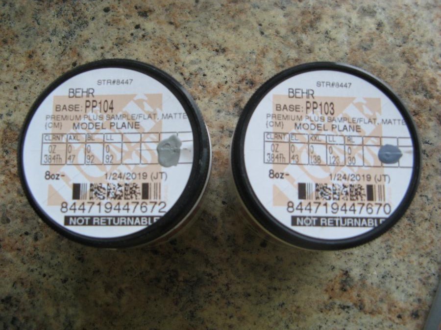

    Originally posted by edwarda10pilot
    Hello all:
    I just picked up one of these T-45's from a fellow club member. The plane has been thru a few different owners and is in need of some work. I need to touch up some of the orange/red paint. Has anyone had to do some touch up and if so what brand and what color of paint did you use?
    Thanks,
    Ed
    Hi
    Just go to Lowes home improvement and have them color match the Red and White. take the vertical stab into the store for a sample of the color. Pretty easy and cheap. $4 each color
    Rich
