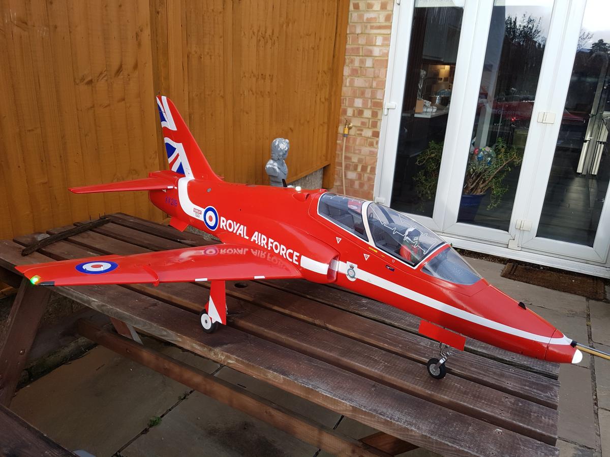

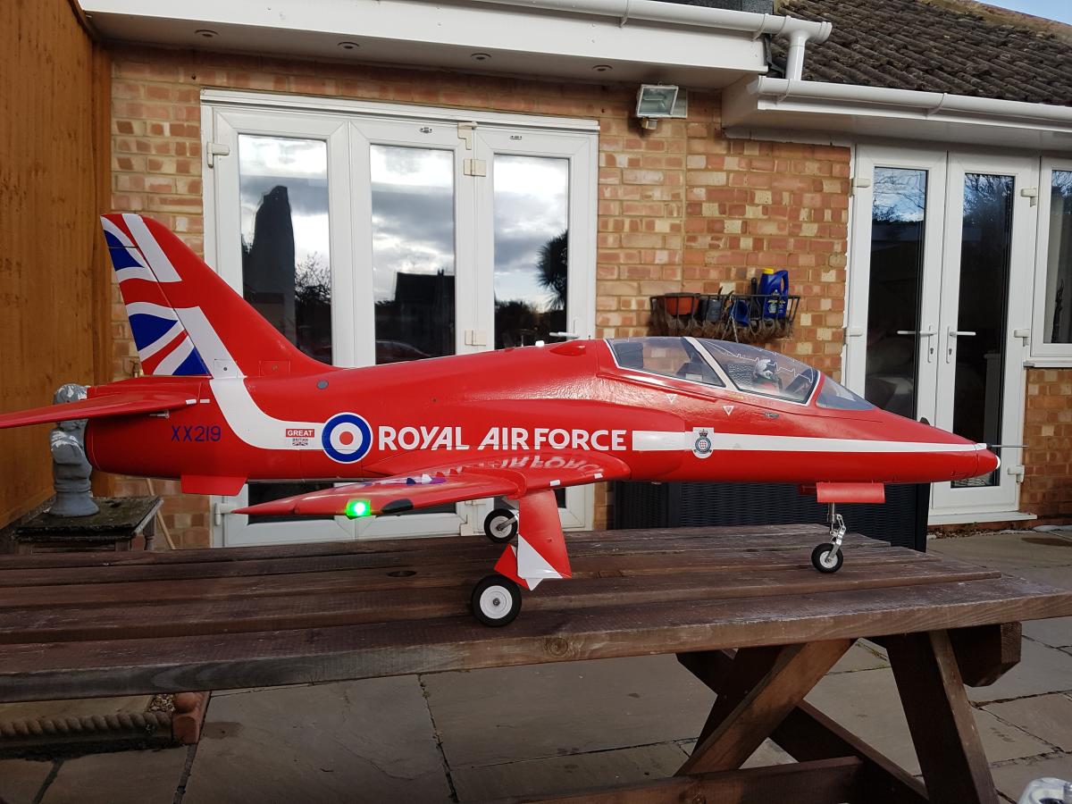

    Thank-you, it has been flown, despite 4.2kg AUW, it is quick and stays up for quite a bit longer than it ever did as the T45. I loved the stock plane, nothing looks quite as good on landing approach.
  • Coconut
    Great work, Alphonso. Amazing.
  • Alphonso

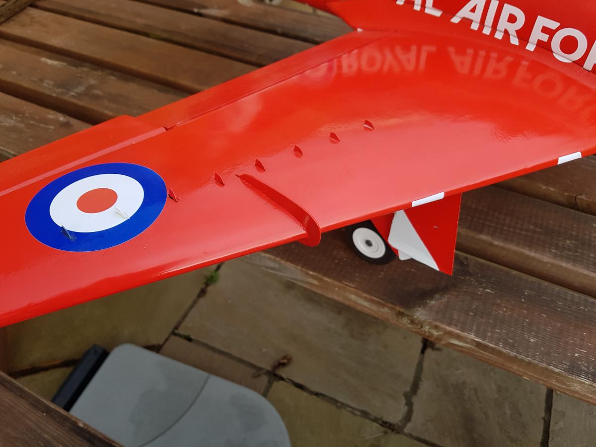

    This is my old V1 T45, I started this back in 2016, gradually doing a bit more until I recently finished it. It was originally going to just be a repaint for my old eyes, but it got more and more scale as time went on.
    it is now glassed with 25g cloth and Jepe Jets EPO fast foam system, stock landing light moved to the nose cone, glassed balsa control surfaces, wing fences, vortex generators and ventral fins all fabricated. Airbrakes are removed and the humps in the exhaust cut out.
    It's powered by a Schubeler DS51 HET 700 68 1400 on 10S.

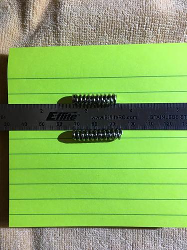

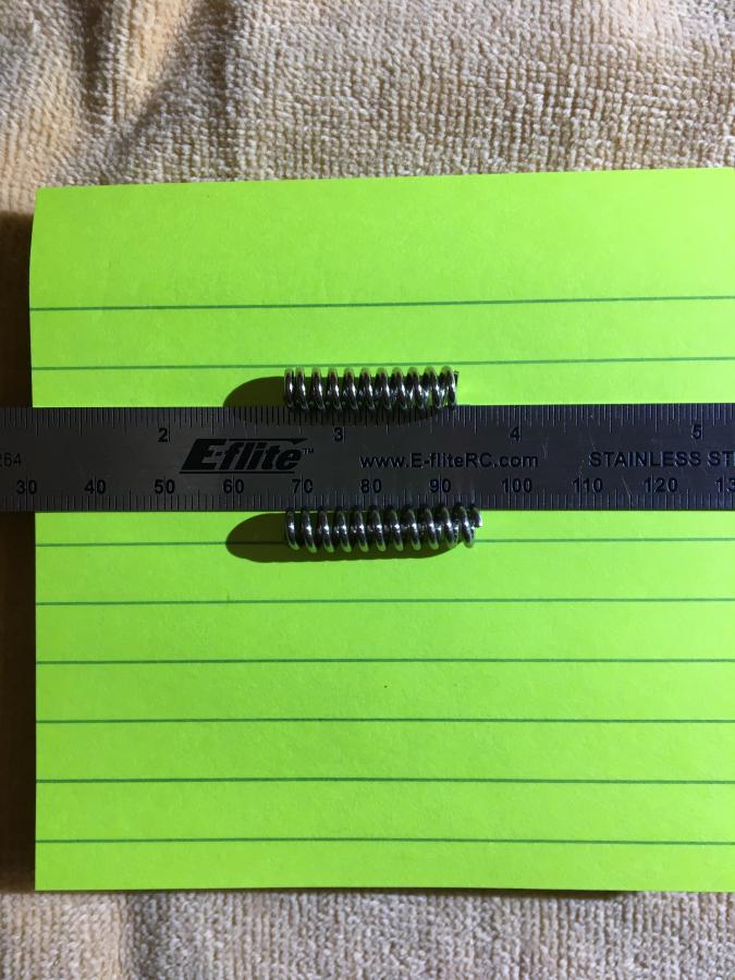

  • gentile
ID:	376792 Here’s a heads up on the T-45 V2 I just built. With a battery installed, the left main strut barely moved under the weight of the jet. The right main strut compressed quite a bit. The difference caused the jet to sit crooked and the left side strut felt very stiff. After working with Motion on this (good experience) and reviewing videos and on-line reviews, I believed the very stiff strut to be the problem. What I found was the springs in the struts were different lengths with the stiff strut spring being much longer. With parts Motion sent, my springs now match and the jet is level. There’s also plenty of travel left to absorb the landing. Just fyi.

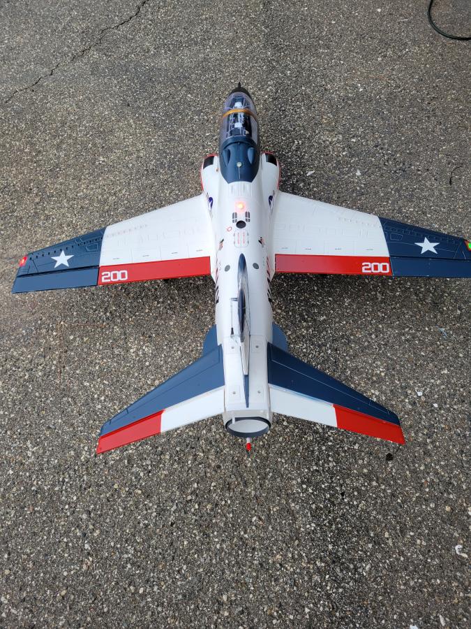

  • yf22raptor
    The nose navy blue wraps around underneath and the main wings paint the same on the underneath everything else stayed white .
  • BadClams
    How did you paint the underside?
  • yf22raptor
    Just finished my repaint ..gonna maiden thise week ..love the detail on this jet
