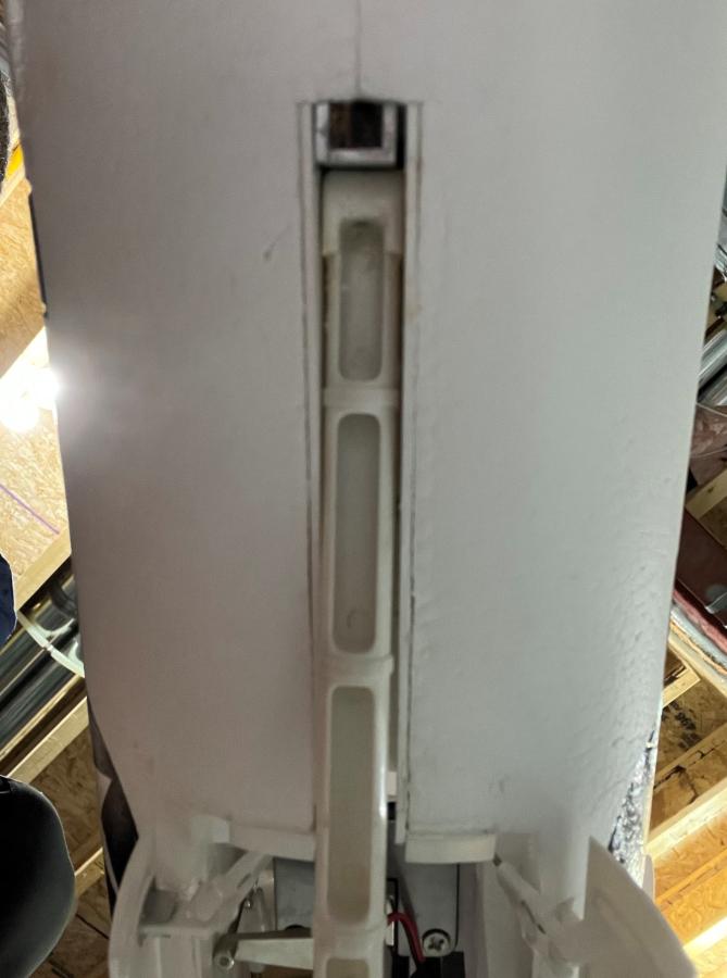

  • themudduck
    MotionRC can you answer please... Regarding the new V2 that doesn't have the slat system - can I purchase a set of replacement wings without slats? The $72 wing set listed under spare parts appears to have slats. Perhaps the pic is wrong?
    And I am wondering if the new wing without slats was re-engineered or strengthened at all - the LE of the wing had very little structure in front of the LG (because the slat system was there).
