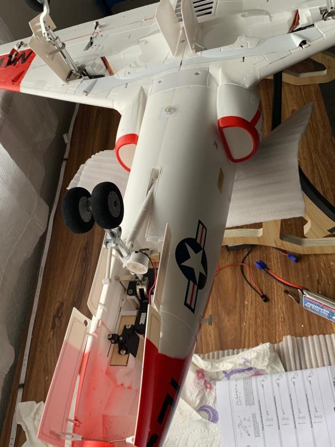

  • RichJ53
    Originally posted by EDFURCHE
    Fred, you must have a freewing t45.... I am building a 2nd one from parts... where do the servos mount for the nose gear doors. 2nd question... do the 2 ply squares that hold the wing servo connections mount somewhere or just float...
    thanks for the solution of the trailing support rod on front gear...

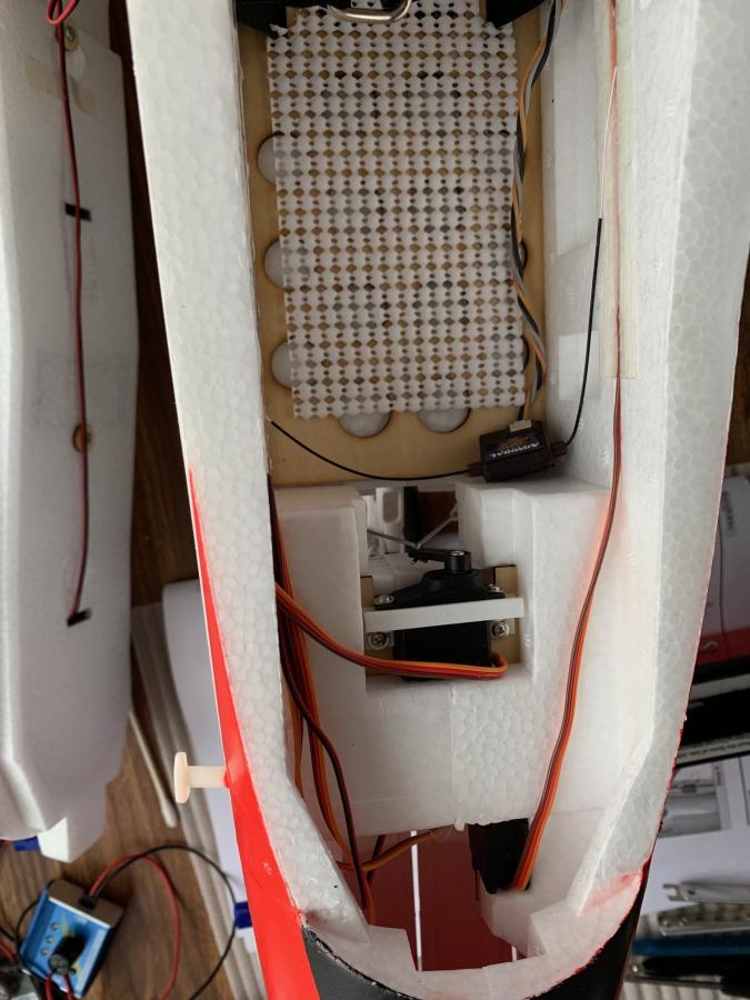

    I found some photos of my T45 gear. I hope this helps you

  • EDFURCHE
    In answer to my post about the retract install, I figured out that you keep the one in the retract and remove the one from the gear!!
