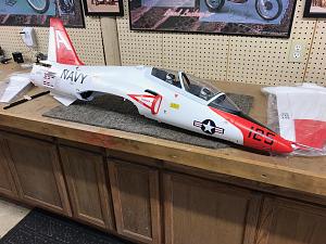

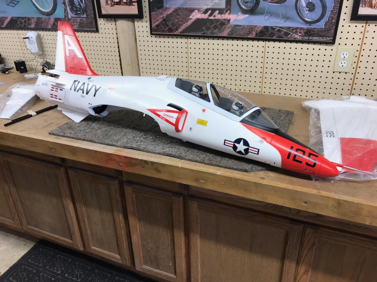

ID:	146993 Here's what the UPS man brought today! Very impressive model. Project Foil will no doubt be announced sometime in the next 48 to 72 hours.

                                      I'm telling you Friday LOLI'm sure of it!
