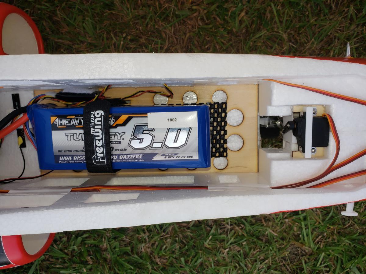

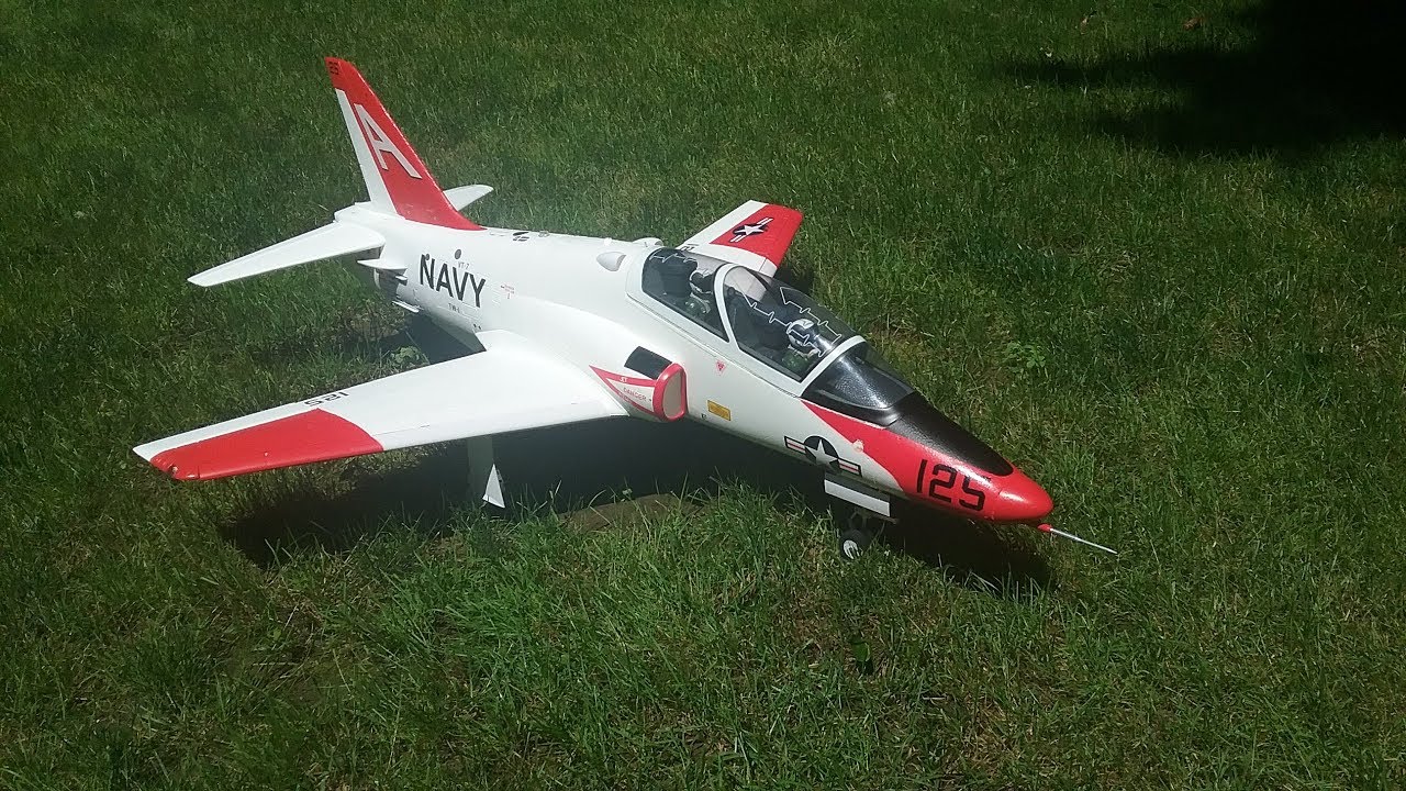

                                        Put 4 flights on the T-45 yesterday. She has PLENTY of power in the V-2 configuration. I was flying a year old Turnigy HD 5000 pack and still no problems.
ID:	203544Click image for larger version
                                        My settings
                                        Throws by the book except ailerons 85% travel, 40% exp....elevator full travel, 40% expo....rudder 70% expo
                                        Battery Turnigy Heavy Duty 5000 mAH from 2018 with LOTS of flights on it. XT-90 connectors
                                        Takeoff... slats, half flaps
                                        Landing... slats, full flaps
                                        Get in the throttle in slow turns.
                                        Speed brakes (not air brakes....which are on diesel trucks and the like) actually do help in the approach. BUT, the little servos driving them will get overloaded and won't retract afterwards. So I recommend the speed brakes be left alone.
                                        CG set by the "finger on the screw" method. Fine tuned by a couple of test flights. In a slow turn she should stay level and not drop the tail or nose.
